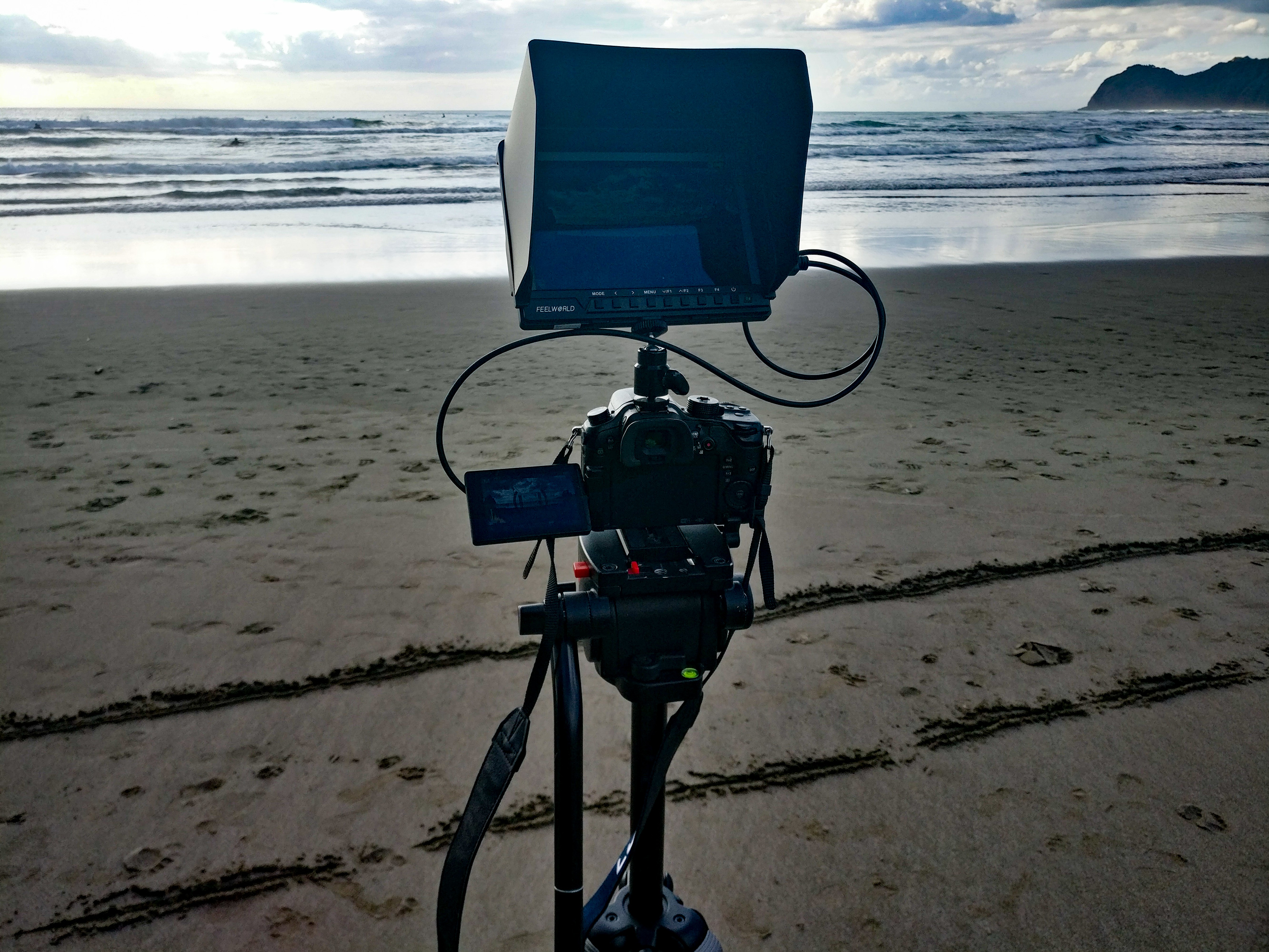

Orangenz Posted February 8, 2017 Share Posted February 8, 2017 On 02/02/2017 at 7:06 AM, kattouf said: I posted above. fw 1.66. I have the Sharpness setting being reset issue. Zebra setting works but it is reversed. I have to set it to 10IRE for it to work like 90IRE . It's odd. I wanted to ask you about the battery charger. Does the LED turn green when it finishes charging? I left mine for 2 hours and it was still red but battery was 100% charged. The LED on the monitor? Red is power off, green is power on. My firmware is 4K V1.63 Lag about 1/3 of a second - quite manageable. 4K output from GH4 gives best image results. Very light weight. Getting an adaptor to move the battery beneath the camera probably an idea. For US$121 it's pretty amazing. Link to comment Share on other sites More sharing options...

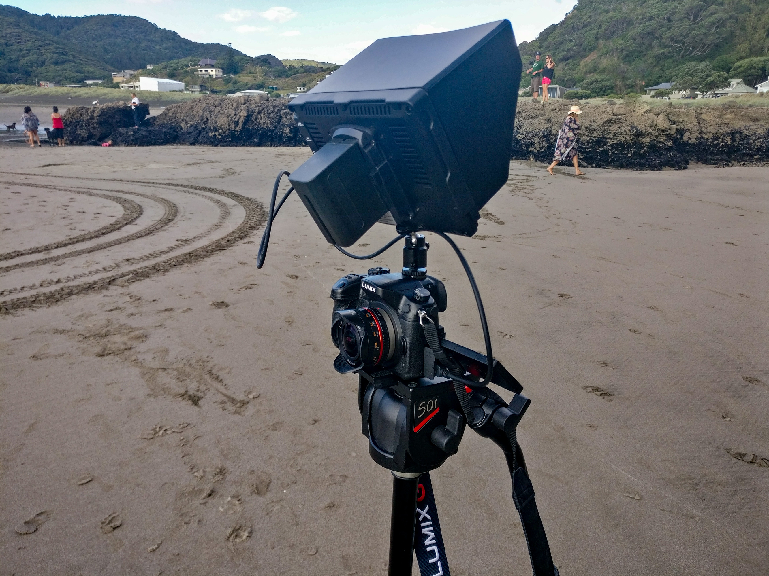

Orangenz Posted February 9, 2017 Share Posted February 9, 2017 Just need to run a separate power lead so I don't have to hang the battery off the back like that. This runs great. Off Aliexp, "wolfgang fw760", with v1.63 firmware. Link to comment Share on other sites More sharing options...
