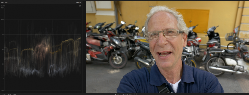

Vesku Posted April 14, 2017 Share Posted April 14, 2017 2 hours ago, jonpais said: Hi Vesku, when we say ETTR, we're not talking about anything extreme; there should still be pixels in the deepest shadow areas. I thought ETTR is the brightest exposure before important highlights are clipping. I ment earlier that when we have the widest aperture and longest shutter speed in low light we have only iso to work with. I dont want to rise iso for ETTR then. I use normally f 3.5 kit lens so I must think this quite often indoors. Link to comment Share on other sites More sharing options...

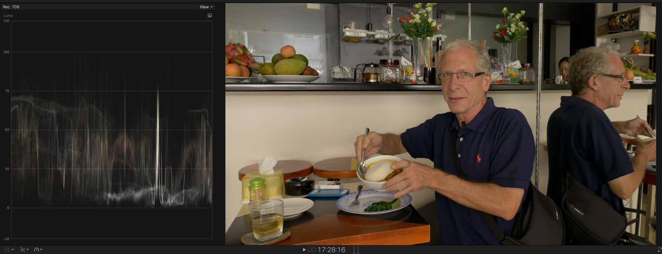

jonpais Posted April 14, 2017 Share Posted April 14, 2017 50 minutes ago, Vesku said: I thought ETTR is the brightest exposure before important highlights are clipping. I ment earlier that when we have the widest aperture and longest shutter speed in low light we have only iso to work with. I dont want to rise iso for ETTR then. I use normally f 3.5 kit lens so I must think this quite often indoors. In the waveform monitor above, the highlights are just touching 100 IRE. This clip was shot at f/2 or f/2.8. Link to comment Share on other sites More sharing options...
Vesku Posted April 14, 2017 Share Posted April 14, 2017 5 minutes ago, jonpais said: In the waveform monitor above, the highlights are just touching 100 IRE. Those are little dots of specular shines. The actual whites (plate, wall) are not very white. This does not look like ETTR for me but it looks OK. I would expose like this. Link to comment Share on other sites More sharing options...
jonpais Posted April 14, 2017 Share Posted April 14, 2017 1 minute ago, Vesku said: Those are little dots of specular shines. The actual whites (plate, wall) are not very white. This does not look like ETTR for me but it looks OK. I would expose like this. You don't want to lift exposure until there are no more pixels in the shadows. Here's an example of an image that has been slightly overexposed. In your EVF or LCD, the left end of the histogram should still be touching the farthest shadow area. Link to comment Share on other sites More sharing options...
Vesku Posted April 14, 2017 Share Posted April 14, 2017 25 minutes ago, jonpais said: You don't want to lift exposure until there are no more pixels in the shadows. Here's an example of an image that has been slightly overexposed. In your EVF or LCD, the left end of the histogram should still be touching the farthest shadow area. In very low contrast scene there is no black or white. It is not always necessary to have black pixels for example in a foggy day. I dont usually judge exposure watching black level. In my GH4 there are shades in black even when the histogram shows crushed blacks. Maybe the GH5 waveform is more accurate. But about the topic. Is there any consensus if the GH5 NR is good enough? I use always NR -5 with my GH4. Link to comment Share on other sites More sharing options...
