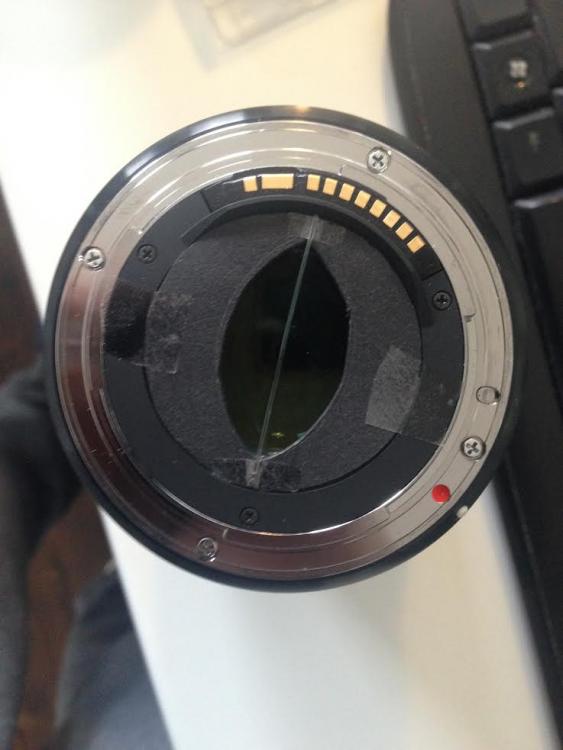

funkyou86 Posted February 20, 2017 Share Posted February 20, 2017 On 2/20/2017 at 4:01 PM, Stab said: I came across this little filter which supposedly provide an anomorphic-like bokeh and lensflare on virtually any lens. You screw the filter on the back of your lens and you're good to go. I would like to try one, but since I'm always using a Speed Booster I have my concerns. Their website says that 'some people' have no problem using this filter with the Sigma 18-35 f1.8 and the Speed Booster, but other's might. Well, that's a bit vague so I thought let me ask it here. Have any of you ever used this filter with a Speedbooster and even with a Sigma 18-35 Nikon mount? I plan to use the Cinemorph filter on a GH5 with a Sigma 18-35 (Nikon) and a Speed Booster XL. If you've ever seen or used one, let me know! Thanks. Expand I made one from black cardboard and used a fishing line. Obviously, the oval shape could be nicer, but at least I know that this anafake does not worth 50 bucks. You get the fishing line in your bokeh, the lights will be clearly divided in to two and the "waterfall bokeh" will have a fishing line like horizontal line. You can get rid of this by using a thiner line, but it will kill the flares. Check the cinemorphs characteristics, it's the same, anyway, the cardboard will definatelywork with your speedbooster Parker and andrgl 2 Link to comment Share on other sites More sharing options...

funkyou86 Posted February 20, 2017 Share Posted February 20, 2017 Here are some screen grabs. I did not bother to cut it to cinemascope, you get the feel. Note the bokeh on the last picture. All shot with Sigma 18-35, Lens Turbo 0,72x and GH4. I tried to cut a vertical line in to the front filter but it did not work as expected, than I tried to sandpaper it, but it was visible on this short focal length. I thought that faking anamorphic will be easier, but it is not andrgl 1 Link to comment Share on other sites More sharing options...
