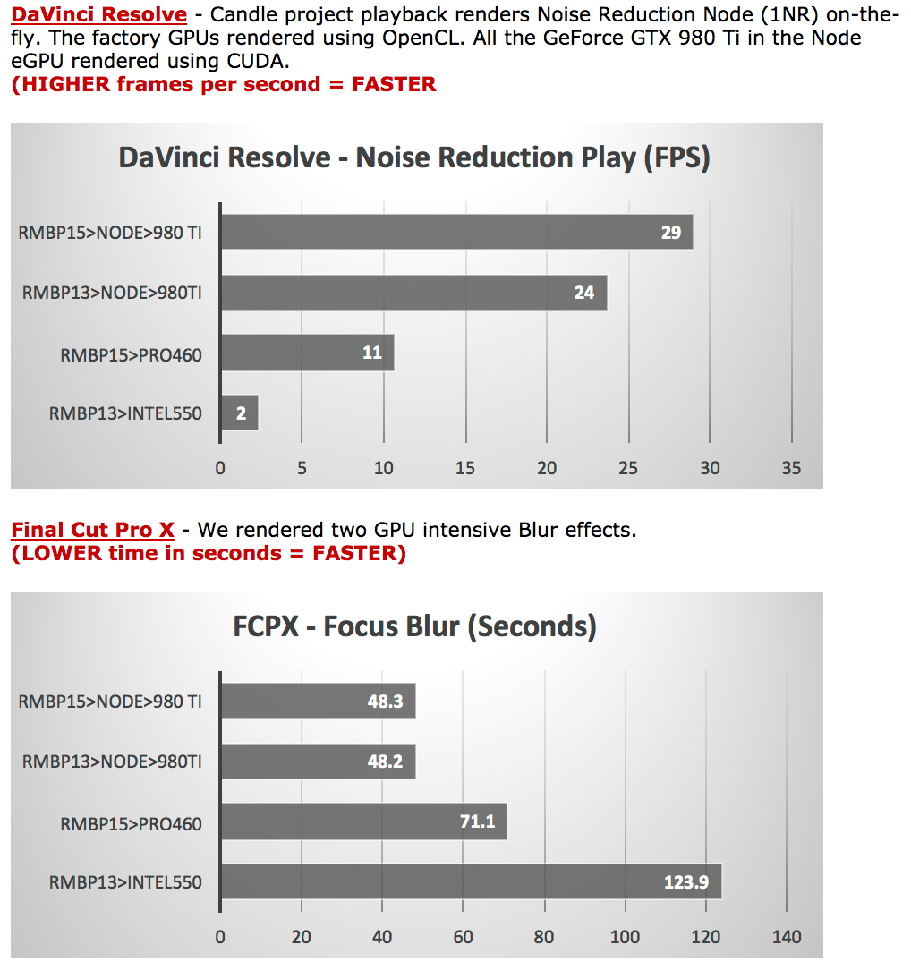

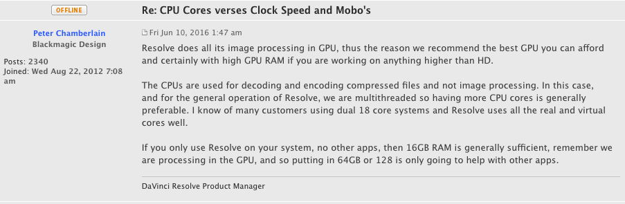

Don Kotlos Posted March 27, 2017 Share Posted March 27, 2017 5 hours ago, Dustin said: Cool article! Wouldn't a 13" only get you a dual-core processor though? I never had any luck with dual core processors in the past in laptops. FCPX can use hardware acceleration for encoding/decoding and GPU processing for quite a few effects (see above graph for blur). It definitely helps if you have a quad code but not as much as you think once the GPU is optimized. (by the way I am currently editing 4K on a macbook 12" with FCPX... Its main problem is overheating and throttling because of that so a 28W envelope will do wonders). Davinci resolve and Premiere similarly use GPU for all and most effects respectively. Exporting with these programs will most definitely take a hit with a dual core. Here is a quote from a BM product manager: So it is my belief that while a quad core can give better performance, a fast dual core with an external GPU will be enough for all my editing needs. But I can't tell you for sure until I test the 13" with a TITAN X in few weeks . In any case, a quad core laptop with one or two eGPUs can easily replace quite a few desktops out there EDIT @Dustin: TB3 enclosures can be used on older TB1/2 macs with a $29 adapter. Link to comment Share on other sites More sharing options...
Dustin Posted March 28, 2017 Share Posted March 28, 2017 15 hours ago, Don Kotlos said: FCPX can use hardware acceleration for encoding/decoding and GPU processing for quite a few effects (see above graph for blur). It definitely helps if you have a quad code but not as much as you think once the GPU is optimized. (by the way I am currently editing 4K on a macbook 12" with FCPX... Its main problem is overheating and throttling because of that so a 28W envelope will do wonders). Davinci resolve and Premiere similarly use GPU for all and most effects respectively. Exporting with these programs will most definitely take a hit with a dual core. Here is a quote from a BM product manager: So it is my belief that while a quad core can give better performance, a fast dual core with an external GPU will be enough for all my editing needs. But I can't tell you for sure until I test the 13" with a TITAN X in few weeks . In any case, a quad core laptop with one or two eGPUs can easily replace quite a few desktops out there EDIT @Dustin: TB3 enclosures can be used on older TB1/2 macs with a $29 adapter. Dude that sounds pretty cool! I still think I would go for a quad-core since I also do some audio production/recording and I don't think that uses the GPU much. But that's pretty cool! Link to comment Share on other sites More sharing options...
Ed_David Posted March 28, 2017 Author Share Posted March 28, 2017 23 hours ago, Don Kotlos said: We have ordered plenty of computers from Puget systems, and we are very satisfied with their service. Not only they do various tests to figure out the optimal configurations for different tasks/programs but also they do extensive testing on each build to make sure it is up to spec. I would as far as to say they can surpass the professional support from Dell/HP/Lenovo workstations and you end up with a system that is significantly cheaper but performs significantly better. I feel the same, so thats why I am looking into eGPUs. I am planning to combine a macbook pro 13" with an external GPU for the ultimate versatility: From http://barefeats.com/rmbpnode13in.html The mantiz venus case offers ethernet, USB3,SATA3 and 60w charging. Even though it is not officially supported by Apple it looks to be working fine. Here is a review: https://egpu.io/mantiz-venus-review-thunderbolt-3-external-gpu-docking-station/ . At the moment there is an offer for the first 50 EGPU.IO forum members to have the case for $300 (instead of $379): https://egpu.io/forums/deals/us-eu-mantiz-venus-thunderbolt-3-egpu-enclosure-group-buy/ Thanks for this. Do macbook pros now allow eGPUs? I guess with using thunderbolt 3 in the latest models. Are the newest MBPs good now? Looks like they are: https://9to5mac.com/2017/01/18/hands-on-akitio-node-egpu-tubro-charge-apple-2016-macbook-pro-thunderbolt-3-video/ But the process is intensive and it requires to also have you use an external monitor. Man, that Razer Pro V2 seems so good - if only I could figure out linux Link to comment Share on other sites More sharing options...
Don Kotlos Posted March 28, 2017 Share Posted March 28, 2017 1 hour ago, Ed_David said: Thanks for this. Do macbook pros now allow eGPUs? I guess with using thunderbolt 3 in the latest models. Are the newest MBPs good now? Looks like they are: https://9to5mac.com/2017/01/18/hands-on-akitio-node-egpu-tubro-charge-apple-2016-macbook-pro-thunderbolt-3-video/ Yes they are! https://egpu.io/mantiz-venus-review-thunderbolt-3-external-gpu-docking-station/ Quote But the process is intensive and it requires to also have you use an external monitor. Only for FCPX. Premiere & Resolve don't require one. Quote Man, that Razer Pro V2 seems so good - if only I could figure out linux Looks good indeed Link to comment Share on other sites More sharing options...
