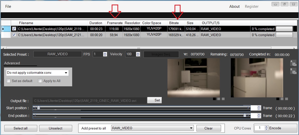

lucabutera Posted February 26, 2017 Share Posted February 26, 2017 6 hours ago, keessie65 said: in slow motion? 60fps and 120fps. Link to comment Share on other sites More sharing options...
Pavel Mašek Posted February 26, 2017 Share Posted February 26, 2017 Interesting Luca... I always gets dropped frames in some complex scenes when filming 120fps/+100Mbps. Link to comment Share on other sites More sharing options...
Marco Tecno Posted February 26, 2017 Share Posted February 26, 2017 I've never understood how to check for dropped frames. How can I do? Link to comment Share on other sites More sharing options...

Parker Posted February 26, 2017 Share Posted February 26, 2017 8 hours ago, Marco Tecno said: I've never understood how to check for dropped frames. How can I do? Well one thing I've noticed is that if my bitrate is too high I won't actually be getting 120p, the frame rate fluctuates down, sometimes I'll be getting like 116 fps, sometimes 109, etc. These are what show up as the framerate right in the information of the image in premiere, finder info etc. To be honest though, in my opinion anyway, it doesn't really seem to negatively affect the footage. I generally don't have my bitrate set that crazy high anyway, I usually shoot with 180mpbs in 4k and 160 in hfr fhd Link to comment Share on other sites More sharing options...
