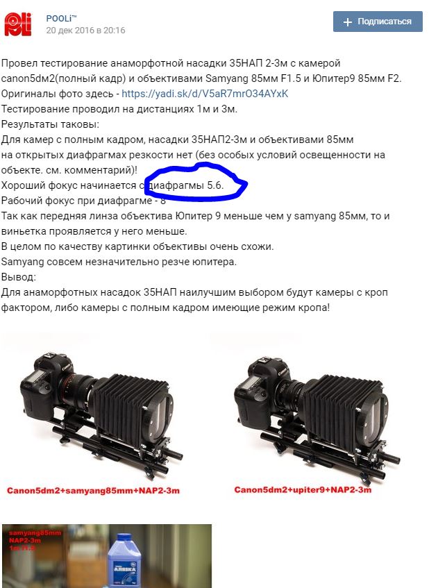

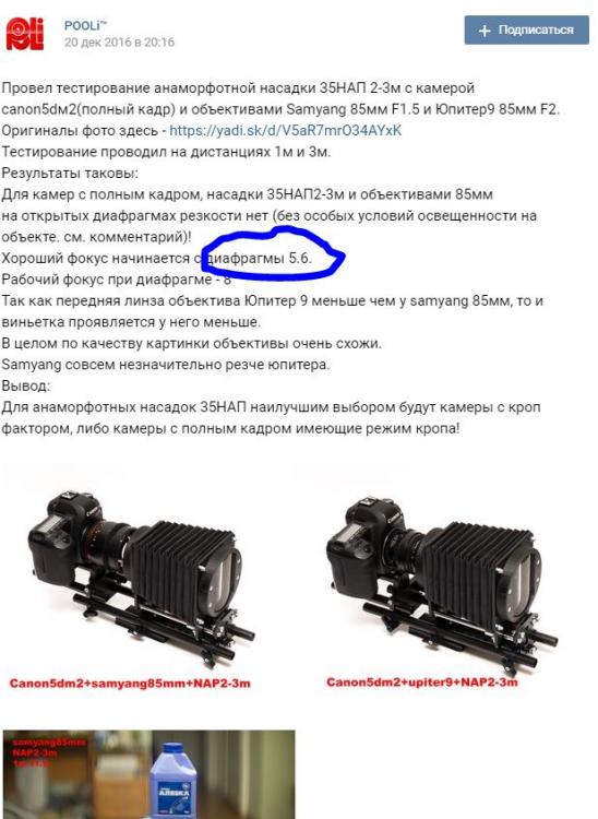

Dr. Verbel' Posted March 3, 2017 Share Posted March 3, 2017 I had a discussion with this man earlier, he talked about working aperture for good focus 5.6 for 35NAP family. But it not true. 35NAP no impact on the final critical sharpness of taking lens, if lenses of this ana well aligned. And he didn't want to admit his mistake. So I set up a few critical. No problem, man creating something, we will see now, he fix problem with sharpness or no. https://vk.com/poolitm?w=wall-47865797_1329 Quote Для камер с полным кадром, насадки 35НАП2-3м и объективами 85мм на открытых диафрагмах резкости нет (без особых условий освещенности на объекте. см. комментарий)! Хороший фокус начинается с диафрагмы 5.6. Рабочий фокус при диафрагме - 8 43 minutes ago, Flynn said: You guys are so negative. I think he's created something cool that I could not do, which he will probably improve upon. Give him some encouragement, not so much negativity! Link to comment Share on other sites More sharing options...
