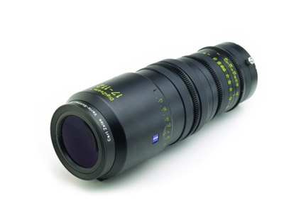

/p/ Posted March 6, 2013 Share Posted March 6, 2013 Zeiss DigiZoom 17-112mm T1.9 Mondo 1 Link to comment Share on other sites More sharing options...
