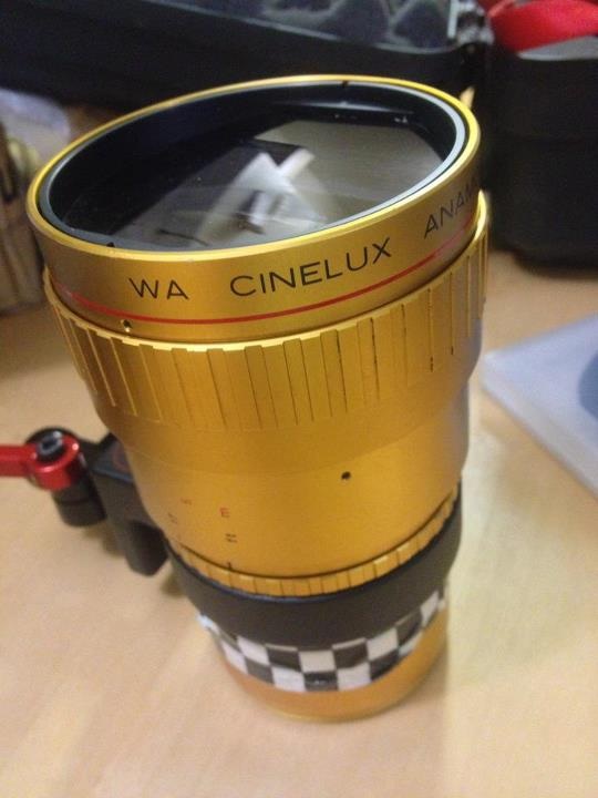

Ernesto Mantaras Posted March 8, 2013 Share Posted March 8, 2013 And what do you think about this particular anamorphic? How sharp is it at fast apertures, Andy? http://www.personal-view.com/talks/uploads/FileUpload/e1/bcddb94c7b7c91a7fdd2c47b177b9f.jpg Quote Link to comment Share on other sites More sharing options...
