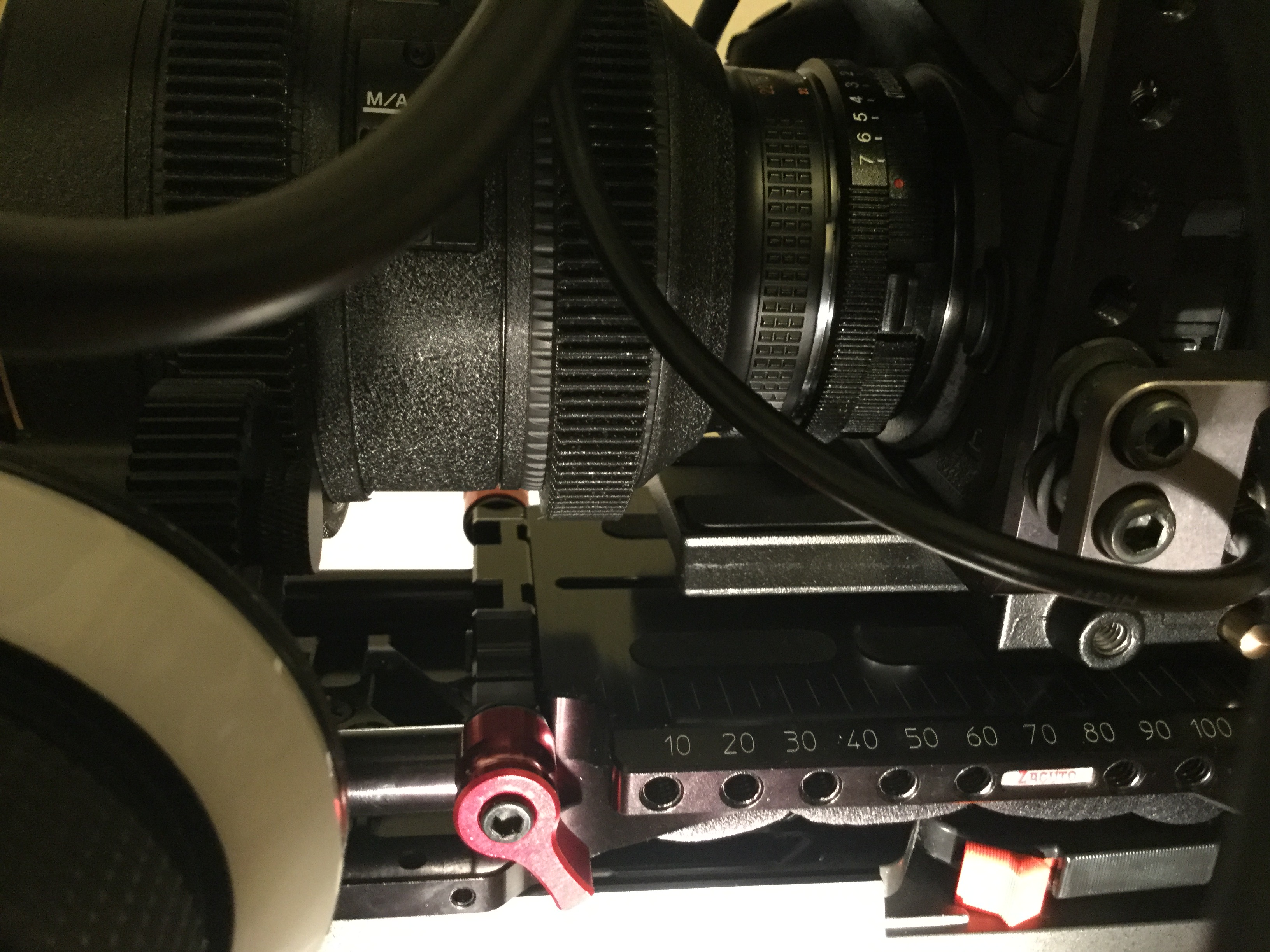

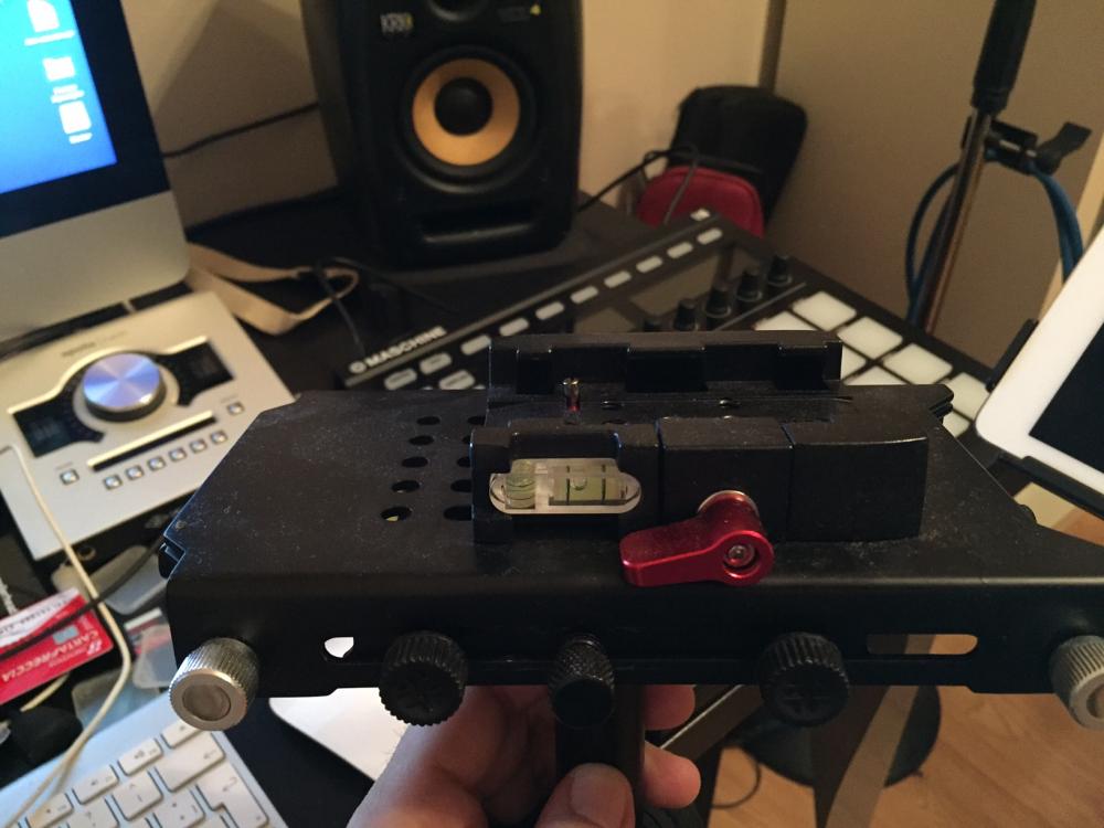

Fritz Pierre Posted March 13, 2017 Share Posted March 13, 2017 I solved a height issue on my rig by first mounting the camera and cage on a Sliding quick release plate. https://www.amazon.com/gp/product/B000JLK5Q4/ref=oh_aui_detailpage_o02_s00?ie=UTF8&psc=1 This in turn is then mounted on the Zacuto Universal Base/Shoulder plate...gives me room for a FF and up and down adjustments and finer balance depending on lenses used on the Zacuto I have a Sony VCT-14 plate permanently mounted on the tripod...the whole rig comes off in a couple of seconds and on your shoulder JazzBox 1 Link to comment Share on other sites More sharing options...

Fritz Pierre Posted March 13, 2017 Share Posted March 13, 2017 Bought my VCT-14 plate on eBay virtually New for $160...will work equally well with an Alexa as my set up and last a lifetime... You can see how the adjustments are done fore and aft to keep the camera and lens and all else like a mount or monitor you may hang...this setup works easily between 10 & 30 lbs. JazzBox and MountneerMan 2 Link to comment Share on other sites More sharing options...

Fritz Pierre Posted March 15, 2017 Share Posted March 15, 2017 5 hours ago, JazzBox said: Wow, great price and awesome solution! Thank you Fritz! I knew I wanted this set up because I looked at both the Varicam LT shoulder Pad and the Zacuto...they are both used with the VCT-14 plate...there are knock-offs...but if you're patient, this will last you a lifetime. Below is an old one on Ebay...the Sony's work especially well as you get heavier cameras or rigs on and off...I would not hesitate to get an old one...professional piece of rigging you'll only buy once! http://www.ebay.com/itm/Sony-VCT-14-/182485692194?hash=item2a7cfeaf22:g:Q64AAOSwTM5YxGCt JazzBox 1 Link to comment Share on other sites More sharing options...
