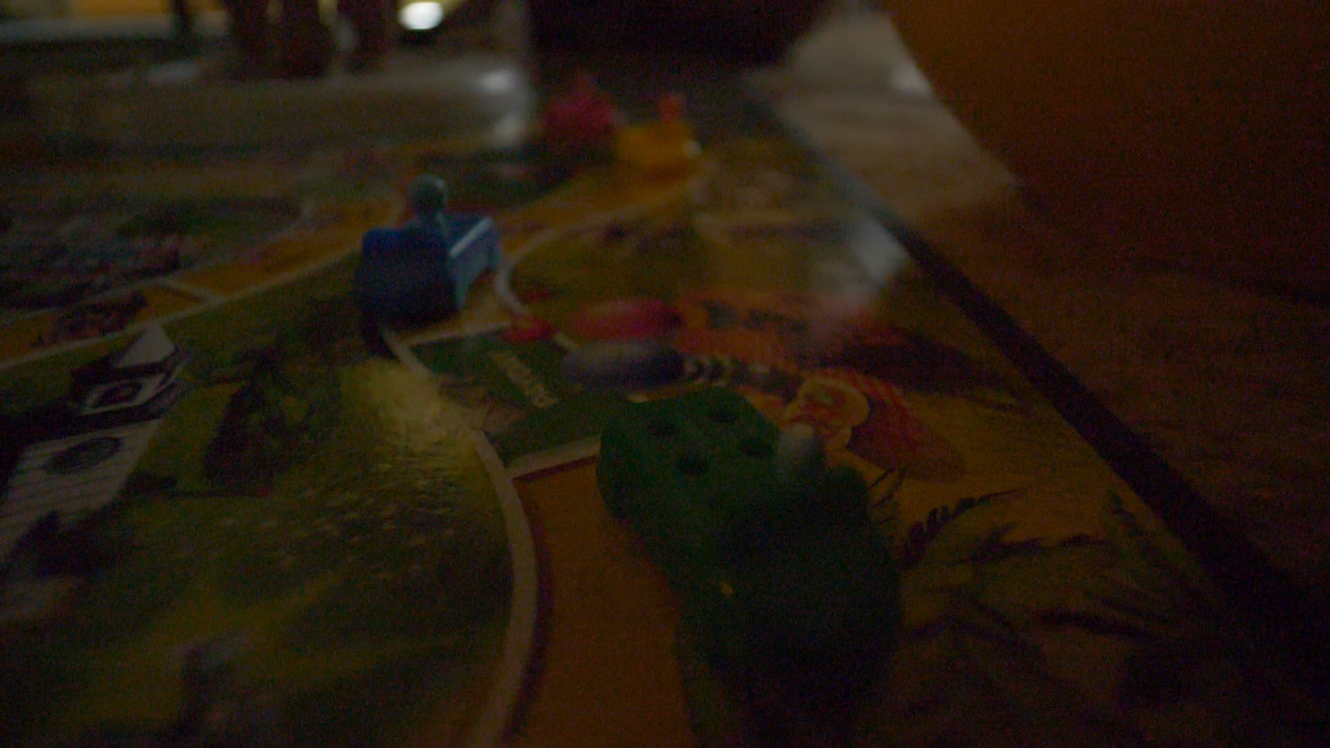

AnomalyVideo Posted October 20, 2017 Share Posted October 20, 2017 Hello! My 1st post here! And...I'm asking for help. I'm getting CRAZY NOISE from my GH5 and I can't figure out why! In general, I'm filming at 10bit/10bit/1920x1080, 23.98 LongGOP Here's a screen grab for reference. This is ungraded and I think was shot using 1600 iso or maybe a 1/3 stop above that. In doing some research, I came accross a lot of videos (here's one) in which this guy is getting super clean iso performance respectively. Link to comment Share on other sites More sharing options...
jonpais Posted October 20, 2017 Share Posted October 20, 2017 @AnomalyVideo What percentage is your screen grab blown up to? 300%? Because first of all, regardless of what ISO you were shooting at, the image is grossly underexposed. Can you share a video clip? Link to comment Share on other sites More sharing options...
AnomalyVideo Posted October 20, 2017 Share Posted October 20, 2017 Hi @jonpais Actually, that wasn't zoomed in at all. Here's an example of a video captured at 30fps for a contractor video (sorry to show you guys a bathroom!!) But pay attention to the tile near the shower on the left. Just ugly!! Especially in motion. Link to comment Share on other sites More sharing options...
Emanuel Posted October 20, 2017 Share Posted October 20, 2017 To underexpose when you mainly have low light will never conduct to fine performance... ;-) deezid 1 Link to comment Share on other sites More sharing options...

Orangenz Posted October 20, 2017 Author Share Posted October 20, 2017 6 hours ago, AnomalyVideo said: Hi @jonpais Actually, that wasn't zoomed in at all. Here's an example of a video captured at 30fps for a contractor video (sorry to show you guys a bathroom!!) But pay attention to the tile near the shower on the left. Just ugly!! Especially in motion. That doesn't look normal for the GH5, that's for sure. Can you export your camera settings please and I'll have a look. Link to comment Share on other sites More sharing options...
