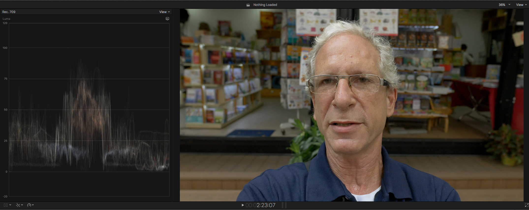

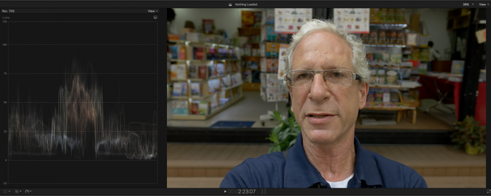

jonpais Posted April 13, 2017 Share Posted April 13, 2017 1 hour ago, Orangenz said: Ah, wondered why the shake. Nice image though. We're actually saying the same thing... Go by the zebras. Sometimes (most of the time for me) this means the histogram will be down a stop or so, sometimes over. So in both cases go by the zebras because once those highlights clip you can't save them. That's what he means (I think) about avoiding being overexposed. It's still not clear to me what Stab is referring to when he says to underexpose and lift the shadows, so I'd like to him to explain exactly how he meters and I'd like to see an example of a clip along with the waveform if he's got the chance. Link to comment Share on other sites More sharing options...
Orangenz Posted April 13, 2017 Author Share Posted April 13, 2017 20 minutes ago, jonpais said: It's still not clear to me what Stab is referring to when he says to underexpose and lift the shadows, so I'd like to him to explain exactly how he meters and I'd like to see an example of a clip along with the waveform if he's got the chance. Well when I read it I thought that it was just doing exactly what I am doing. And by the sounds, what you are doing. Most shots are mostly dark, say under a roof shade, but with a bit of sky that is really bright showing in the background. So as most of the image is quite a bit darker than that bit of sky by the time you have brought it down enough to not clip the sky (no zebras) the scene definitely is underexposed a stop or so. So in post you just bring the shadows up. That's the situation I think about. Expose for the zebras seems to result in underexposing more often than not. The point is, this is ok. Or more ok than one would have thought in the case of these new machines. Does that help? Link to comment Share on other sites More sharing options...
jonpais Posted April 13, 2017 Share Posted April 13, 2017 2 minutes ago, Orangenz said: Well when I read it I thought that it was just doing exactly what I am doing. And by the sounds, what you are doing. Most shots are mostly dark, say under a roof shade, but with a bit of sky that is really bright showing in the background. So as most of the image is quite a bit darker than that bit of sky by the time you have brought it down enough to not clip the sky (no zebras) the scene definitely is underexposed a stop or so. So in post you just bring the shadows up. That's the situation I think about. Expose for the zebras seems to result in underexposing more often than not. The point is, this is ok. Or more ok than one would have thought in the case of these new machines. Does that help? Could you share a clip along with the waveform in your NLE as well as the color corrected image. That would help me understand better. Link to comment Share on other sites More sharing options...
Orangenz Posted April 13, 2017 Author Share Posted April 13, 2017 7 minutes ago, jonpais said: Could you share a clip along with the waveform in your NLE as well as the color corrected image. That would help me understand better. It's just what you do, expose as far right as you can without clipping the highlights/zebras. Where the histogram lands is incidental. My after-market batteries are being shown up by the GH5. They have to be pretty rigourous to stand up to things. Pana over 2 hrs on first test (but had a problem with screen turning off so I have to redo that one) but 2 of my other batteries are around the 1 hr mark. One battery only managed 5 minutes so pretty funny I didn't spot that earlier with GH4 use. Maybe I did and forgot about it or thought I'd forgotten to charge it. The running sound is quite loud if you put your ear up to the camera. That goes all the time recording or not, ibis on or not. I'm thinking the camera would flatten the battery after 2 hours even if you didn't record anything. Was there a firmware update for the GX85 that made it quieter? Link to comment Share on other sites More sharing options...
jonpais Posted April 13, 2017 Share Posted April 13, 2017 Here's what I'd like to see. Link to comment Share on other sites More sharing options...
