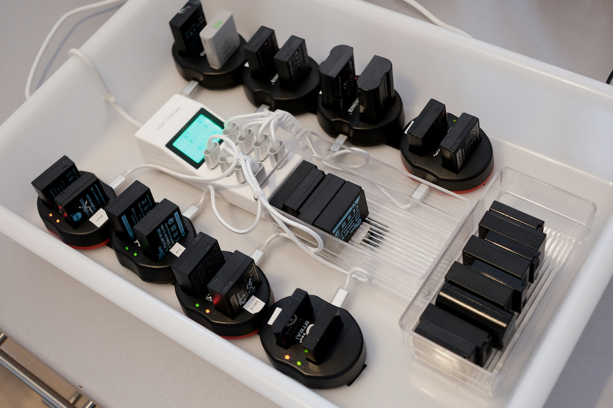

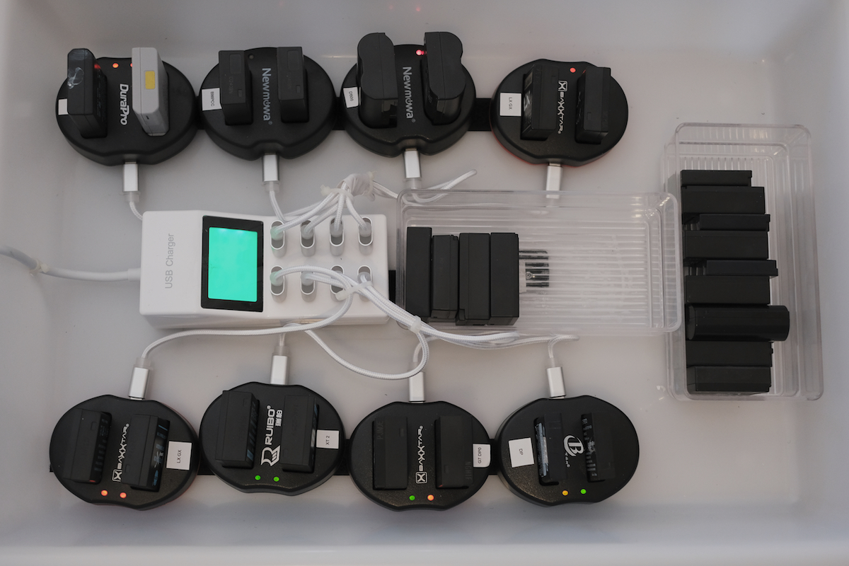

I have sets of these for most of my different camera types velcroed into a tray running off a multi output USB charger so I can be charging all of them off one outlet.
Then when I'm going away its just a question of pulling the right chargers out of the tray and I can recharge batteries off the usb outlet of my laptop or a regular iPhone charger. Saves a ton of space and hassle.
  • Super Members
Exhibit A !
8 chargers for simultaneous charging of 16 batteries with storage for charged and need charging, all off one mains outlet and fits in a tray the size of a kitchen drawer.
They all sit on a strip of velcro so can be detached easily for travel.
Total cost was around £90 with an average of about £9 per battery charger and I think roughly £25 for the USB distributor and cables. Plus £2 for the plastic tray obviously!
It was worth it for the lack of clutter alone and having to root through bags to find chargers and batteries all the time.
