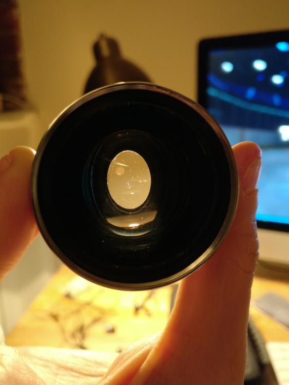

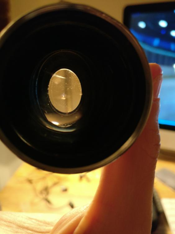

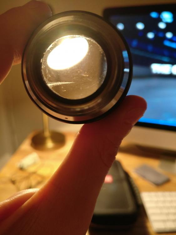

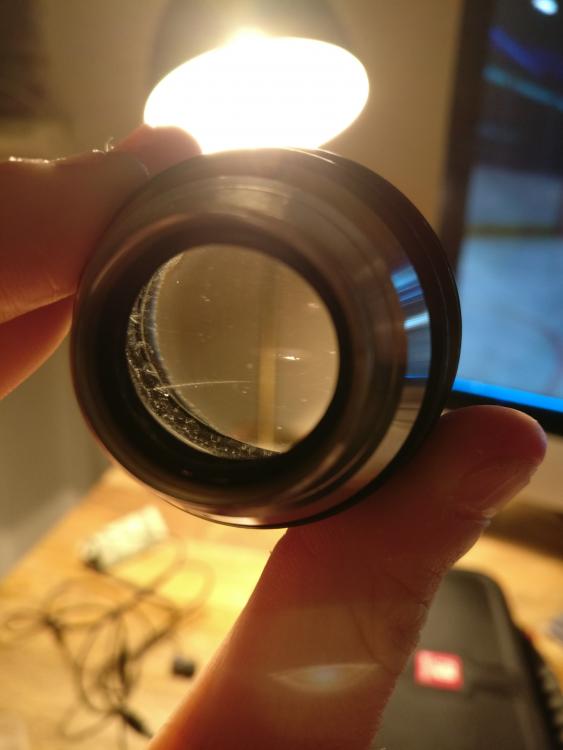

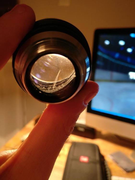

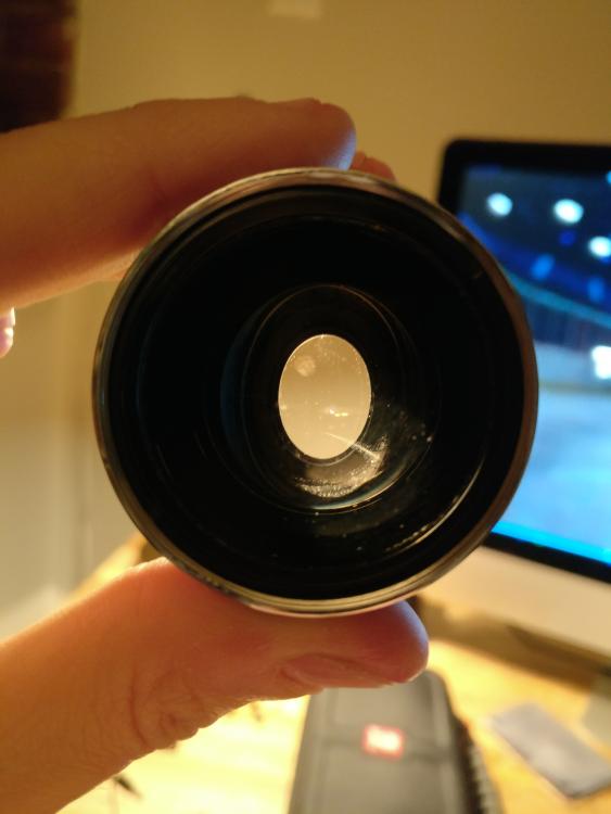

  • There's some kind of a marking inside that I'm unsure as to what it could be--scratch from disassembly/fungus? (see attached pictures)

Marking appears to be fungus and/or separation. Not good.
If you paid over $200, I'd personally return it for a refund. You could disassemble the lens yourself to clean and attempt to remove the offending fungus - but those little lenses can be a pain to clean because they are so small (but not impossible). Have you tried removing the rear clear filter at the rear of the lens to check that the offending mark is not just on that? (hard to tell from your pictures...but there is supposed to be a rear protective clear filter screwed onto the rear of the lens...but yours might have already been removed before you bought it). It does appear to my eye that the fungus or separation looks to be on the inner lens block :(

Thanks for the feedback, it's very much appreciated! I removed the rear element and it appears the marking is deeper within the lens.
