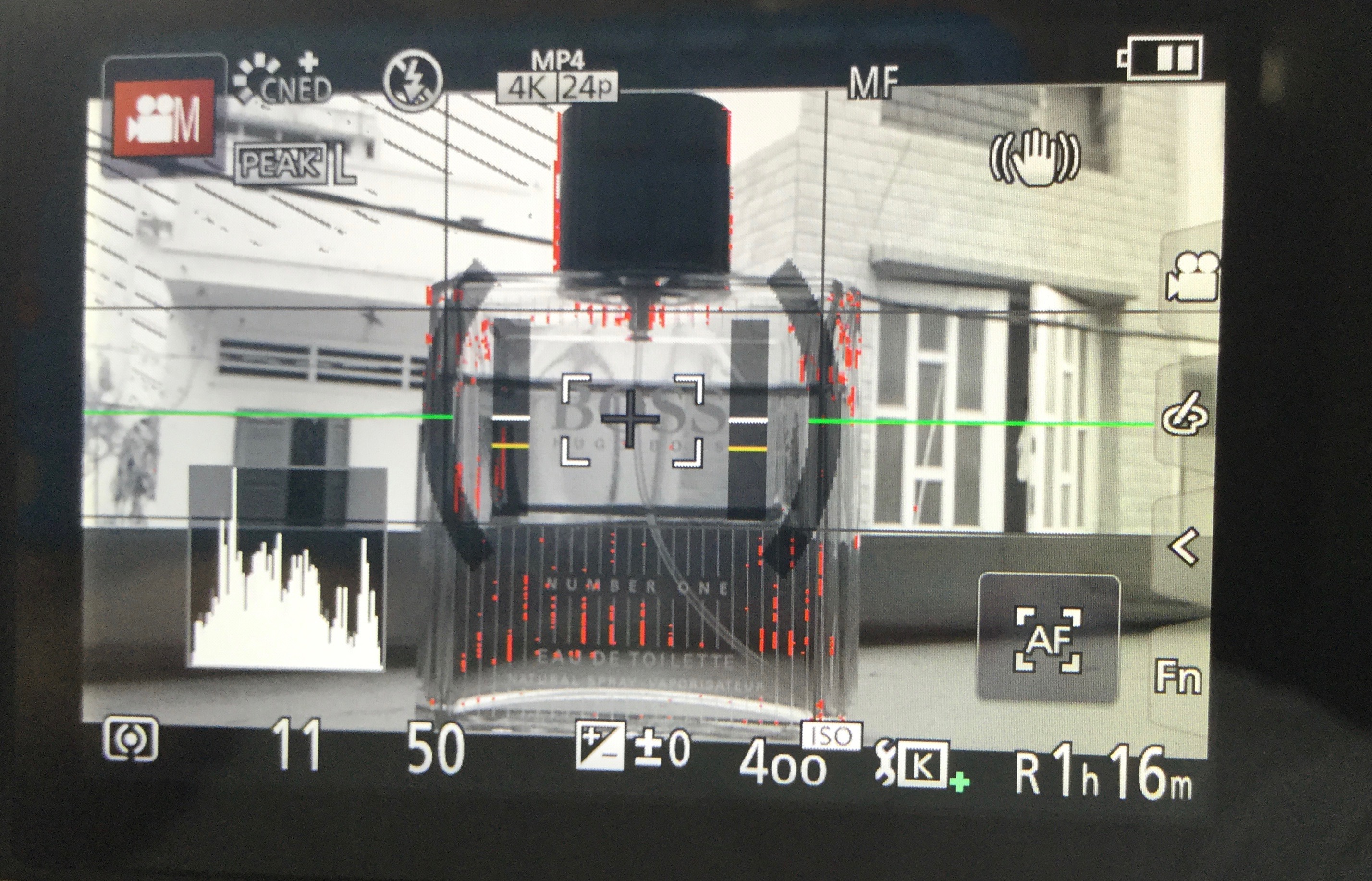

jonpais Posted April 8, 2017 Share Posted April 8, 2017 16 hours ago, gethin said: yes, green or red (red usually) Could you snap a pic with your phone of the LCD when a subject is in focus and peaking isn't visible? Link to comment Share on other sites More sharing options...
Novim Posted April 8, 2017 Share Posted April 8, 2017 On my GX85 everything OK, both with native and vintage lenses. Link to comment Share on other sites More sharing options...
