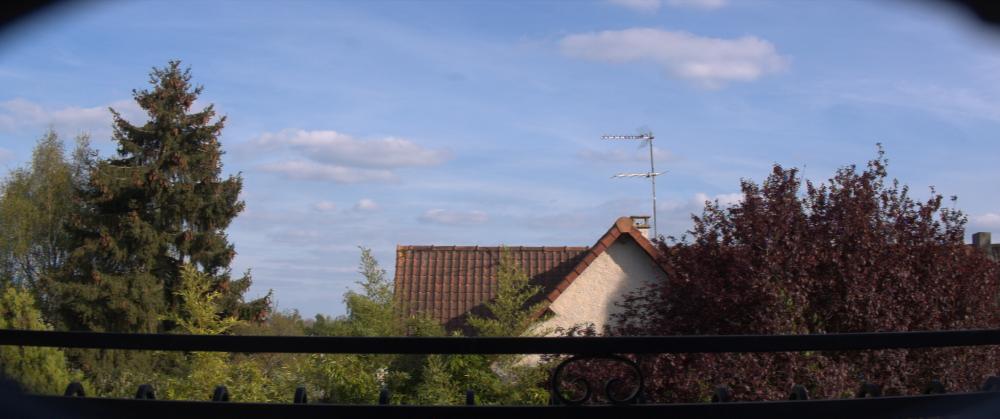

Here is the setup :
- Pana AF100
- Minolta 50/1.4 (@ f/4)
- Isco Ultrastar
- +1 Close-up diopter
- SLR Magic Rangefinder
- Century Optics Wide Angle adapter
58f0edb8c8637_AF100_Minolta50-1.2_f4_180_UltraStar@1.5m_1diopt_Rangefinder_CenturyWA_SETUP.thumb.jpg.a9d7cbb427bdafd78226a8331cd231c1.jpg
With the Rangefinder focused at the minimum (3'6 ft) I have infinity focus ! (YAY)
Pic 1 : With +1 diopter, Rangefinder, Wide Angle adapter (Both taking lens and anamorphic adapter focused to 1.5m)
58f0ee7d7f568_AF100_Minolta50-1.2_f4_180_UltraStar@1.5m_1diopt_Rangefinder_CenturyWA.thumb.jpg.4a359edac5b376aba64411b60baa196a.jpg

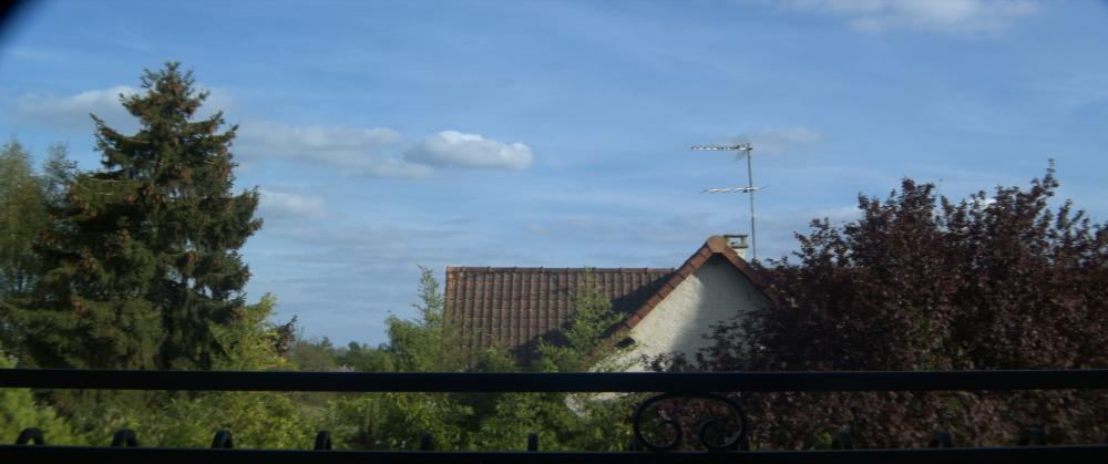

Pic 2 : nothing in front of the ultrastar (focused at infinity) graded to match the previous image
58f0ee83ee182_AF100_Minolta50-1.2_f4_180_UltraStar@inf_Corrected.thumb.jpg.8e053d753acb775b1000322e7dc3fd5c.jpg
Pic 3 : Same image uncorrected
AF100_Minolta50-1.2_f4_180_UltraStar@inf.thumb.jpg.e713abd0a6a9f42d0b97ad44b0da2122.jpg
It seems there is a lot of light loss with all the optical elements added :P
A bit of sharpness loss too, but that's to be expected knowing how NOT sharp the rangefinder is :s
