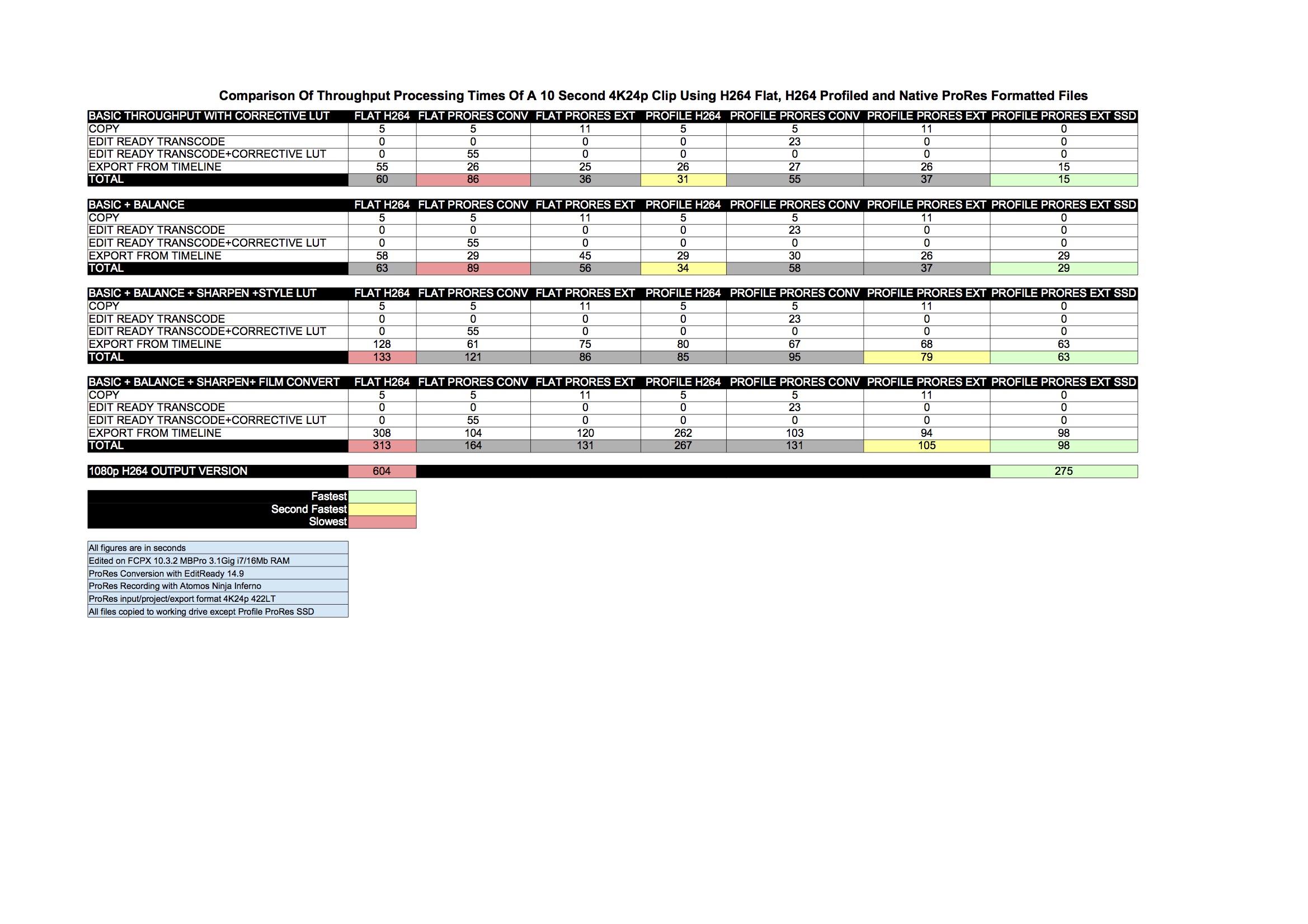

So I shot a 10 second clip on the G7 both in a Flat profile and a standard one (Cinelike D to be exact) internally to the card and then with the same profiles out again to the Atomos Disco Inferno *
All files were then copied to a regular USB3 external work drive.
I took the Flat and Cinelike D H264 files through a few typical journeys through FCPX, which were
1) Straight through (with the corrective LUT applied in the case of the Flat profile)
2) With a basic exposure and colour balance applied
3) As 2 but with an additional Sharpen and addition of a 'style' LUT applied
4) As 2 but with an additional Sharpen and FilmConvert process applied
I then did exactly the same passes after converting the in camera H264 files into ProRes using EditReady (with the correctional LUT for the Flat file added in the transcode) and then the same again with the externally recorded ProRes versions.
For a bit of sport, I then went for the absolute fastest path possible which was to plug in the SSD from the Atomos and edit the ProRes files straight off that.
If you are still awake, you can see the results in the spreadsheet I've attached.
The results are not in the least bit surprising as - spoiler alert - ProRes files with minimum fiddling absolutely cane H264 files that need massaging but its informative to me at least to see the extent of it quantified within how I would use it.
What's interesting is that the H264 files do OK at the beginning but this is largely because the copying and/or transcoding time of the ProRes files goes against them before they've even got into FCPX but once the heavier lifting comes in they are soon overtaken by the ProRes versions. And the cumulative effect of the multiple corrections needed to be applied to the Flat version also add up dramatically, especially when FilmConvert comes into the equation of course. And then finally when creating what would largely be my target output format of 1080p rather than the 4k timeline, it ends up being even worse.
Its worth bearing in mind that this is only a 10 second clip so its not difficult to imagine how alarming that 60 times real time render would feel like on something a bit more substantial. Yes, of course, it should be expected that it will take a while with FilmConvert on it but its sobering to see thats already 6 times real time without anything but the required correctional LUT on it. In comparison, the Cinelike D H264 version is half the time and only begins to be drawn back to it when FilmConvert is applied.
And the conclusion?
Well the gold standard in this test in terms of getting the fastest throughput is the externally recorded Cinelike D ProRes read straight from its own SSD so thats no surprise and would be the way to go for me in terms of shifting stuff if I master the profile and retain control of the shooting situation (or the serenity to accept that I can't) and don't mind lugging around something that is significantly bigger, more power hungry and unwieldy than the cameras its attached to.
The other non surprise is that the Flat profile whether in H264 or transcoded to ProRes is the worst performer. Bearing in mind that this test just measures file transfer/rendering time then the additional time in finessing the Flat profile (which would be substantial in my case) makes this an order of magnitude worse.
Which leaves us with trying to find the sweet spot which in this case would be split between Cinelike D in H264 if it was only going to be lightly touched or a transcoded version if it needed more work. There is a balance to be found between the two because whilst there is a time and disk space penalty to the transcoding, it does pay off even if you don't go to heavier correction because FCPX plays much nicer with ProRes files full stop.
My conclusion for these summer projects then is to stick with an in camera profile, work within its parameters instead of changing them or ignoring them and take the transcoding time hit at the beginning of editing. And buy more hard drives, obviously.
