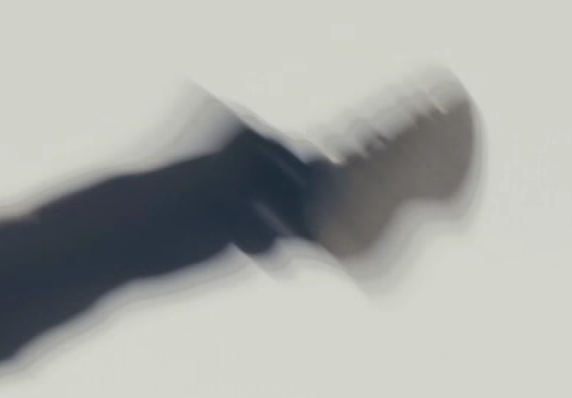

Don Kotlos Posted May 1, 2017 Share Posted May 1, 2017 31 minutes ago, Laurier said: Also the motion is not even comparable, it s just ugly on Gh cameras, it s fine if you do documentary/corporate work but for fiction or music video the aesthetic is not very appropriate . Yep they need to disable the temporal noise reduction. Even though it generally looks alright there are cases that it creates strange artifacts (and no his leg was not wiggling around , EDIT but now that I think about it might might be due to shooting at higher frame-rate and then exporting at 24p but there are other examples as well) : from Link to comment Share on other sites More sharing options...

Dimitris Stasinos Posted May 1, 2017 Share Posted May 1, 2017 Thanks for the test Aaron! Regarding gh5 (and previous gh*) motion issues, have you guys encountered the source of this problem? Is it NR as Don Kotos stated? Maybe a codec related issue? Is it possible that with the 400 mbps All-I will this get solved? Link to comment Share on other sites More sharing options...
PannySVHS Posted May 1, 2017 Share Posted May 1, 2017 3 hours ago, Don Kotlos said: Yep they need to disable the temporal noise reduction. Even though it generally looks alright there are cases that it creates strange artifacts (and no his leg was not wiggling around , EDIT but now that I think about it might might be due to shooting at higher frame-rate and then exporting at 24p but there are other examples as well) : They shot this on Firmware 1.0. Last firmware is supposed to switch temporal noise reduction off in VLOG. Link to comment Share on other sites More sharing options...
