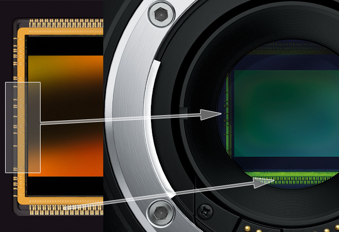

Administrators Andrew Reid Posted April 9, 2013 Administrators Share Posted April 9, 2013 Last year I found a sensor which seemed a perfect match for future 4K Blackmagic Cinema Cameras. I contacted the supplier CMOSIS who quoted me a rough price point which made 4K for $4K within reach. CMOSIS are a European company who are mass producing the full frame CMOS sensor in the new Leica M so they are an extremely reliable and high regarded supplier with experience of mass production for the photographic market.Read the full article here Link to comment Share on other sites More sharing options...

Tzedekh Posted April 9, 2013 Share Posted April 9, 2013 I agree that it looks like the CMV12000, particularly when you consider BMD's specs for the 4K camera's sensor -- unless a heretofore unknown sensor is being used, only the CMV fits the specs. With its pixel pitch of 5.5 μm, a window of 3,840 x 2,160 pixels (the BMPC sensor's active area) would measure 21.12 x 11.88 mm, the same as the BMPC sensor's. Unfortunately, unless BMD has implemented at least one of the CMV's three HDR modes, it would seem that a 12-stop dynamic range would be impossible. The CMV's 60-dB DR figure translates to 10 stops, and that would be the theoretical maximum. Link to comment Share on other sites More sharing options...
TC Posted April 9, 2013 Share Posted April 9, 2013 Blackmagic are claiming 12 stops. I expect CMOSIS have been working Blackmagic to optimise the sensor to Blackmagic's requirements and have managed to squeeze an extra stop out of it. 12 stops is still as much as any Canon camera ever released. Link to comment Share on other sites More sharing options...
