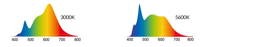

tomekk Posted May 10, 2017 Share Posted May 10, 2017 Jcs, have you tried daylight http://www.yujiintl.com/high-cri-led-lighting (CRI 98, not that it matters) ? They match sunlight entering my room very well and under this light colours in prints match what I see on a calibrated Eizo screen too. I believe they sell led strips which would be perfect for creating video panels https://store.yujiintl.com/products/vtc-series-high-cri-led-2835-ribbon-120-led-m-unit-5m-reel-1 jcs 1 Link to comment Share on other sites More sharing options...
jcs Posted May 10, 2017 Author Share Posted May 10, 2017 9 hours ago, tomekk said: Jcs, have you tried daylight http://www.yujiintl.com/high-cri-led-lighting (CRI 98, not that it matters) ? They match sunlight entering my room very well and under this light colours in prints match what I see on a calibrated Eizo screen too. I believe they sell led strips which would be perfect for creating video panels https://store.yujiintl.com/products/vtc-series-high-cri-led-2835-ribbon-120-led-m-unit-5m-reel-1 @tomekk- those look like fantastic LEDs. Excellent spectrum examples on their site as well, and excellent R9 performance. As competition heats up, expect even better light performance, not just in color but also thermal and luminous efficiency per Watt. Fiilex-sized (and build quality) point-source lights with more power will be amazing! (Aputure produces excellent light, however not in the same class in terms of size, build quality, and industrial design (to be fair, Fiilex are much more expensive lights per Watt/Luminous output)). Fiilex is just releasing the new 360 Pro Plus: http://www.fiilex.com/products/P360_ProPlus.php. At $995 ($845 without hue control (still has color temp control)) it's a few hundred more than the Aputure 120d, however it's also variable color (including optional hue control!), much smaller, IP24 weatherproof, and has many cool modifiers available. The Aputure uses 135W vs. 90W for the Fiilex (+ Fiilex is variable color), so I'd expect the Aputure to be brighter, however we'd need to see independent tests for lux at 1m for both lights). Fiilex has more powerful lights (e.g. https://www.bhphotovideo.com/c/product/1043613-REG/fiilex_flxq5ac_q_500_ac_5_bfresnel.html), at $2k we're no longer in the best-bang-for-buck category (the build quality and light quality is amazing. Would be interesting to see a comparison with the new Aputure 300d when released). Hanriverprod and tomekk 2 Link to comment Share on other sites More sharing options...
ND64 Posted May 13, 2017 Share Posted May 13, 2017 Still very big peak at blue range. Poor models may suffer from macular degeneration sooner that they think :-) Link to comment Share on other sites More sharing options...
