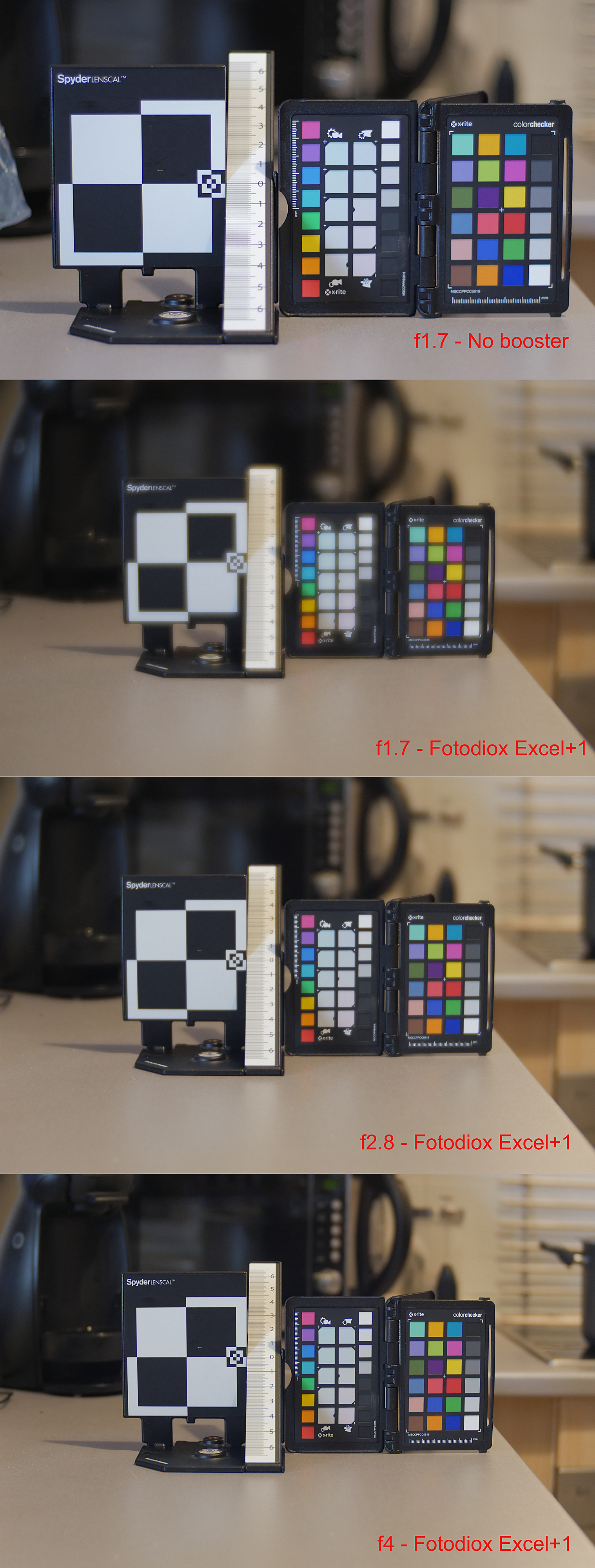

EDIT-     Just checked and it seems the Excel +1 is the IMPROVED replacement for the Light Cannon!!!!!!
Here is a test showing it with a Contax Zeiss 50mm f1.7 and a Panasonic G7.
Shots are 1.7 with a dumb C/Y MFT adapter, f1.7 with the Fotodiox, f2.8 with the Fotodiox and f4 with the Fotodiox.
As you can see, it does the field of view part right at least but sharpness doesn't make a comeback until f4

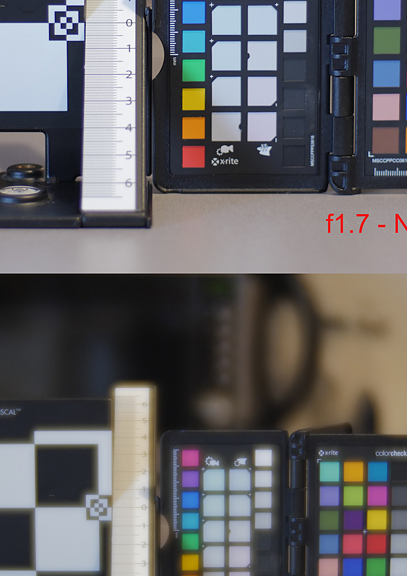

Crop of the f1.7 with and without the Fotodiox.
