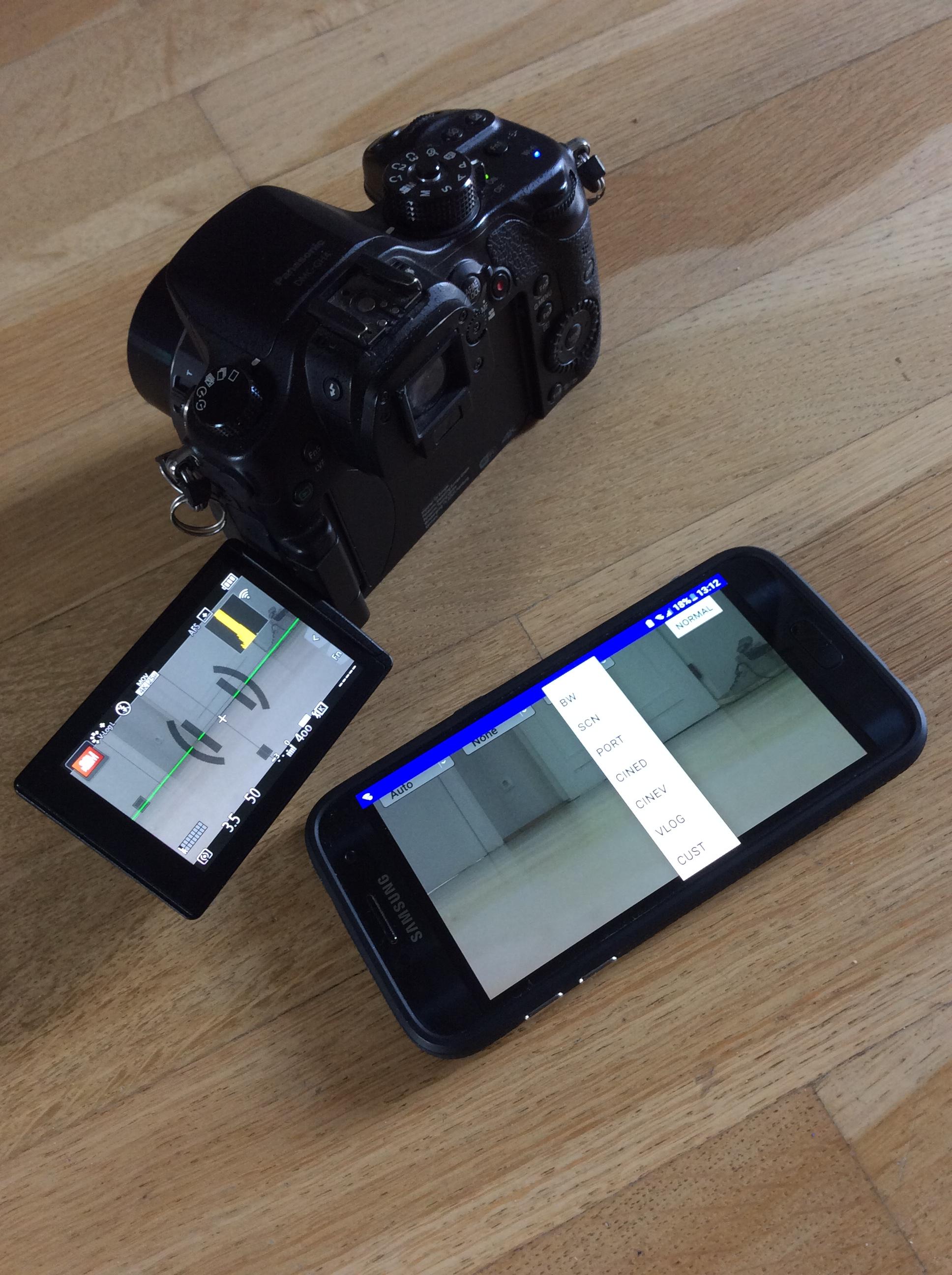

anti12 Posted July 4, 2017 Share Posted July 4, 2017 Hello, my GH4 is still on Firmware 2.3 The Android version of Gmonitor app recently added the feature to change Cinestiles. I am now able to select and use V-Log L. BTM_Pix 1 Link to comment Share on other sites More sharing options...
Super Members BTM_Pix Posted July 4, 2017 Author Super Members Share Posted July 4, 2017 On 7/4/2017 at 11:13 AM, anti12 said: Hello, my GH4 is still on Firmware 2.3 The Android version of Gmonitor app recently added the feature to change Cinestiles. I am now able to select and use V-Log L. Expand Bear with me for a minute then. That has given me an idea .... Link to comment Share on other sites More sharing options...
Super Members BTM_Pix Posted July 4, 2017 Author Super Members Share Posted July 4, 2017 EDIT >>>>> OK After harvesting commands, I can confirm that as I suspected it is game over for VLOG on the GX80/85. You all owe me £3.99 for that discovery anti12 1 Link to comment Share on other sites More sharing options...
