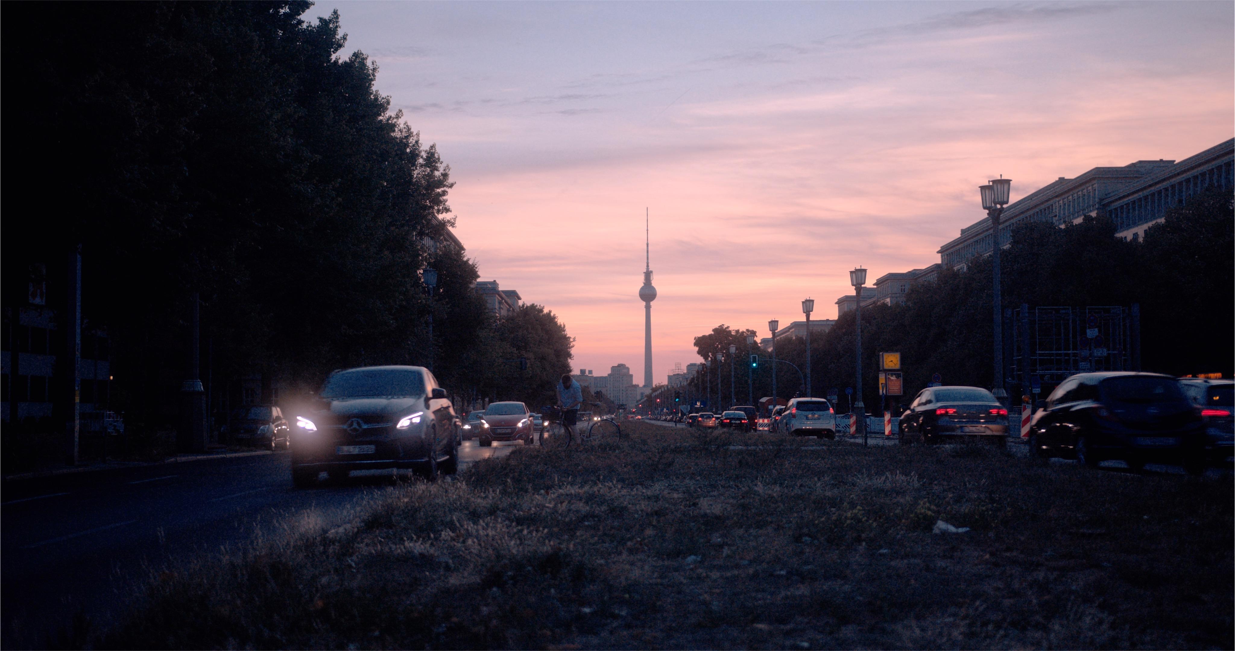

Gregormannschaft Posted August 19, 2018 Share Posted August 19, 2018 Exposure is a funny old thing with this camera in RAW so far. I took it out for a walk last night around Friedrichshain in Berlin, tough conditions. The max ISO I'm wanting to push this too at the moment is around 1600, and when there isn't enough available light to overexpose the image you're going to have noisy shadows. Here's a screengrab before and after noise reduction – it's most obvious in the car windows. The noise reduction did an incredible job. Either way, while middle grey should be exposed at around 38% with CLOG3, I'm tending to want to overexpose and bring down the exposure in post. The highlight retention is really impressive, and it helps combat the noisy shadows. edit: The upload seems to have crushed the image a fair bit, but the noise is still visible. PannySVHS 1 Link to comment Share on other sites More sharing options...
webrunner5 Posted August 19, 2018 Share Posted August 19, 2018 So what ISO is that shot at? That sounds like a heck of a big limitation if 1600 is max on a Canon Cine camera! Link to comment Share on other sites More sharing options...
Gregormannschaft Posted August 19, 2018 Share Posted August 19, 2018 That's shot at ISO 800. It must have been underexposed. But there's a fair few other shots as well with similar noise patterns in the shadows. Others look pretty good. I really wouldn't want to go too high with RAW lite though, 3200 would be the absolute maximum unless you're planning to use de-noising software for every shot in post. Link to comment Share on other sites More sharing options...
mercer Posted August 19, 2018 Share Posted August 19, 2018 4 hours ago, webrunner5 said: So what ISO is that shot at? That sounds like a heck of a big limitation if 1600 is max on a Canon Cine camera! How and when did ISO 1600 become a limitation in any cinema camera? 36 minutes ago, Gregormannschaft said: That's shot at ISO 800. It must have been underexposed. But there's a fair few other shots as well with similar noise patterns in the shadows. Others look pretty good. I really wouldn't want to go too high with RAW lite though, 3200 would be the absolute maximum unless you're planning to use de-noising software for every shot in post. What lens did you use? With Raw, you need a fast lens for so many shots. I’ve ended up shooting mostly with one or two fast primes just in case I am shooting a high contrast scene with a lot of shadows... or shooting way into magic hour like this shot. Link to comment Share on other sites More sharing options...

PannySVHS Posted August 20, 2018 Share Posted August 20, 2018 19 hours ago, Gregormannschaft said: Here's a screengrab before and after noise reduction – it's most obvious in the car windows. The noise reduction did an incredible job. Hey, nice mood for sure! What noise reduction did you use? What were your settings? Second shot looks perfect. cheers Link to comment Share on other sites More sharing options...
Gregormannschaft Posted August 20, 2018 Share Posted August 20, 2018 28 minutes ago, PannySVHS said: Hey, nice mood for sure! What noise reduction did you use? What were your settings? Second shot looks perfect. cheers Cheers! It still looks a little darker here than it did in FCPX or in the exported still before upload. I was using the Sigma 18-35 at f2, ISO 800 with a Tiffen Black Pro Mist 1/4 filter. Used Neat Video to process the noise, dropping the high frequency noise reduction to about -50% to avoid that plastic look and added some sharpening. Neat Video is incredible. @HockeyFan12 You've inspired me to do some more tests in the same spot and mess around a little with the exposure. I'll report back later this week. PannySVHS 1 Link to comment Share on other sites More sharing options...

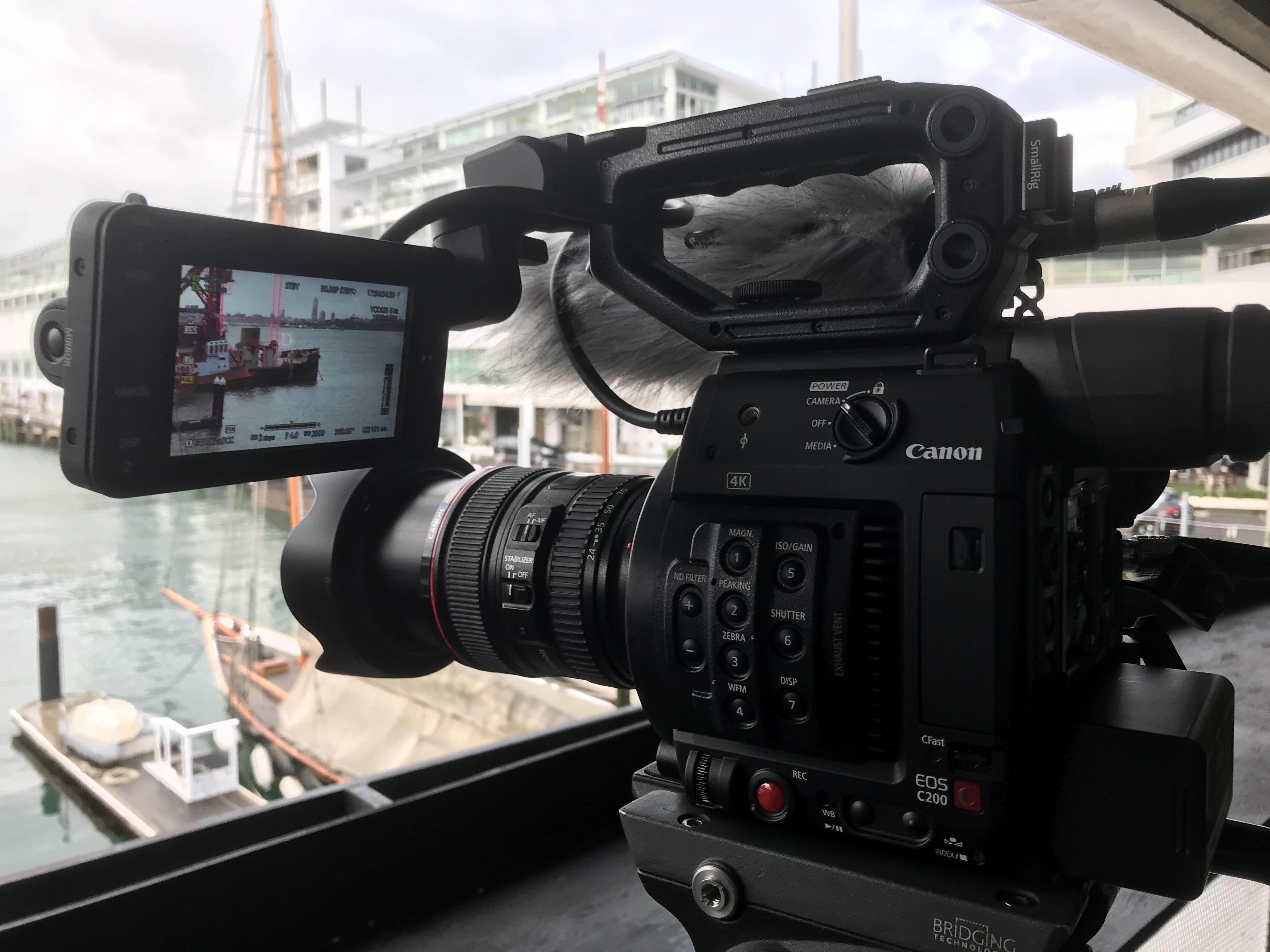

ntblowz Posted August 21, 2018 Share Posted August 21, 2018 Finally get to use one, awesome camera indeed! mercer and webrunner5 2 Link to comment Share on other sites More sharing options...
Gregormannschaft Posted August 21, 2018 Share Posted August 21, 2018 10 hours ago, ntblowz said: Finally get to use one, awesome camera indeed! Nice! Post back with your thoughts. The 24-105 is a pretty loud lens for AF (right? Or it might just be my lens with sand in the motor from years ago...) but works pretty well taking into account just how old it is. I picked up a Sigma 18-35 second hand for around 450 euros which is a beauty of a lens. Link to comment Share on other sites More sharing options...
