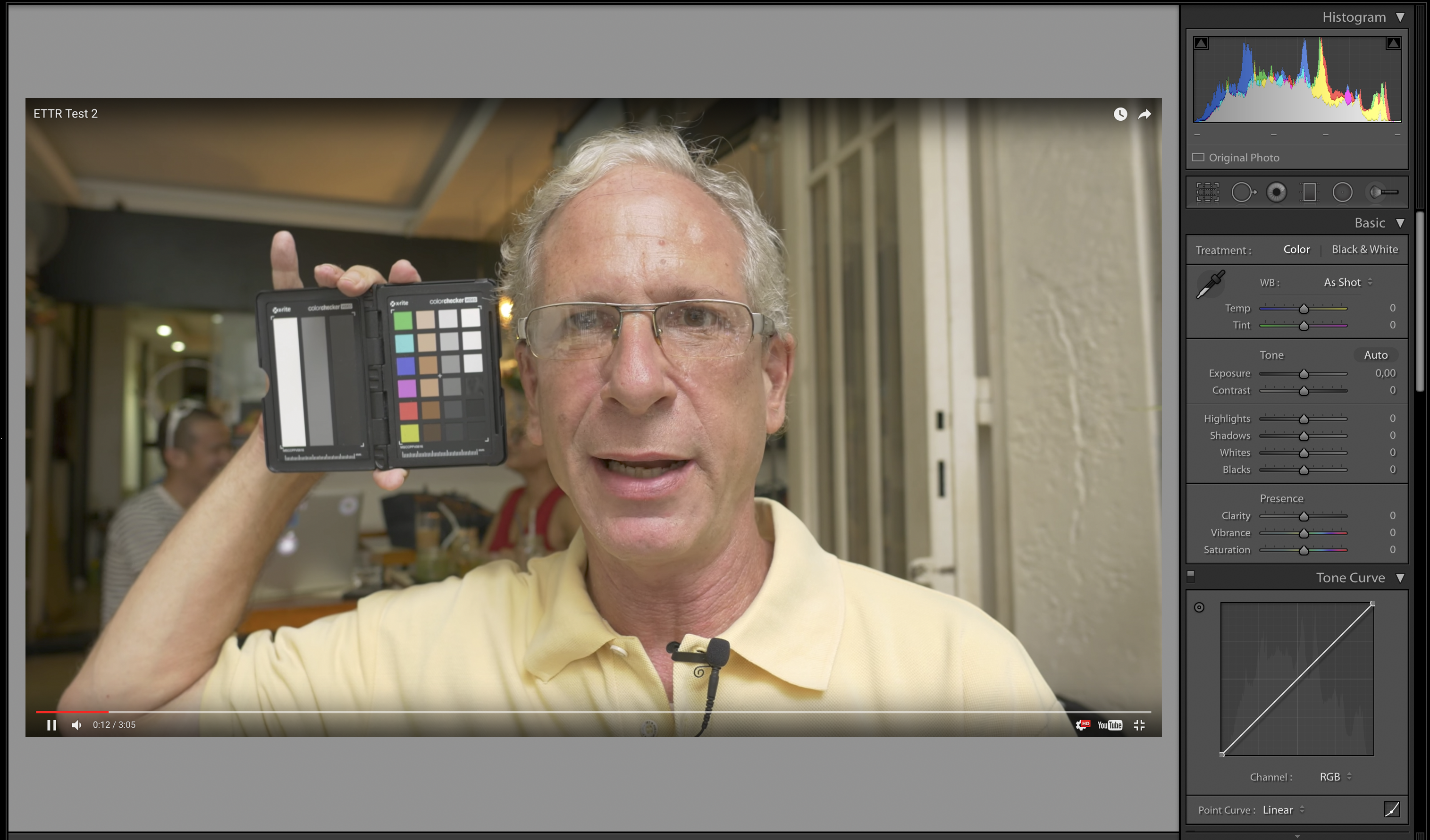

Fredrik Lyhne Posted June 13, 2017 Share Posted June 13, 2017 @jonpais Are you sure this is ETTR? Looks more like +/-0. Can you post a frame of the ETTR soon so I can see the histogram i Lightroom? Quote Link to comment Share on other sites More sharing options...
jonpais Posted June 13, 2017 Author Share Posted June 13, 2017 49 minutes ago, Fredrik Lyhne said: @jonpais Are you sure this is ETTR? Looks more like +/-0. Can you post a frame of the ETTR soon so I can see the histogram i Lightroom? It is really very slight, as I say in the video, I actually opened up the aperture just until there were zebras (@100%) on my t-shirt and used that as my ETTR shot. I am working on another, far more detailed video, which I hope to post very soon. Quote Link to comment Share on other sites More sharing options...

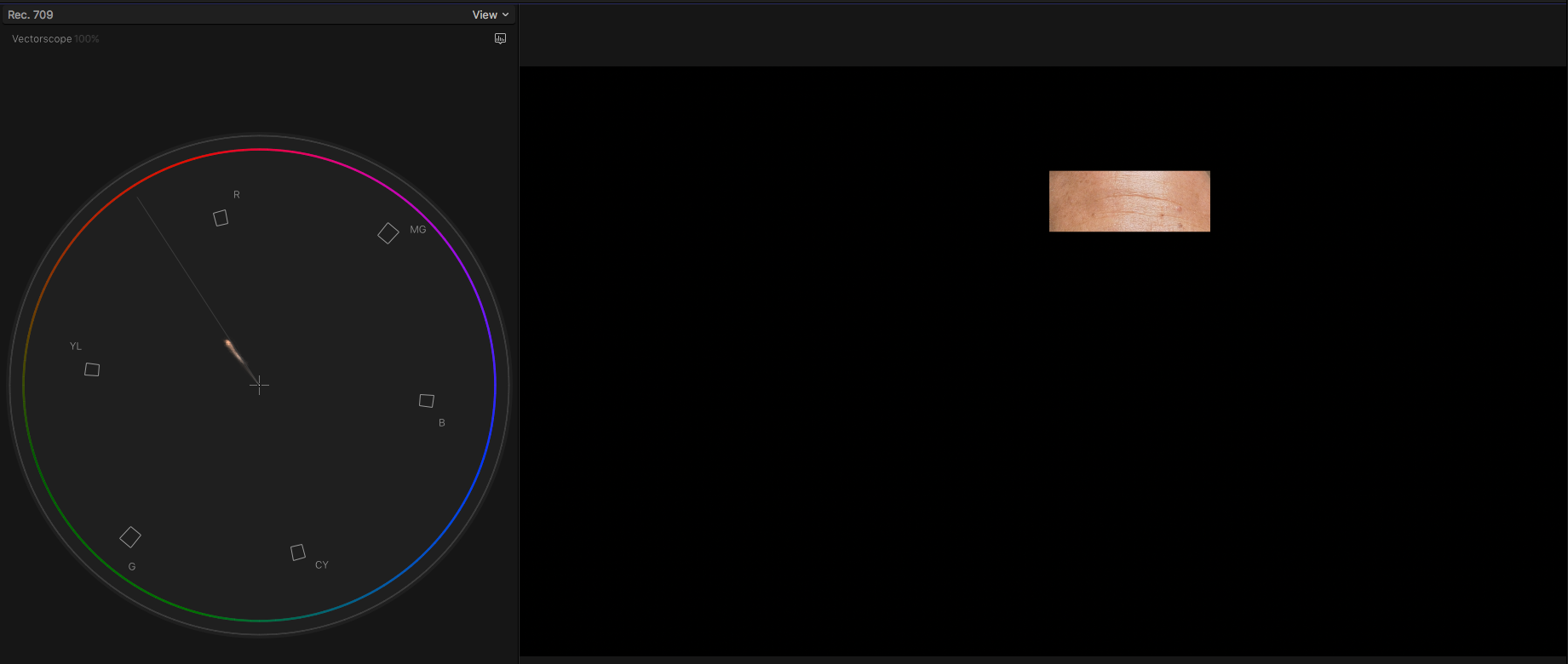

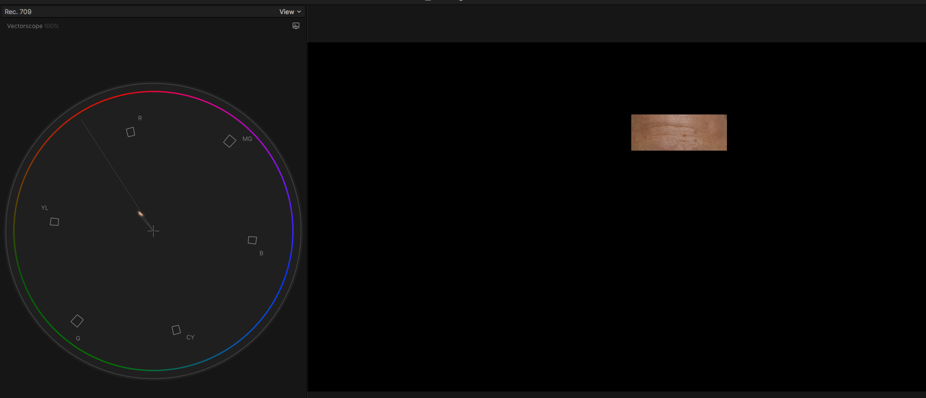

jonpais Posted June 14, 2017 Author Share Posted June 14, 2017 @Axel @Orangenz @Fredrik Lyhne I did another more pathologically detailed test this afternoon, this time, along with glorious screen grabs of the waveform monitor, and a couple shots of the vector scope readings for both the ETTR clip and the grossly underexposed one to show how exposure affects skin tones. To my way of thinking, the vector scope is showing far greater color information in the ETTR shot, and it's practically sitting on the skin tone line, so I don't see why it would give someone any trouble grading. As I've said before, I think proper WB in camera is key to good skin tones. Quote Link to comment Share on other sites More sharing options...

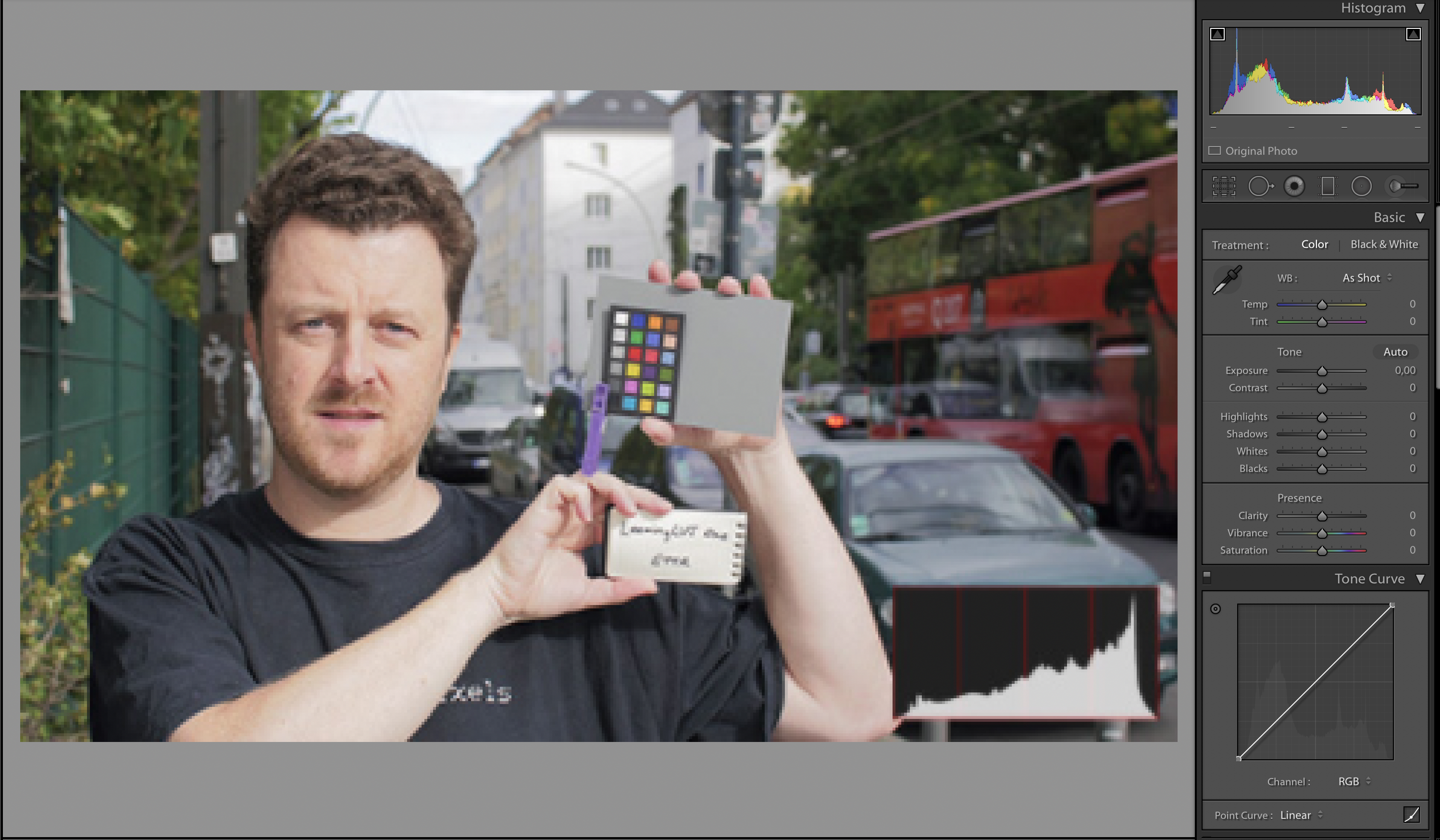

jonpais Posted June 14, 2017 Author Share Posted June 14, 2017 First of all, thanks everyone for taking the time to give feedback! Very interesting to read your responses, as well as being able to see comparisons between my work and that of Paul Leeming and Noam Kroll. @Arikhan I don't use AWB since it doesn't give consistent results, and because I'm usually shooting outdoors where the light is constantly changing, even during the course of a single shot, it would make CC troublesome, though some people seem to be having good luck with AWB. @mercer I use 100% zebras, not 90%, so I couldn't say at which f-stop the zebras would have disappeared in that scenario. For the very first exposure, my polo is completely covered with zebras on camera right. If the shirt had occupied a smaller portion of the screen, or if I'd been wearing a black shirt, I could have raised exposure even more. Because my understanding of ETTR is that you want to protect the important highlights, and that would include my shirt in this case. I changed exposure in increments of 1/3 of a stop, not full stops. @Fredrik Lyhne Gosh darn it, you're right! Paul's histogram is a little misleading, since it's obviously not representative of the light values in the image. While we're all focusing on the highlights, it's also important to remember that we're still exposing for the shadows as well, and if you look at the waveform monitor for what I consider to be a proper ETTR shot, the shadows are raised considerably above 0 IRE, whereas in the underexposed shots, the information is all bunched up in the lower portion of the scope. And whether my version is ETTR Lite or not, I hope these videos stimulate others to do their own tests. 16 minutes ago, Fredrik Lyhne said: I'm really trying but there is no way I can fix that ETTR shot, especially the shirt. Could be my grading skills though... I also think it's too bright, which I think proves that it is definitely not a normal exposure, and in practice, I would also have chosen to expose a little bit darker. No one should blindly follow any one method, you've got to use good judgement as well. Quote Link to comment Share on other sites More sharing options...
Fredrik Lyhne Posted June 14, 2017 Share Posted June 14, 2017 44 minutes ago, jonpais said: First of all, thanks everyone for taking the time to give feedback! Very interesting to read your responses, as well as being able to see comparisons between my work and that of Paul Leeming and Noam Kroll. @Arikhan I don't use AWB since it doesn't give consistent results, and because I'm usually shooting outdoors where the light is constantly changing, even during the course of a single shot, it would make CC troublesome, though some people seem to be having good luck with AWB. @mercer I use 100% zebras, not 90%, so I couldn't say at which f-stop the zebras would have disappeared in that scenario. For the very first exposure, my polo is completely covered with zebras on camera right. If the shirt had occupied a smaller portion of the screen, or if I'd been wearing a black shirt, I could have raised exposure even more. Because my understanding of ETTR is that you want to protect the important highlights, and that would include my shirt in this case. I changed exposure in increments of 1/3 of a stop, not full stops. @Fredrik Lyhne Gosh darn it, you're right! Paul's histogram is a little misleading, since it's obviously not representative of the light values in the image. While we're all focusing on the highlights, it's also important to remember that we're still exposing for the shadows as well, and if you look at the waveform monitor for what I consider to be a proper ETTR shot, the shadows are raised considerably above 0 IRE, whereas in the underexposed shots, the information is all bunched up in the lower portion of the scope. And whether my version is ETTR Lite or not, I hope these videos stimulate others to do their own tests. I also think it's too bright, which I think proves that it is definitely not a normal exposure, and in practice, I would also have chosen to expose a little bit darker. No one should blindly follow any one method, you've got to use good judgement as well. Haha, glad we're finally on the same page! Your test's have been very helpful and this really shows that one should pay more attention to exposure. Paul's histogram is indeed very misleading and I think it's just a case of an expert trying to explain something to non-experts but forget that they are not experts! The shots I graded are ETTR and -2/3 but I didn't try -1/3, maybe that one will work too? I find it a bit strange that your shirt was overexposed beyond repair when you followed Paul's advice with 100% zebras. Did you try to grade the different shots to see which was easiest for you? But you are right about the noise Jon, it's less noise in the shadows when done right, but unlike raw theres only a very small window where color, noise and highlights are perfect. jonpais 1 Quote Link to comment Share on other sites More sharing options...
