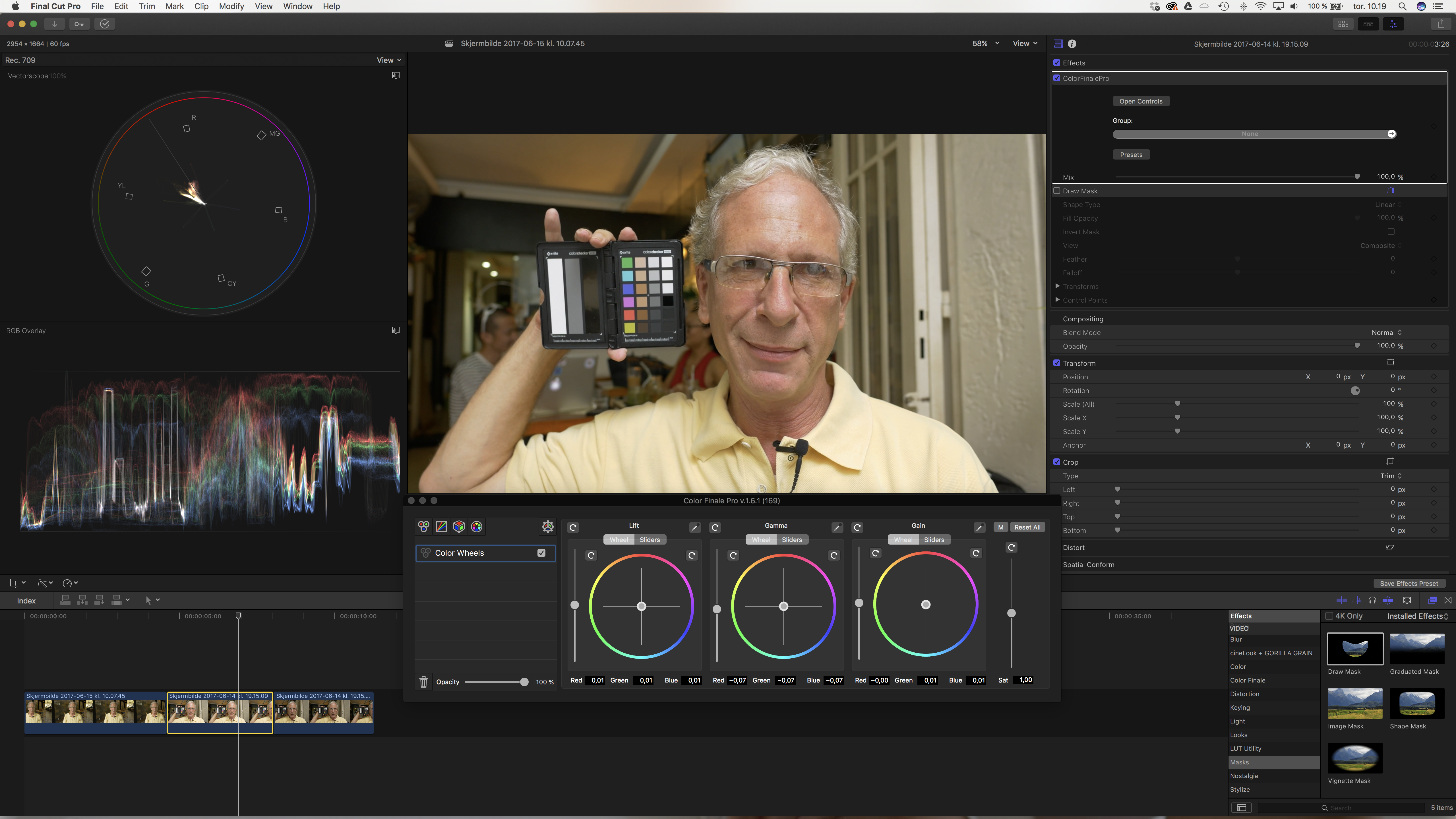

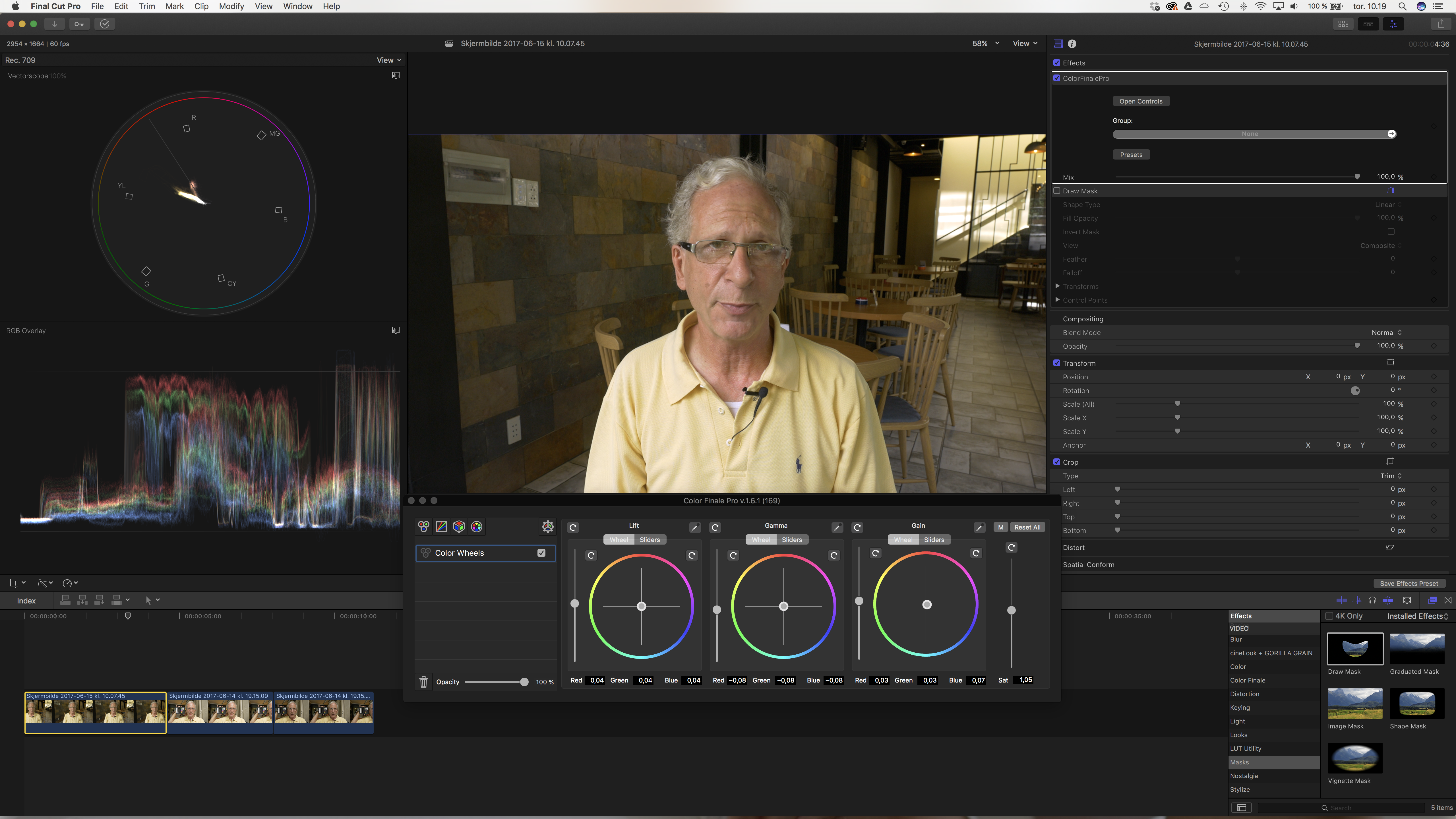

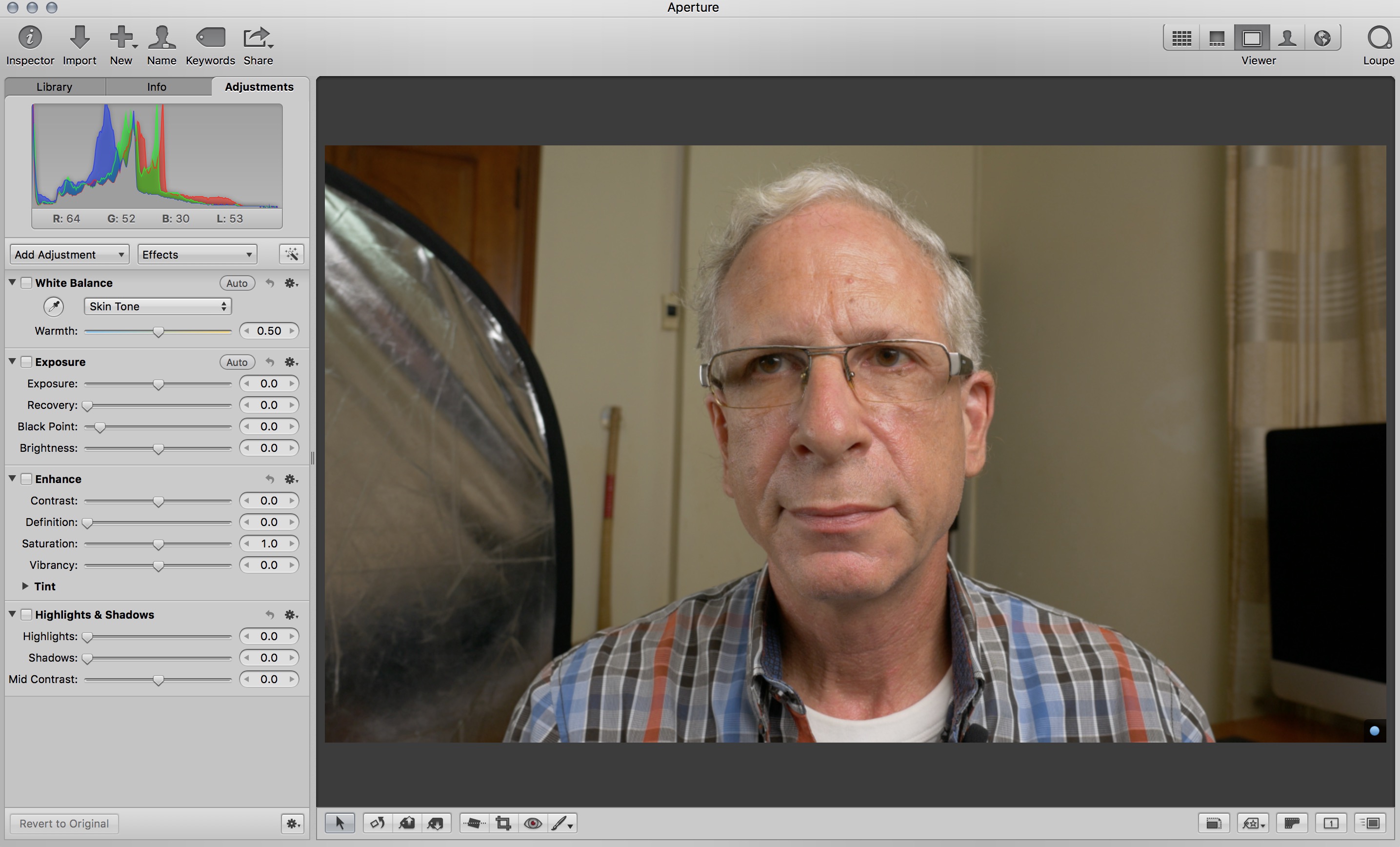

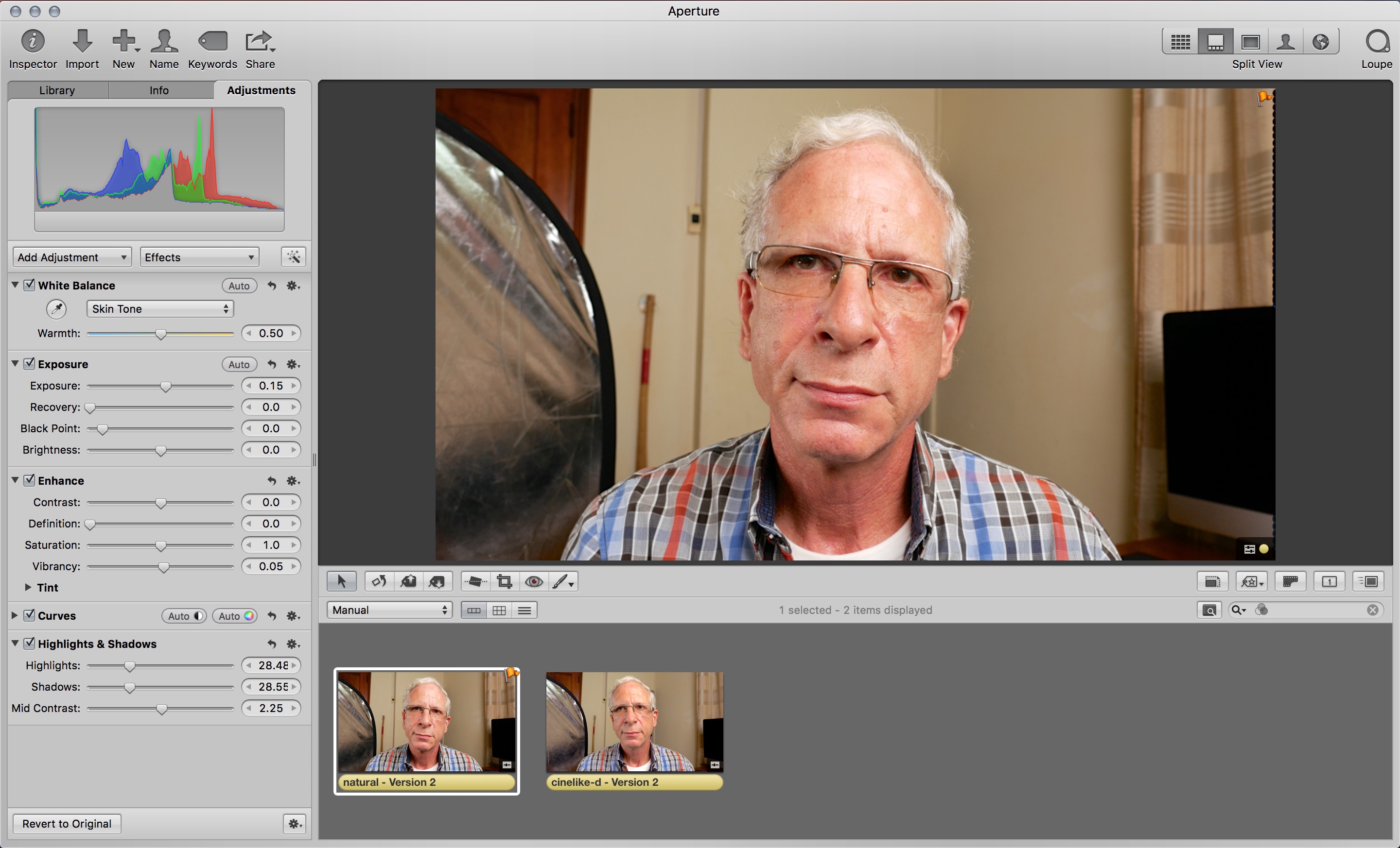

Fredrik Lyhne Posted June 15, 2017 Share Posted June 15, 2017 Here's the graded shot of the new shot which I would say is a normal exposure. With this shot and the one "ETTR"? from yesterday I had to lower the midtones, but on this shot I could also raise the highlights slightly without loosing to much detail on the shirt. I would say it's a very good exposure for skin tones, but the shirt is loosing some detail, so I think 1/3 stop less would be perfect. On the ETTR I had to lower the midtones, but can't raise the highlights more and lowering them doesn't help with the skin tones or the shirt. On the -2/3 I had to raise the highlights and because the skin tones and shirt was not overexposed it didn't affect the image in bad way. I still think this was the best overall exposure of the bunch, but the new shot from today is also good. To match the brightness of the ETTR and -2/3 I raised the highlights even more from +5 to +10 and even though it seemed to clip the red channel slightly it still look better then the other shots I think. @jagnje we're just trying to find the best exposure settings as these cameras can go from good to great if you nail the exposure. And looking at these test I would say it's worth the time and effort we put into it I understand that ETTR is the way do to it with many cameras, but these cameras seems to perform best when they are slightly underexposed. kidzrevil and jonpais 2 Link to comment Share on other sites More sharing options...

jonpais Posted June 15, 2017 Author Share Posted June 15, 2017 19 minutes ago, jagnje said: this was the last video I worked on, but I only filmed the crane bits. it is what it is...I don`t like the grade, but thats not my problem, I only film it. Nice work! So you filmed the pianist and the four singers? 21 minutes ago, Fredrik Lyhne said: Here's the graded shot of the new shot which I would say is a normal exposure. With this shot and the one "ETTR"? from yesterday I had to lower the midtones, but on this shot I could also raise the highlights slightly without loosing to much detail on the shirt. I would say it's a very good exposure for skin tones, but the shirt is loosing some detail, so I think 1/3 stop less would be perfect. On the ETTR I had to lower the midtones, but can't raise the highlights more and lowering them doesn't help with the skin tones or the shirt. On the -2/3 I had to raise the highlights and because the skin tones and shirt was not overexposed it didn't affect the image in bad way. I still think this was the best overall exposure of the bunch, but the new shot from today is also good. To match the brightness of the ETTR and -2/3 I raised the highlights even more from +5 to +10 and even though it seemed to clip the red channel slightly it still look better then the other shots I think. @jagnje we're just trying to find the best exposure settings as these cameras can go from good to great if you nail the exposure. And looking at these test I would say it's worth the time and effort we put into it I understand that ETTR is the way do to it with many cameras, but these cameras seems to perform best when they are slightly underexposed. Today I shot in a mix of tungsten and daylight, which I really enjoy. It adds a touch of warmth. I also sat back a little from the balcony, so the light wasn't as harsh as the one at the coffee shop yesterday. I agree that 1/3 of a stop less for today's shot might have been best in this situation, mostly because of the radioactive shirt I was wearing. I still believe that many are really underexposing, so I hope others join in the conversation and share their clips and screen shots of the waveform monitors so we can all benefit. Link to comment Share on other sites More sharing options...

Fredrik Lyhne Posted June 15, 2017 Share Posted June 15, 2017 3 hours ago, jonpais said: Today I shot in a mix of tungsten and daylight, which I really enjoy. It adds a touch of warmth. I also sat back a little from the balcony, so the light wasn't as harsh as the one at the coffee shop yesterday. I agree that 1/3 of a stop less for today's shot might have been best in this situation, mostly because of the radioactive shirt I was wearing. I still believe that many are really underexposing, so I hope others join in the conversation and share their clips and screen shots of the waveform monitors so we can all benefit. I tend to underexpose to much at times and that's is something I really need to get better at. It's different but the same as overexposing and very hard to make it look good in post. 2 hours ago, jonpais said: Yes, they may be 'toy' cameras, but with the right lenses, lighting, exposure and WB, they can really rock! The next hurdle for me is probably going to have to be color correction and grading. Your videos look very nice and the exposure is very consistent so I wouldn't worry about cc and grading. I only had to do very slight correction on it which to me means you're doing things very right. I think your documentary/filmic style works very well for your videos. Grading looks however is off course a whole nother chapter. jonpais 1 Link to comment Share on other sites More sharing options...

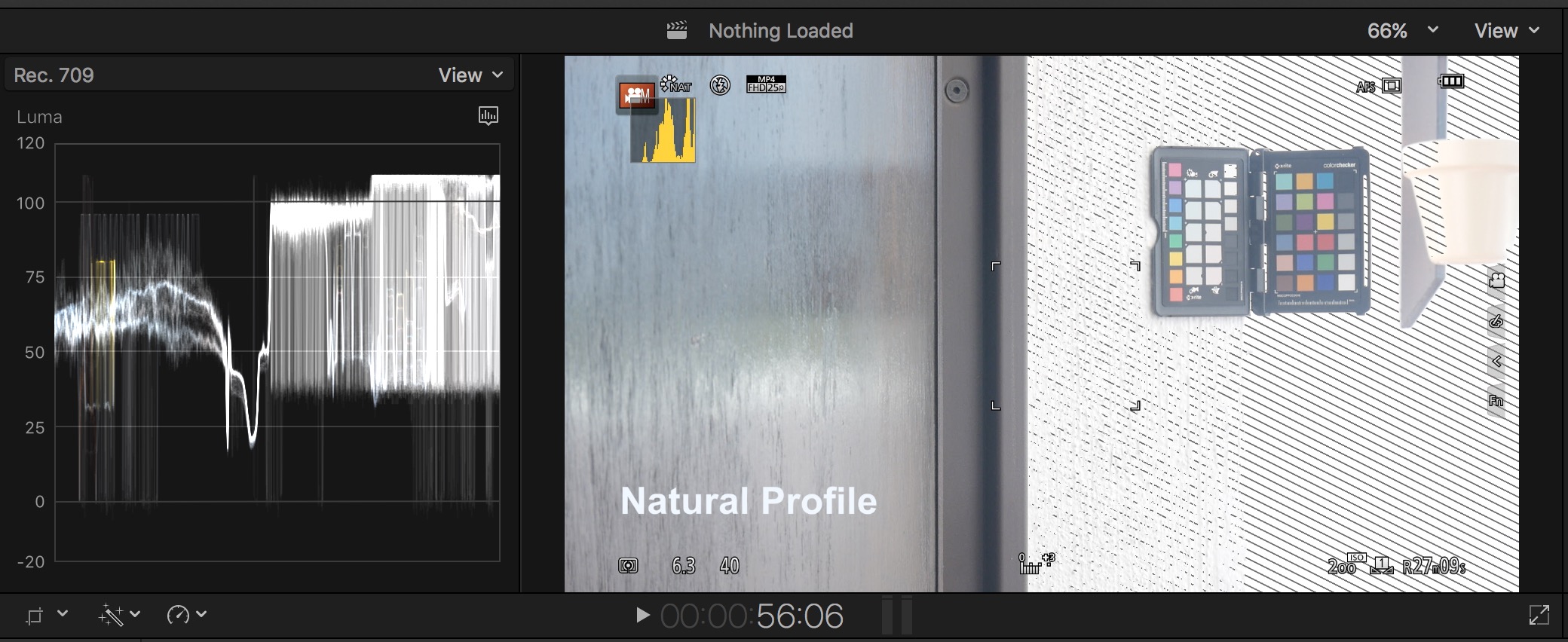

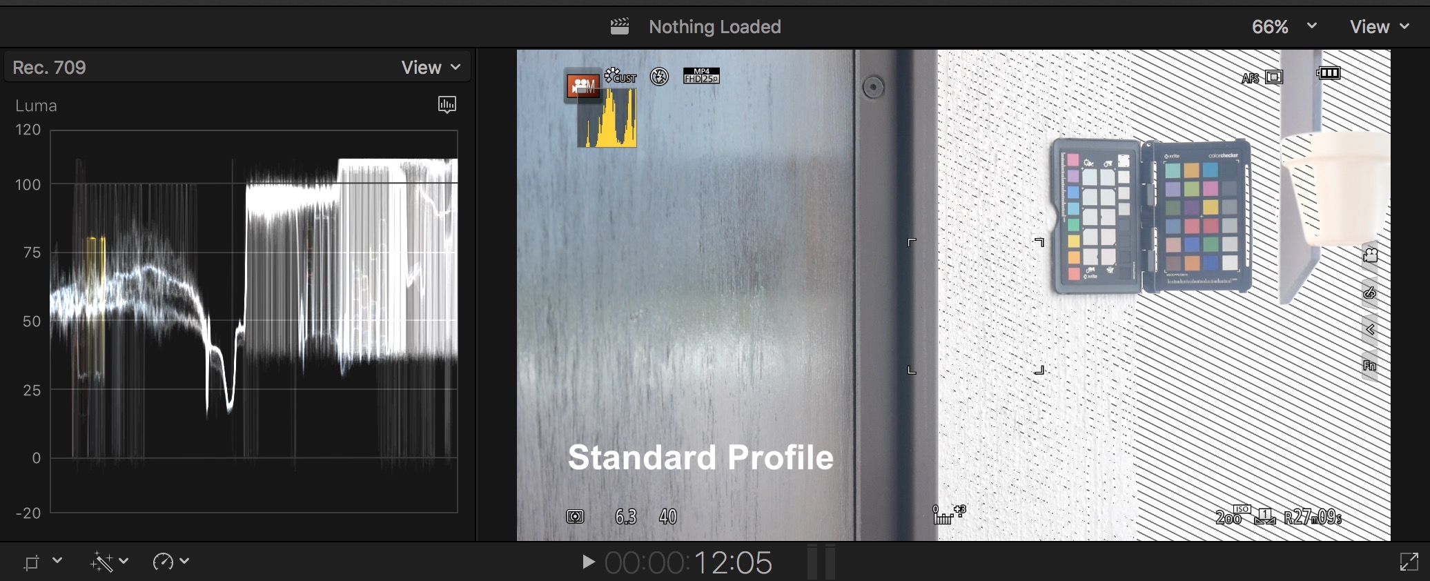

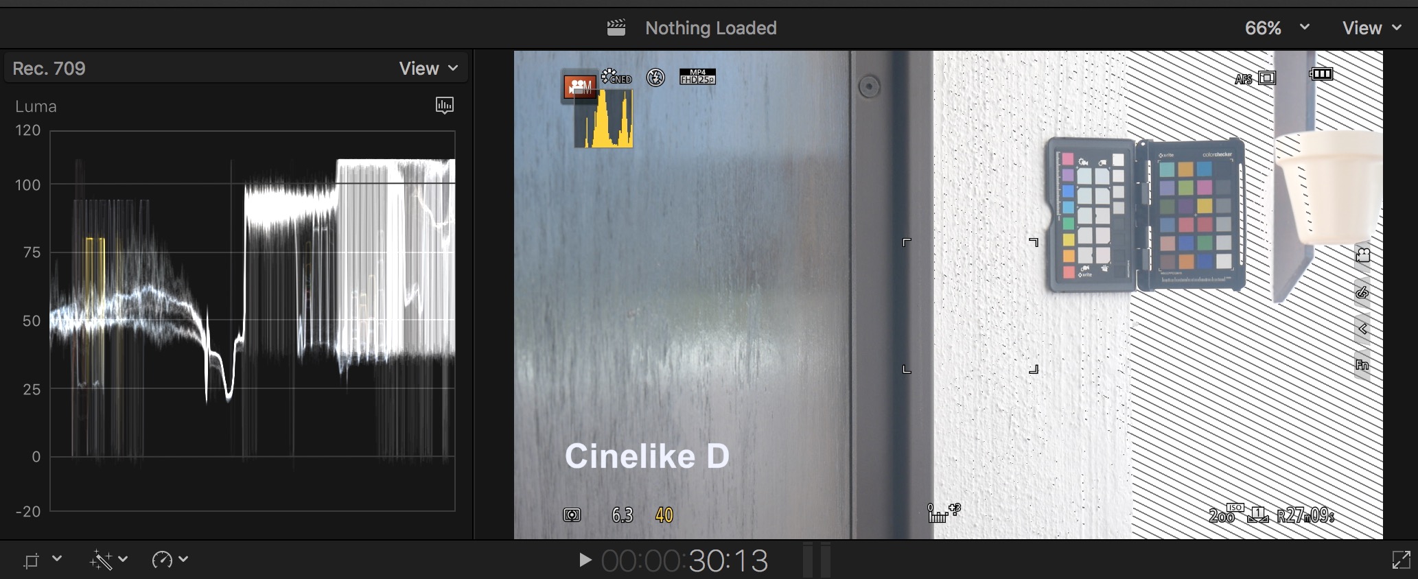

Super Members BTM_Pix Posted June 15, 2017 Super Members Share Posted June 15, 2017 Just a slightly different aspect to this but I was curious about how accurate the zebras are and how useful the histogram is with these cameras so I did a little test with the G7. I set the zebras to 100 to flash the middle column where the colour checker is stuck on and framed it so the door was in shot to see the different shadow levels with different profiles. Ignore the completely deliberately blown out right third portion of wall and sky as this is for a completely different test ! So that you could see what the camera was actually doing (and more importantly what it was saying it was doing), I recorded the output with the overlays on into a Ninja Inferno and did 3 passes using Standard, Cinelike D and Natural profiles, altering the shutter speed to change the exposure to show where the zebras came on for each. Annoyingly, I can't record the scope overlays of the Ninja Inferno as it was interesting to monitor what the camera thought was 100 and what the Ninja Inferno did. The good news is that the zebras are pretty accurate (I checked at 80, 70 and 60 as well) and you can see that reflected in the scopes in these grabs in FCPX. You can also see that Cinelike D is reducing the peak and stretching other parts of the range compared to the same exposure using the different profiles (all profiles were set to 0 for every parameter so there is more to be had from tuning but that was outside of the scope if you pardon the pun of what I was doing. What I found interesting is how there was quite a coarse change in level between the exposure combination of ISO/SS and F stop that would trip the zebras and the closest one that wouldn't, with the level going from 100 to around 92-ish. Using a variable ND, I was able to slightly tune that between the cracks as it were to eek a bit more out but if you've got the precision to be turning an ND like that all the time then you'd be better off being a safe cracker. So, the takeaway for me from doing this is that the zebras are accurate enough to use at 100 if you want to really expose to the right and the histogram is, erm, a yellow graphic. Download link for the video file if anyone wants to have a look in their own NLE is here https://mega.nz/#!ZyYCgC6R!WTM3Nz2MXfSzKtwG0hPhOBAvSqNaOq4eOnIUycnPQ3I jonpais 1 Link to comment Share on other sites More sharing options...

jonpais Posted June 15, 2017 Author Share Posted June 15, 2017 1 hour ago, BTM_Pix said: Just a slightly different aspect to this but I was curious about how accurate the zebras are and how useful the histogram is with these cameras so I did a little test with the G7. I set the zebras to 100 to flash the middle column where the colour checker is stuck on and framed it so the door was in shot to see the different shadow levels with different profiles. Ignore the completely deliberately blown out right third portion of wall and sky as this is for a completely different test ! So that you could see what the camera was actually doing (and more importantly what it was saying it was doing), I recorded the output with the overlays on into a Ninja Inferno and did 3 passes using Standard, Cinelike D and Natural profiles, altering the shutter speed to change the exposure to show where the zebras came on for each. Annoyingly, I can't record the scope overlays of the Ninja Inferno as it was interesting to monitor what the camera thought was 100 and what the Ninja Inferno did. The good news is that the zebras are pretty accurate (I checked at 80, 70 and 60 as well) and you can see that reflected in the scopes in these grabs in FCPX. You can also see that Cinelike D is reducing the peak and stretching other parts of the range compared to the same exposure using the different profiles (all profiles were set to 0 for every parameter so there is more to be had from tuning but that was outside of the scope if you pardon the pun of what I was doing. What I found interesting is how there was quite a coarse change in level between the exposure combination of ISO/SS and F stop that would trip the zebras and the closest one that wouldn't, with the level going from 100 to around 92-ish. Using a variable ND, I was able to slightly tune that between the cracks as it were to eek a bit more out but if you've got the precision to be turning an ND like that all the time then you'd be better off being a safe cracker. Download link for the video file if anyone wants to have a look in their own NLE is here https://mega.nz/#!ZyYCgC6R!WTM3Nz2MXfSzKtwG0hPhOBAvSqNaOq4eOnIUycnPQ3I Not sure I understand everything here, but after last night, I did begin to wonder just how accurate zebras actually are on these cameras, so good to know they're fairly reliable. Link to comment Share on other sites More sharing options...
Super Members BTM_Pix Posted June 15, 2017 Super Members Share Posted June 15, 2017 1 hour ago, jonpais said: Not sure I understand everything here, but after last night, I did begin to wonder just how accurate peaking actually is on these cameras, so good to know it's fairly reliable. Yeah, I was very interested in how much faith could be put in them if you wanted to really expose to the right and have them set at 100. And my takeaway is that they can largely be relied on if you want to push that far. It was also interesting, for me at least (!), to see the interaction between the profiles and the levels at the same exposure settings. Considering how coarse the histogram display is then this is a good thing What I've seen here might form the basis of a bit more testing for me at some point actually to look at the relationship with the profile, the contrast parameter within it and the additional global shadow and highlight adjusters in the camera. I think there is possibly some scope there to create profiles that incorporate all those parameters into single combination packages to create potentially finished OOC looks that I could make be deployed with a single button press. There might actually be combinations of these parameters that you'd maybe describe as non-intuitive that you look at the actual image its producing and think "You know what, that shouldn't work but I like the way that that looks". With analog synths for example, you pushed and prodded at the controls because they were there in front of you rather than having to deliberately go into menus and find them like you did with digital synths. It brought about happy accidents (as well as absolute abominations of noise) and I think it could be the same with these cameras. Its too fiddly to go in and change things in them through the menus so you become so methodical that you seldom create combinations that might just be really interesting. If all those parameters are laid out in front of you for you to twiddle with and you can see the live results of them (because you don't have to go in and out of menus) then I think that might happen. You'll probably end up with lots of rubbish but might just pan some gold. I'm quite enthused about this now and I'm going off to hack together something to do it! jonpais 1 Link to comment Share on other sites More sharing options...

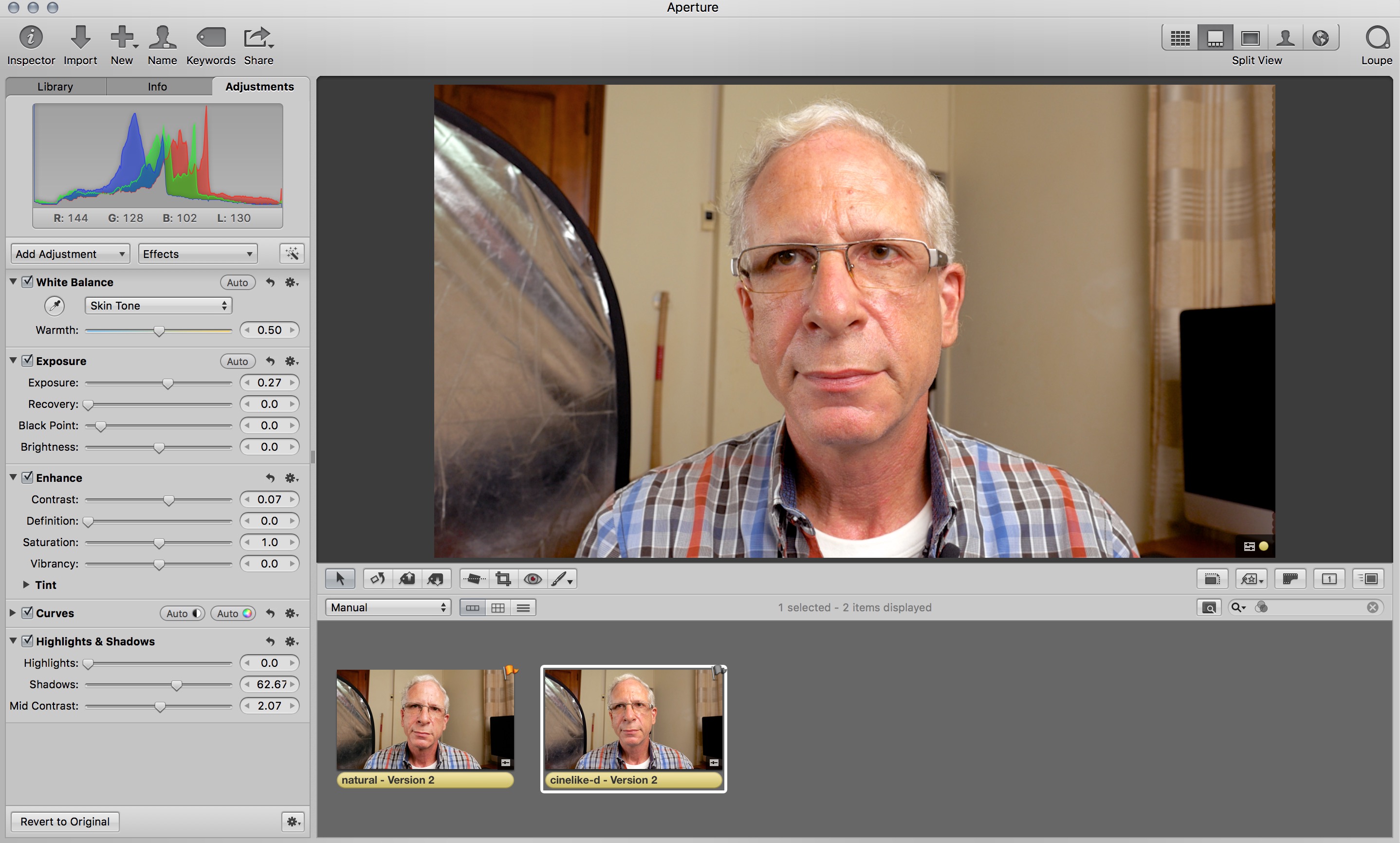

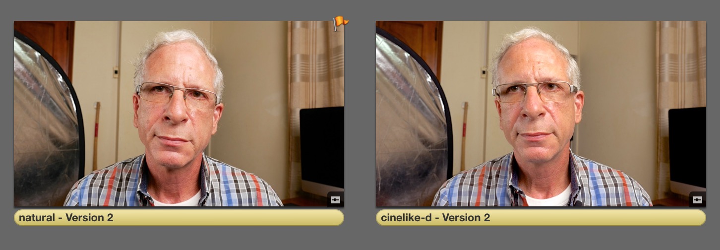

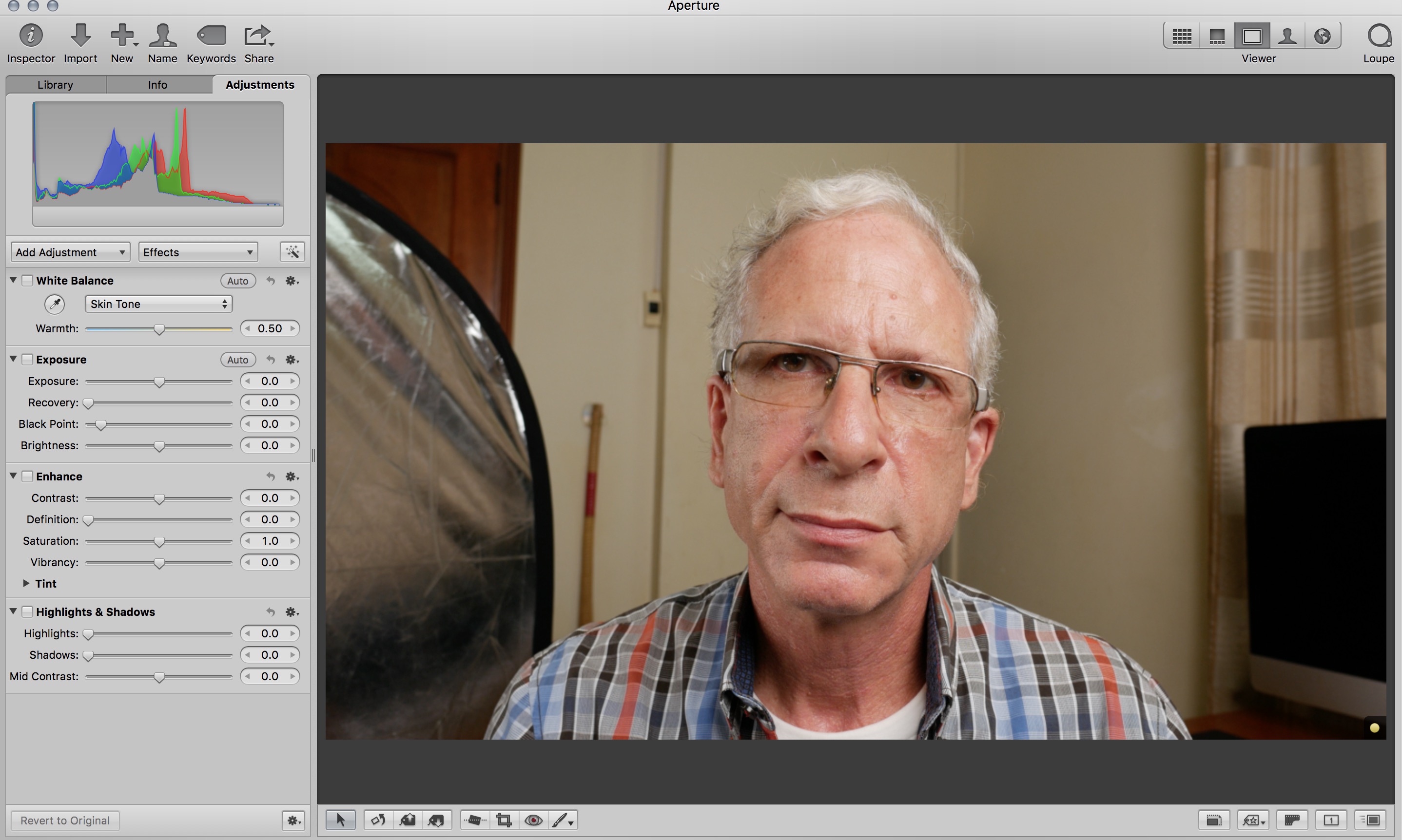

jonpais Posted June 15, 2017 Author Share Posted June 15, 2017 @BTM_Pix A few weeks back, I did a direct comparison under studio lighting between the same three profiles, and Standard and Natural were so much more contrasty than Cinelike D that if I ever were to shoot with them again, I'd probably dial exposure back, and I'm not sure ETTR would be a good idea with them. Would you mind having a look and teling me what you think? Link to comment Share on other sites More sharing options...
Super Members BTM_Pix Posted June 15, 2017 Super Members Share Posted June 15, 2017 4 minutes ago, jonpais said: @BTM_Pix A few weeks back, I did a direct comparison under studio lighting between the same three profiles, and Standard and Natural were so much more contrasty than Cinelike D that if I ever were to shoot with them again, I'd probably dial exposure back, and I'm not sure ETTR would be a good idea with them. Would you mind having a look and tell me what you think? Will do. Just let me finish prototyping this interactive picture profile creation tweaker jonpais 1 Link to comment Share on other sites More sharing options...
Super Members BTM_Pix Posted June 15, 2017 Super Members Share Posted June 15, 2017 1 hour ago, jonpais said: @BTM_Pix A few weeks back, I did a direct comparison under studio lighting between the same three profiles, and Standard and Natural were so much more contrasty than Cinelike D that if I ever were to shoot with them again, I'd probably dial exposure back, and I'm not sure ETTR would be a good idea with them. Would you mind having a look and teling me what you think? This is going to be in sections so bear with me, but loading them into Aperture, you can immediately see the distribution difference with Cinelike D and the Natural profile and this tallies with my test earlier on today. Everything is condensed more with the Cinelike D but its interesting to see how high the blue channel is and how it is almost clipping. *** NEXT PART *** So I can get them to somewhat match visually and using the starting point of Aperture's Auto Exposure function (which is actually reasonably accurate based on if you underexpose in the camera then the correction it puts on more or less always corresponds to the amount of underexposure) From that, it could be see that there was more to go with both of them but quite a bit more with the Cinelike D version. Using the Auto Enhance function (which attempts to give a half decent balance in terms of it usually lifting the shadows) there was a bit more to be had from both and both could be pushed a bit further if needed. But what was apparent was still this narrower band for the Cinelike D version which I had to tweak by adjusting the Green level and rolling off the top of the Blue channel. You can see most of the individual parameter changes for each image in the screenshots for each one. In answer to whether its better to ETTR with the other profile, I'm not sure but there was certainly a smaller margin for error as it was closer to the edge than the Cinelike D one. Is there something in the colour of the lights that was causing the raised levels in the blue channel with Cinelike D perhaps? Link to comment Share on other sites More sharing options...
