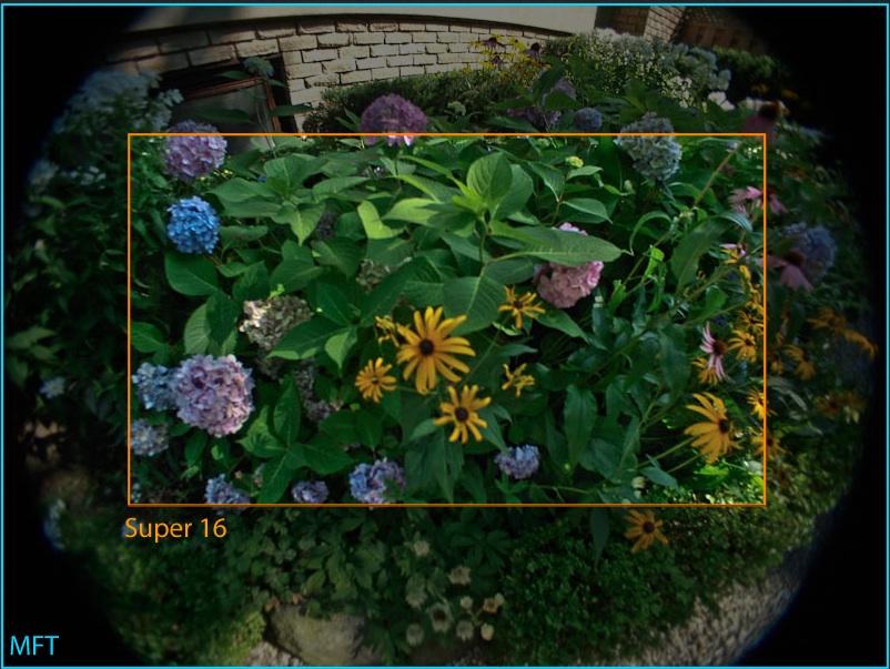

Dr. John R. Brinkley Posted October 6, 2013 Share Posted October 6, 2013 Just a personal conclusion: I've had the Blackmagic Pocket for two weeks and tested a large number of c-mount lenses from my collection on it, both classical 16mm cine lenses and cctv lenses. In all cases, I have found the c-mounts to be significantly inferior to native MFT lenses (such as the SLR Magic 12mm, the Voigtländer 25mm, but also the Panasonic 14mm and 20mm primes), even when testing top tier lenses such as the Schneider 25mm/1.4 or the Canon 13mm/1.5. Sharpness/detail is significantly lower, the image gets unsharp in the corners. The only advantage I see in those lenses is their compact size. In some cases, they can be used as speciality lenses (the Ernitec 6.5mm/1.8 as a fix focus fisheye, or a VT 8mm as a psychedelic wide angle with heavy vignetting and color casts); the 16mm/2.0 Tevidon is a decent performer with constant sharpness across the frame, but surely not as a good as an Olympus 17mm/1.8 or Samyang/Rokinon 16mm/2.0. Unlike on the GH2, vintage glass doesn't look good on the Blackmagic Pocket. Since the BM Pocket gives an uncooked, non-artificially sharpened image with true organic color depth, it looks best with a good lens. A bad lens just looks bad. Can you give more thoughts on the Panny 14mm? This is the one MFT lens I'm considering buying for the Pocket. Link to comment Share on other sites More sharing options...

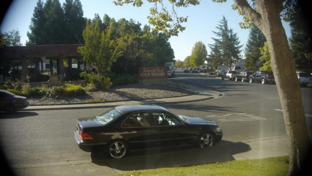

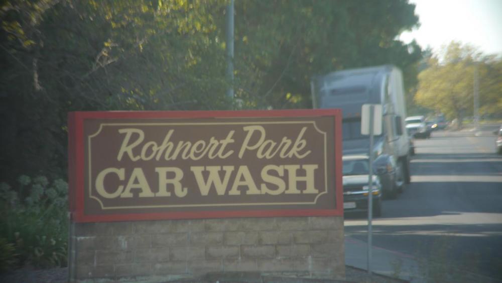

kazkioken Posted October 15, 2013 Share Posted October 15, 2013 Kowa LM6HC 6mm f1.8 I've already posted these on bmcuser but just adding to the archive since this is a very popular thread. Nice to find a true wide angle option that doesn't heavily distort and is fast too. This Kowa lens is great find, it's a machine lens and only closes up to f11 and focuses to about an inch. Here are two tests to show it in various situations: Also have two tests for the Switar 16mm and the Schneider Cinegon 10mm in that album - and I believe both have already been confirmed to work perfectly on the pocket previously in this thread. Link to comment Share on other sites More sharing options...

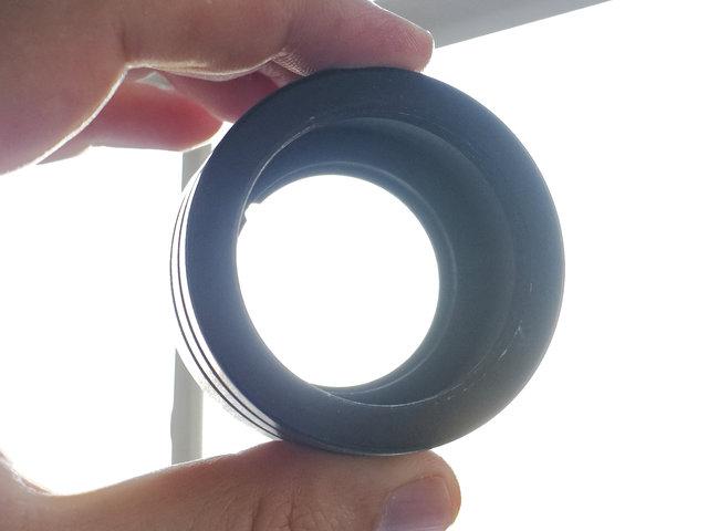

Niverik2k Posted October 30, 2013 Share Posted October 30, 2013 Has anyone used the Kowa LM8HC, earlier there was mention of modifications being needed to make it work, does anyone know exactly what modifications must be made? Link to comment Share on other sites More sharing options...
grierdill Posted October 30, 2013 Share Posted October 30, 2013 Here's the Kowa 8mm modification: Link to comment Share on other sites More sharing options...

Jacek Posted November 14, 2013 Share Posted November 14, 2013 Has anyone used the Kowa LM8HC, earlier there was mention of modifications being needed to make it work, does anyone know exactly what modifications must be made? Better wait for Kowa to modify it for You: http://www.eoshd.com/comments/topic/3851-kowa-announced-m43-cine-lenses-85t30-12t19-16t16/ Link to comment Share on other sites More sharing options...
