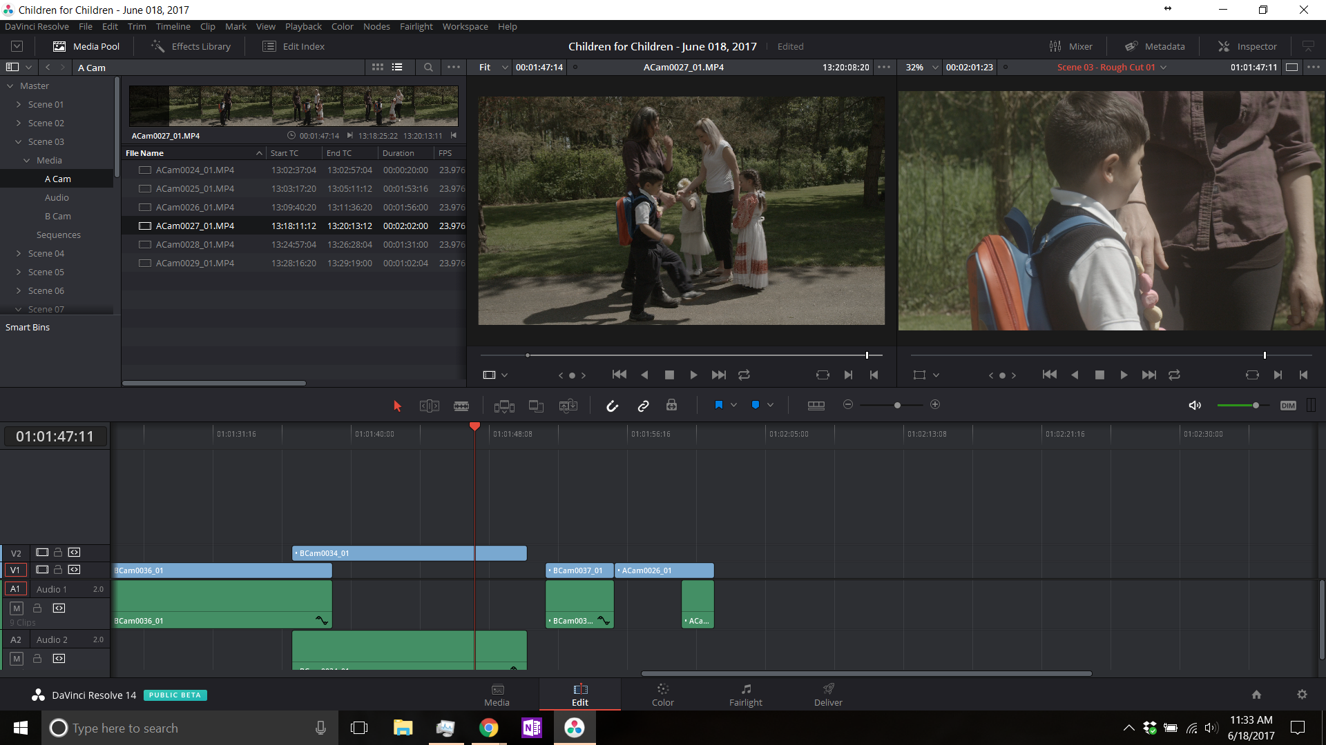

Good morning! Starting my day editing a kids' teaser at a far too noisy coffeeshop.....joys of working on the road. Screenshot for kicks.
