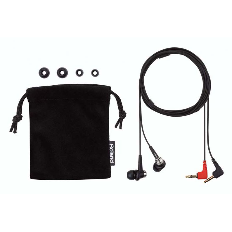

Super Members BTM_Pix Posted June 23, 2017 Super Members Share Posted June 23, 2017 This is a bit of an alternative to consider - and the big caveat here is that you've stated you will use lav mics for key audio elements - so is based on you needing something discrete for general wide field capture on camera. I'll do a specific thread about these at some point but the Roland CS-10EM binaural microphone/headphone system is something that could well be worth a look. Not only do they provide a very interesting and immersive stereo recording but as they just look like regular earbud headphones they are incredibly discreet and of course completely non-threatening. They have foam shields which are essential outdoors but, again, they don't look out of place. You could modify deadcat material to them and just pass it off as excessive ear hair if you are of a certain age such as myself They are the sort of thing you'd have to demo to make sure that they were right for you but I think they might just work for what you're describing, particularly if its for social event coverage. https://www.amazon.co.uk/ROLAND-CS-10EM-Roland/dp/B003QGPCTE UncleBobsPhotography 1 Link to comment Share on other sites More sharing options...
quivering_member Posted June 23, 2017 Share Posted June 23, 2017 I built my own system out of some electret capsules and earplugs similar to that Roland CS-10EM kit which I use to stealthily bootleg live music. It works really nicely, captures a realistic mbience which sounds especially great on headphones. Obviously it's not very directional so if there's lots of ambient noise and you're trying to record someone speaking it won't work too well. Basically it'll capture exactly what you would hear and nothing more. Link to comment Share on other sites More sharing options...
