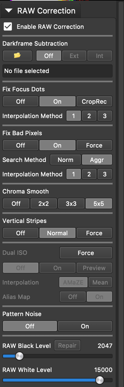

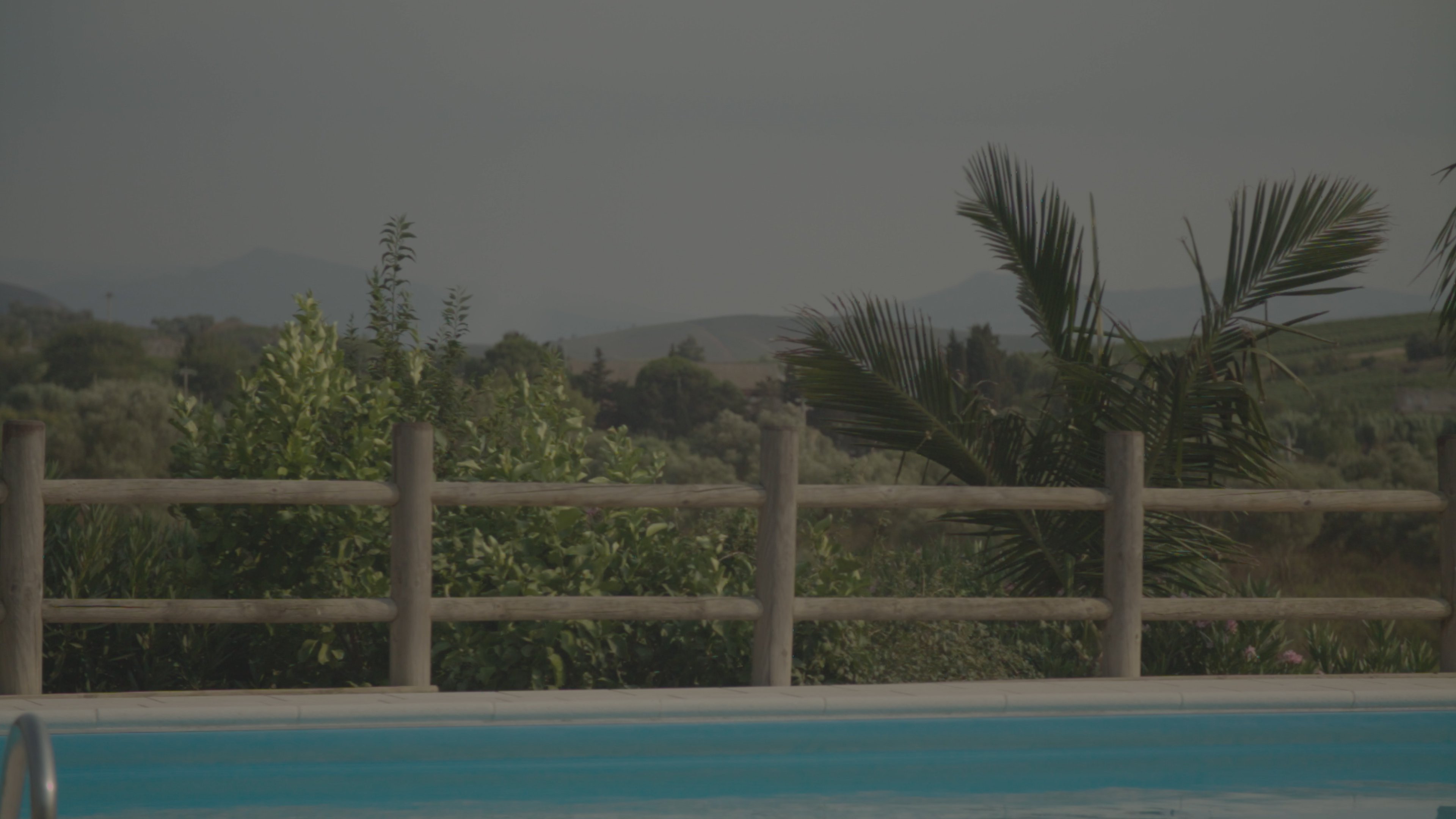

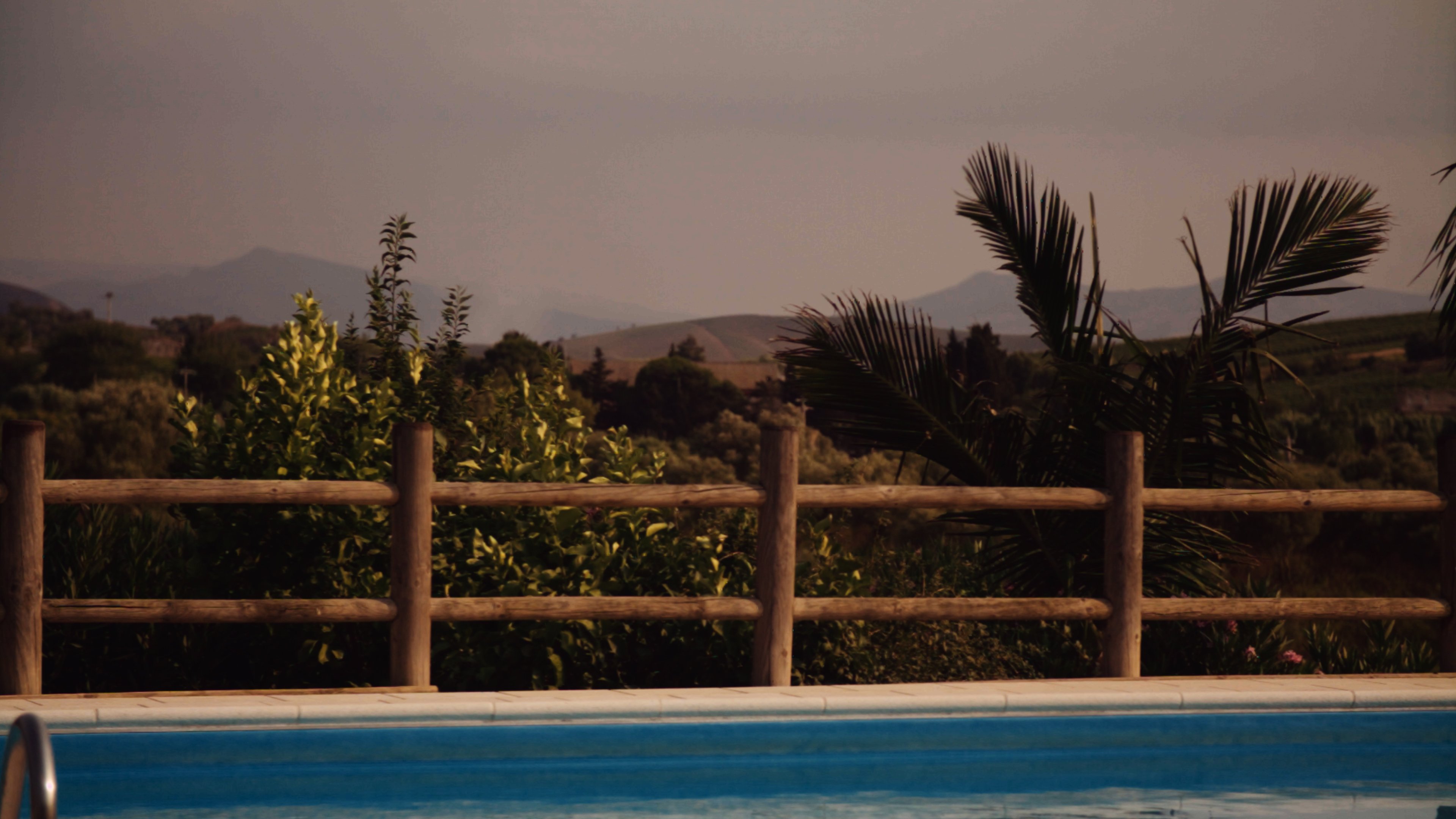

Anaconda_ Posted September 11, 2019 Share Posted September 11, 2019 I recently filmed a vacation video with my EOSm and enjoyed it, but now I'm home and I've noticed a whole load of banding all over my footage. I've never seen it in other things I've filmed with the camera, and I don't feel like I've pushed the grade any more than normal, and I'm having a hard time getting rid of it. In fact, you can see it in the ungraded screengrab! I've attached some screen grabs to show you what I mean. WORKFLOW: 1080p rewire 25p (I think 12bit) Use MLVapp to do minor adjustment and convert to Arri Logc then export as ProRes. I also bring it up to 4k from MLVapp. If it helps, here's my settings in MLVApp: Link to comment Share on other sites More sharing options...

Anaconda_ Posted September 13, 2019 Share Posted September 13, 2019 9 hours ago, Brian Williams said: This is also properly scaled? Last time I used it it was either choppy/B&W (but properly scaled) or smooth/color (but cropped in, and not even center cropped at that). This has improved? 1080 MCM Rewire is properly scaled, realtime in colour. Any higher resolutions have choppy B&W or cropped view on the LCD. For me, it's too difficult to use and trust the outcome. Update to my banding issue above. In MLVApp, I switched from Arri Log-c to Film and that fixed my problem... I then used @ZEEK rec709 to Logc lut in MLVApp to convert it back to the log(ish) footage that I wanted in the first place. Thanks for the LUT! Link to comment Share on other sites More sharing options...
