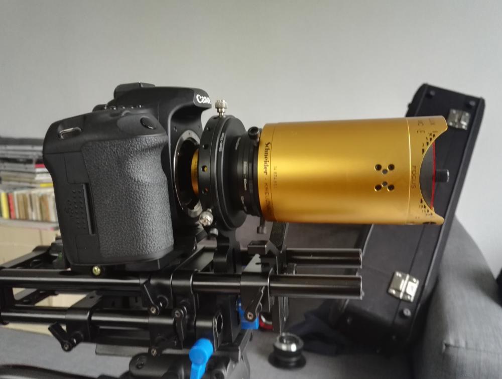

Justin Bacle Posted June 26, 2017 Share Posted June 26, 2017 I did try it, you can attach it with a M42 adapter, M42 reverse ring, M42 Helicoid and Step up/down rings with a clamp. You need the helicoid to be able to focus the system. The only problem being that the "taking" lens is usually arount 75 or 90mm which isn't wide enough IMO. Here is a picture of the system (with a single focus solution) that I tried the idea with : https://goo.gl/photos/a5uBojn7vj2bR2HV6 Do try it, it is quite a fun experience Juank 1 Link to comment Share on other sites More sharing options...
