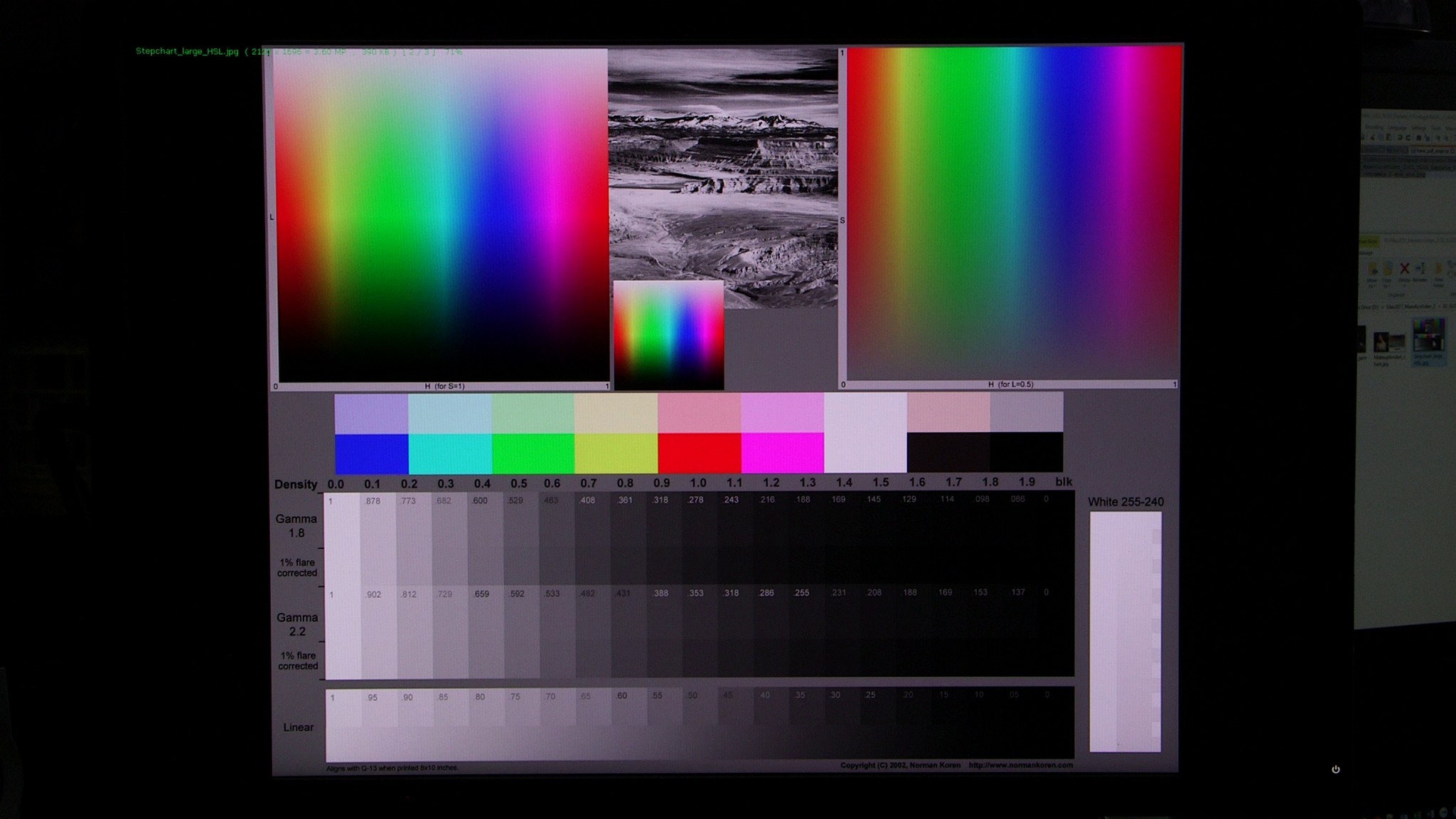

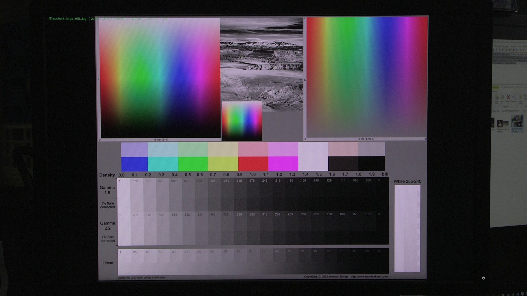

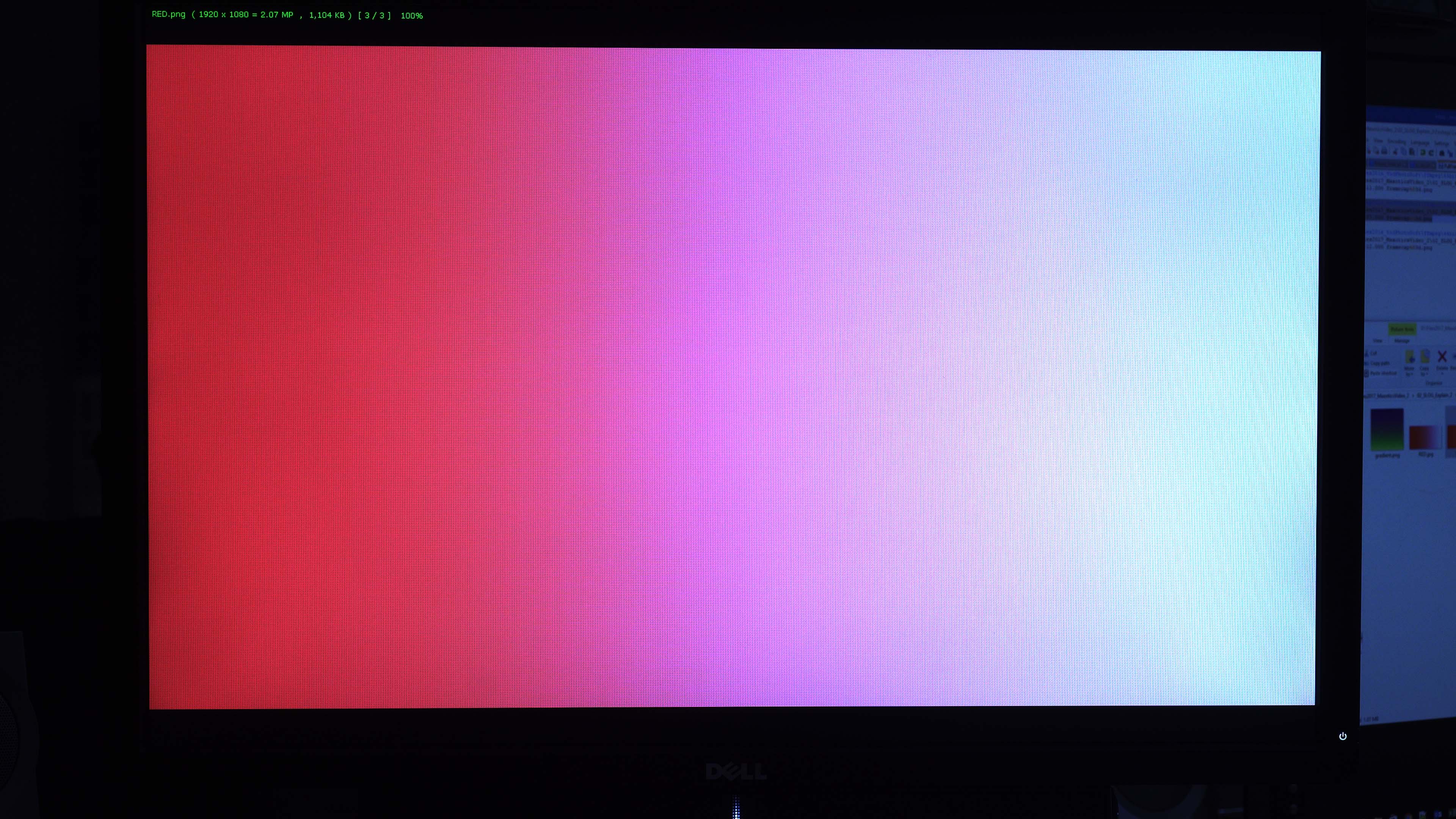

EthanAlexander Posted July 18, 2017 Share Posted July 18, 2017 1 hour ago, maxotics said: Here are four screen captures from a Canon C100. You're shooting something on a monitor that already has it's own limited dynamic range and color representation, so I don't see how this is helpful... Am I wrong that this would be biased? Link to comment Share on other sites More sharing options...

maxotics Posted July 18, 2017 Author Share Posted July 18, 2017 11 minutes ago, EthanAlexander said: You're shooting something on a monitor that already has it's own limited dynamic range and color representation, so I don't see how this is helpful... Am I wrong that this would be biased? Thanks for the question. Yes, it is biased towards the display's DR. My reasoning is that the viewer only experiences the world through a display (which is probably of less quality than mine). Therefore, we should expect the camera to be able to record whatever is displayed on the monitor. My test won't be to see how much of the monitor's limited dynamic range the camera can record (it will be less for a variety of reasons), but what the difference is in fidelity between the camera's default settings and a LOG profile. If that simple initial test holds true, if I shot both standard profile and Cinema in my office I should expect a 35% color loss from the Cinema profile. Again, I understand what many have pointed out, that most people would NOT shoot LOG in my office. One of my goals is to quantify the quality loss of LOG profiles in standard DR situations. In order to do that, I need to capture the whole 24-bit color space, which so far, is going to be 32 screens of 1920x1080 colors, where each color will get 4 pixels. Make sense? Link to comment Share on other sites More sharing options...

cantsin Posted July 18, 2017 Share Posted July 18, 2017 13 minutes ago, maxotics said: Thanks for the question. Yes, it is biased towards the display's DR. My reasoning is that the viewer only experiences the world through a display (which is probably of less quality than mine). Therefore, we should expect the camera to be able to record whatever is displayed on the monitor. My test won't be to see how much of the monitor's limited dynamic range the camera can record (it will be less for a variety of reasons), but what the difference is in fidelity between the camera's default settings and a LOG profile. If that simple initial test holds true, if I shot both standard profile and Cinema in my office I should expect a 35% color loss from the Cinema profile. Again, I understand what many have pointed out, that most people would NOT shoot LOG in my office. One of my goals is to quantify the quality loss of LOG profiles in standard DR situations. In order to do that, I need to capture the whole 24-bit color space, which so far, is going to be 32 screens of 1920x1080 colors, where each color will get 4 pixels. Make sense? No, because this mixes up display dynamic range with scene dynamic range. When we speak of the dynamic range a camera can record, we refer to scene dynamic range: For example, 14 stops from shadows to highlights in an outdoor daylight scene you record. A typical, good computer monitor has a contrast ratio of 1:1000, that's 10 stops (2^10=1024). What we do in video postproduction is to compress those 14 stops you recorded outdoors into the 10 stops of your monitor, or, in the case of 8bit Rec709/8bit RGB, the mere 8 stops supported by this display and color standard. In other words, we align the brightest stops of the motive with the brightest stops of the display, the lowest with the lowest, and the medium is where our gamma sits. So we'll roughly end up mapping stops 11-12 of the scene to stop 8 of the display, stops 9-10 to stop 7, stop 7-8 to stop 6, stop 6 to stop 5, stop 5 to 4 etc. all the way down to stop 1-2 to stop 1. That's exactly what a Log-to-Rec709 LUT will do. If the camera sensor dynamic range were identical to that of the display, or if we would only record within the same dynamic range as the scene, the highlights of the scene would clip and the shadows would be black. - If I'm not mistaken, you're caught in math trap where you base all your assumptions on the fact that the human eye can see about 16 million colors and that an 8bit true color display displays 16 million colors, too. So why do we need more than those 16 million colors? Because this number doesn't take into account the adaptation of the human eye (in combination with the brain). While the human eye can physically only see about 7 stops, it adjusts its iris so quickly (and we usually scan a scene with our eyes going from shadows to highlight) that our brain effectively "sees" a higher dynamic range. Link to comment Share on other sites More sharing options...
