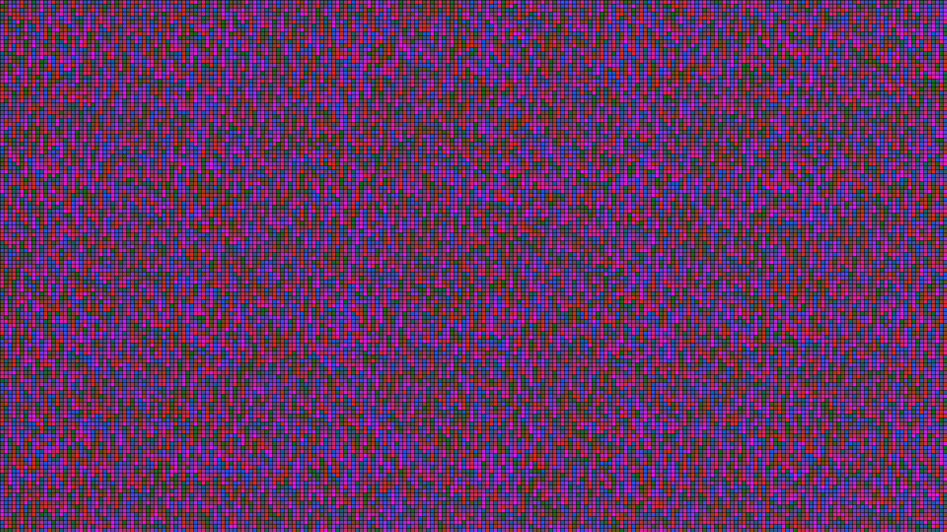

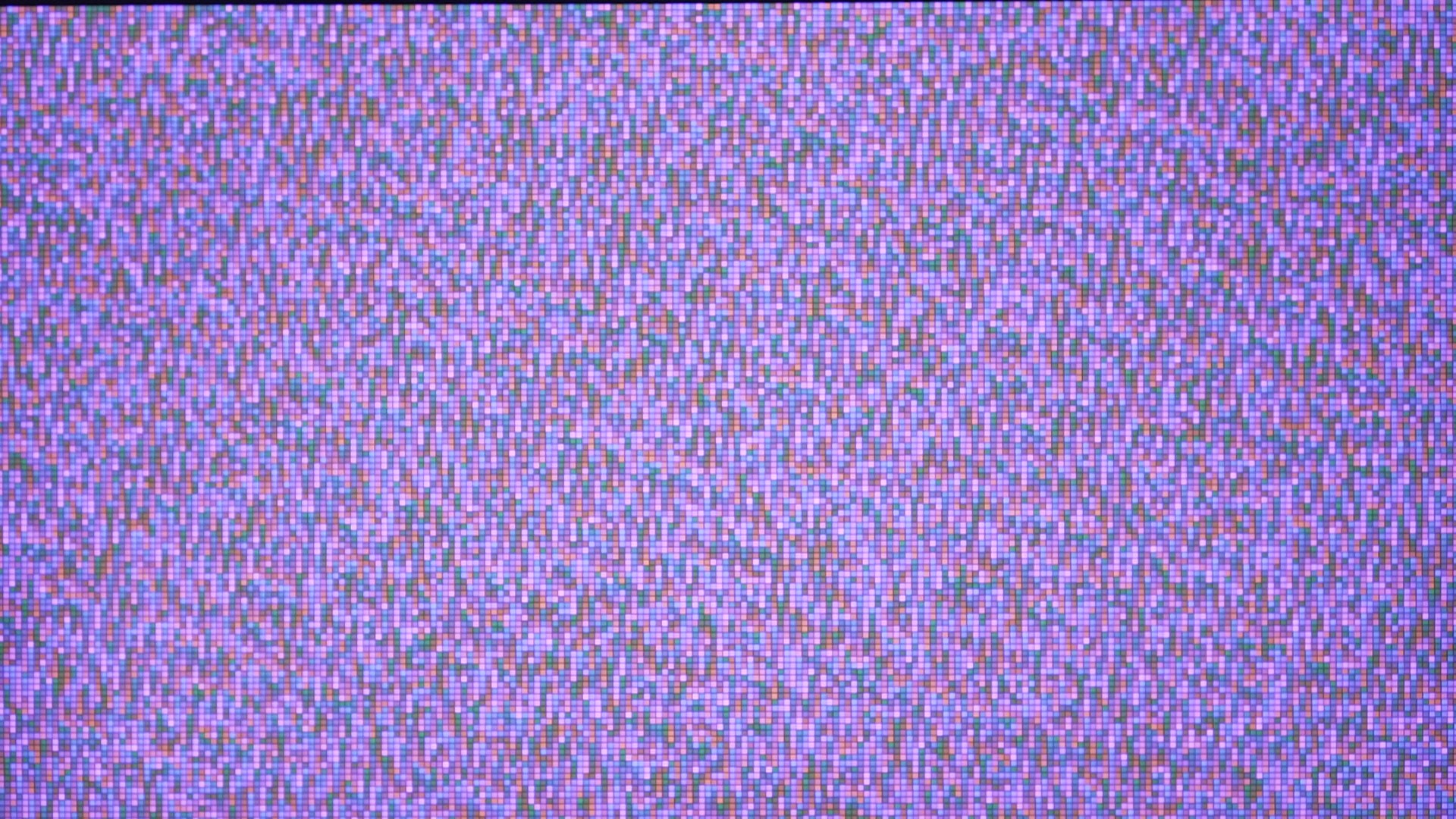

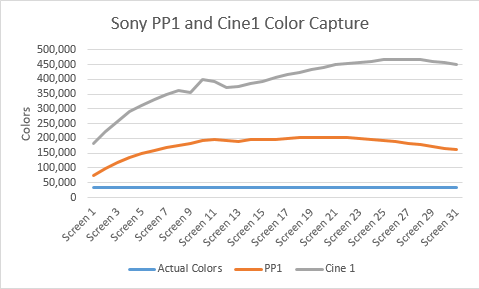

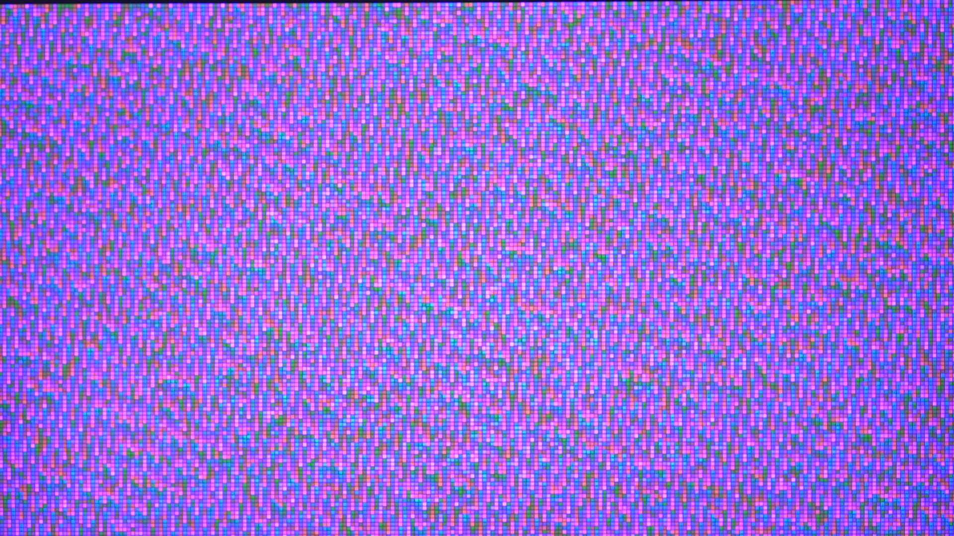

maxotics Posted July 20, 2017 Author Share Posted July 20, 2017 5 hours ago, Bioskop.Inc said: You can, and considering the topic at hand, should add a colour chart to the test - but if you do this White Balance the camera to the white piece of card (with BM cameras you'll need to test the various WB presets). You should also try to make sure the Black card is as black as possible - "The black card should be as black as possible, some people create a recessed box lined in black velvet". First, Bioskop and CPC thanks for joining the conversation. Because of the way LOG extends ISO I've never doubted for a second that there's be more noise in the image. "add[ing] a colour chart to the test" is exactly what I've been trying to do. First I used one-shot charts where I noticed that aggressive LOG recording gammas reduced the pre-grading color palette by a very large amount. The gentler LOGs are another story. Some people in the thread believe the LOG method of capturing color improves perceptual image quality, even if there is data loss compared to the "linear" profile. In the end, they may be right! But I want to see for myself through some tests In order to test the color issue in more depth (AGAIN THANK YOU BIOSKOP for recognizing this should be a TO DO for anyone interested in this subject) I set up to compare how different gamma settings will capture all 16 million colors (assuming the camera is 8-bit). First, I sliced apart full RGB images which you can get here https://allrgb.com/. Here's a comparison of capturing part of this image on a monitor in EOS Cinema on the C100 (letting PS auto grad) Now with EOS standard If I'm just using my eye, I can't see much "artistic" difference between EOS std and Cinema. So I can see how, in the "real world", filmmakers like @Oliver Daniel find this subject too technical because the differences aren't great enough to effect the final product. I then wanted more control over the colors. So wrote some Python/PIL scripts to generate 32 1920x1080 frame of all colors (4 pixels a color) where the colors are sorted by luminosity because what I really want to know is where in the DR LOG shooting plays games, so to speak. Unfortunately, the aliasing issues of shooting RGB screens with RGB sensors have set me back. There are too many artificial colors and noise for me to get at what I want. Here's a graph of the screens and shooting with the A6300 in PP1 and PP5 The original BMP of 32,410 colors. 32 frames of these are captured, 5 seconds a piece, by the A6300 PP1 PP5 The data suggests that PP5, or Cine 1, is capturing more color than Sony's PP1, which is pretty close to its standard profile (I believe). So is @cantsin correct? Is there an improvement of color using a LOG profile? I still don't know. Because both captures are recording more colors than the screen is meaning to display (it should create only 32,401 colors in our eye), due to re-mixing of RGB values, I can't tell which colors each gamma recording is getting from the proper RGB mixes, and which are essentially false aliasing colors. To my eye, Cine 1 is loosing color fidelity, but I can't prove it with the data I have. To continue, I will need to created larger, probably 1-inch blocks of color on the monitor and average down to a hopefully noise-insignificant value. I'll also need to program stuff to put that data in a database and compare displayed color to captured. Don't know if I'm going to continue here. That method will need hours of capture time (to go through the screens of color) The really shrewd here might know what I could do, IF I could do this, so that is some motivation. We'll just have to see. Oliver Daniel 1 Link to comment Share on other sites More sharing options...
