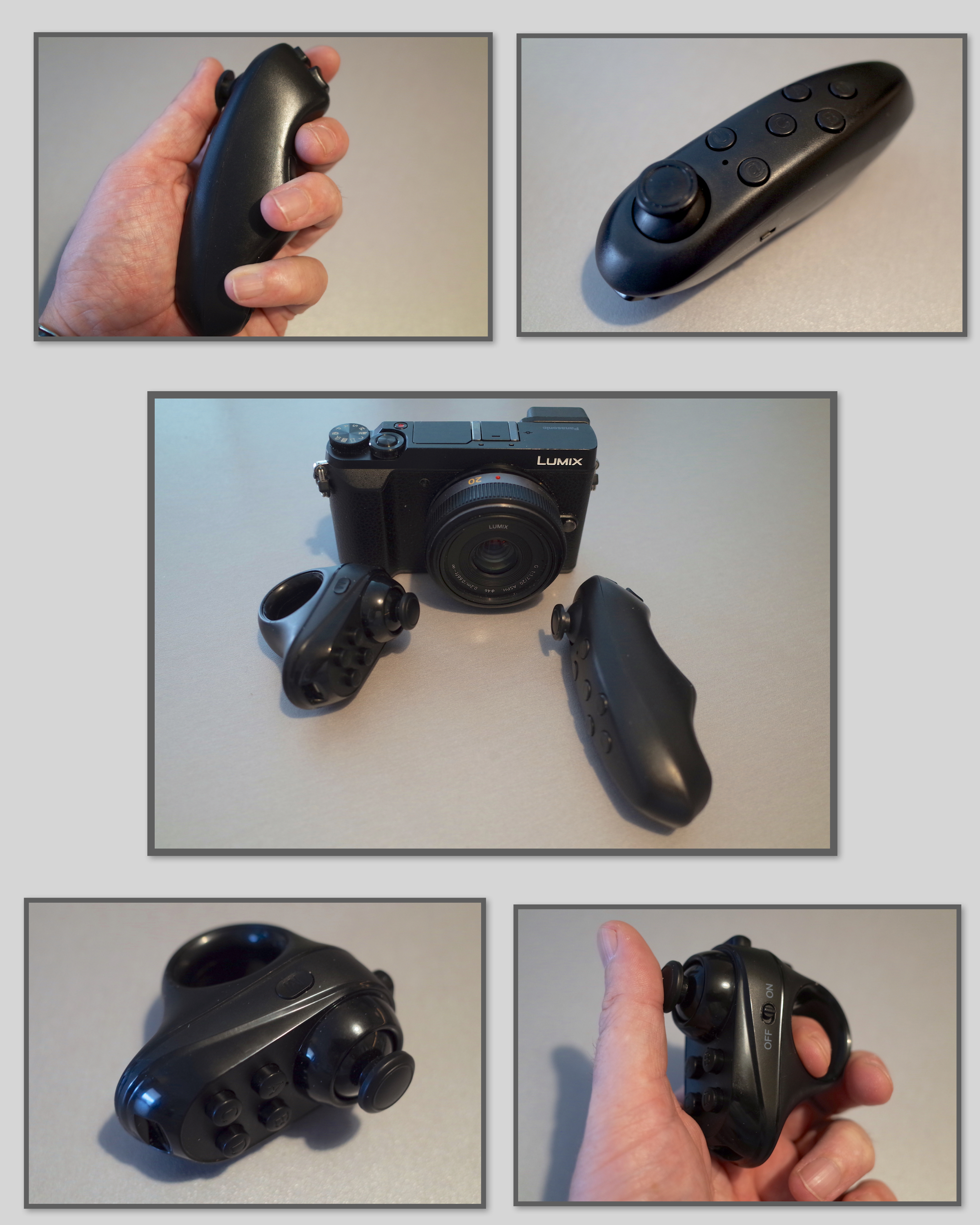

Super Members BTM_Pix Posted July 7, 2017 Super Members Share Posted July 7, 2017 As per the other thread, the functionality of the controller is now pretty far along and nearing completion so its time to finalise the actual input device itself. The two options are shown here (with a GX80 to show scale). How this will work is that a small module speaks to the camera over wifi to do the actual commands and it will receive its input from one of these devices, both of which are bluetooth. And cheap. They both have a combination of buttons and a joystick but the main difference between them is that the joystick on the larger one is analogue so can be used to progressively drive focus speed whereas the smaller one's joystick is a digital affair. This doesn't rule it out for progressive control just that it makes it a bit more work to fake it. The other difference of course is the form factor. The smaller one is quite neat having that hole in it as you can use it like I've done there with your thumb through it or, depending upon the width of it, mounted on a tripod pan handle. The larger one benefits from having the indented grip so its six of one and half a dozen of the other really. With both of them though, a bit of superglue and a thread adapter will have you being able to mount them on anything you want to. PannySVHS 1 Link to comment Share on other sites More sharing options...
Super Members BTM_Pix Posted July 7, 2017 Author Super Members Share Posted July 7, 2017 And if you're looking at that picture thinking "Thumb? What sort of freak hands has he got if that's his thumb going through the hole" I, of course, meant index finger. Link to comment Share on other sites More sharing options...

Super Members BTM_Pix Posted July 7, 2017 Author Super Members Share Posted July 7, 2017 4 minutes ago, robbino said: Although I would like the big one, I would also really like the full blown midi version (not an option for that in the poll ). Looking forward to trying this out To be honest, there'll be a version for that too as its just a remap exercise. Bit trickier in terms of getting one that has the right combination of switches, pots and faders and also that is a) readily available (these things drop on and off the market) b) a reasonable price and c) compact. The target price for people to pay to source all the stuff is less than £40 and the bluetooth ones fit that perfectly. The middle ground is an XBOX type controller that I've sourced which has nicer sticks (two of them) and might be more appropriate size wise with bigger cameras like GH5. There won't be anything stopping people having both though so they can use the bluetooth ones for stealthier setups and the XBOX type one if they're using a rig etc. robbino 1 Link to comment Share on other sites More sharing options...
