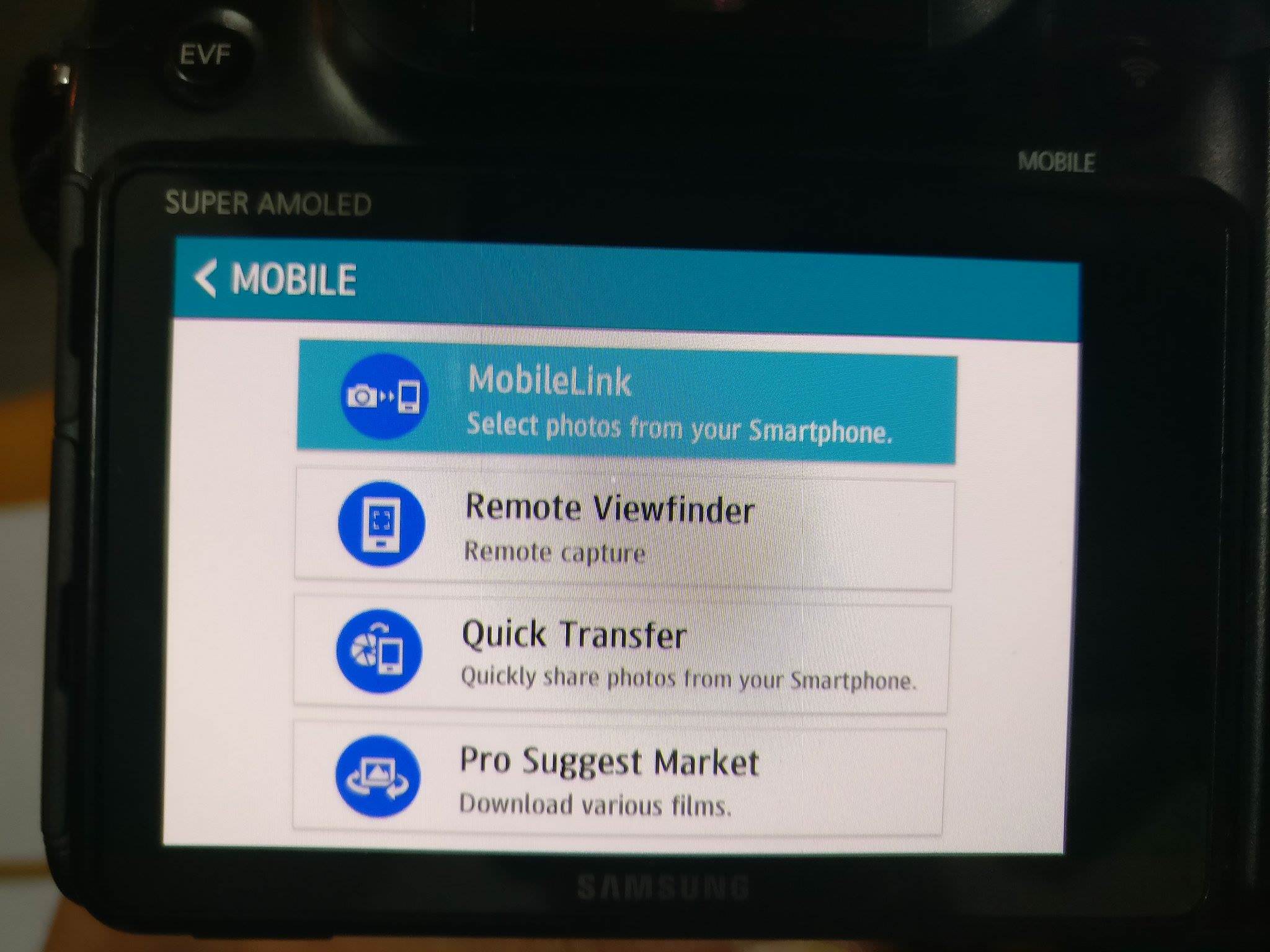

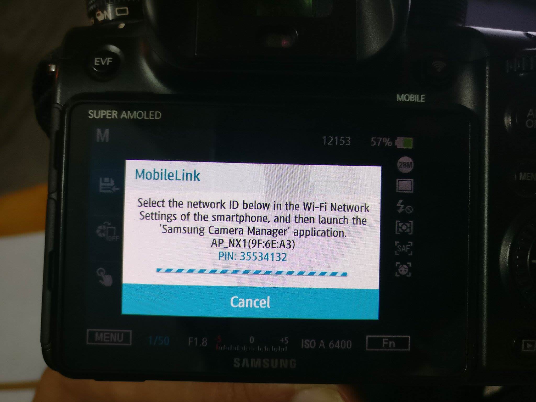

SR Posted July 13, 2017 Share Posted July 13, 2017 My NX1 (with firmware v.1.41) recently went crazy after being synced to my iPad with the latest update. (Wish I'd stuck to Android, it was working fine). To sync it to the iPad, it turned out to be a little different from syncing to my android phone. I had to hold the Wifi button for a few seconds (with a sensible amount of force) before letting go, which turned on the wifi (2nd image). Everything seemed fine and sync'ed but then that's when it went funky: the MoblieLink menu (1st image) kept coming up every few seconds (sometimes it'd go nuts and come up once a second). The frequency varies. And sometimes it starts connecting to wifi (2nd image) too. So this has become incredibly disruptive when I'm taking photos. I've tried reinstalling the firmware, resetting completely thrice through the menu. Nothing's worked. Can anyone help? Link to comment Share on other sites More sharing options...
