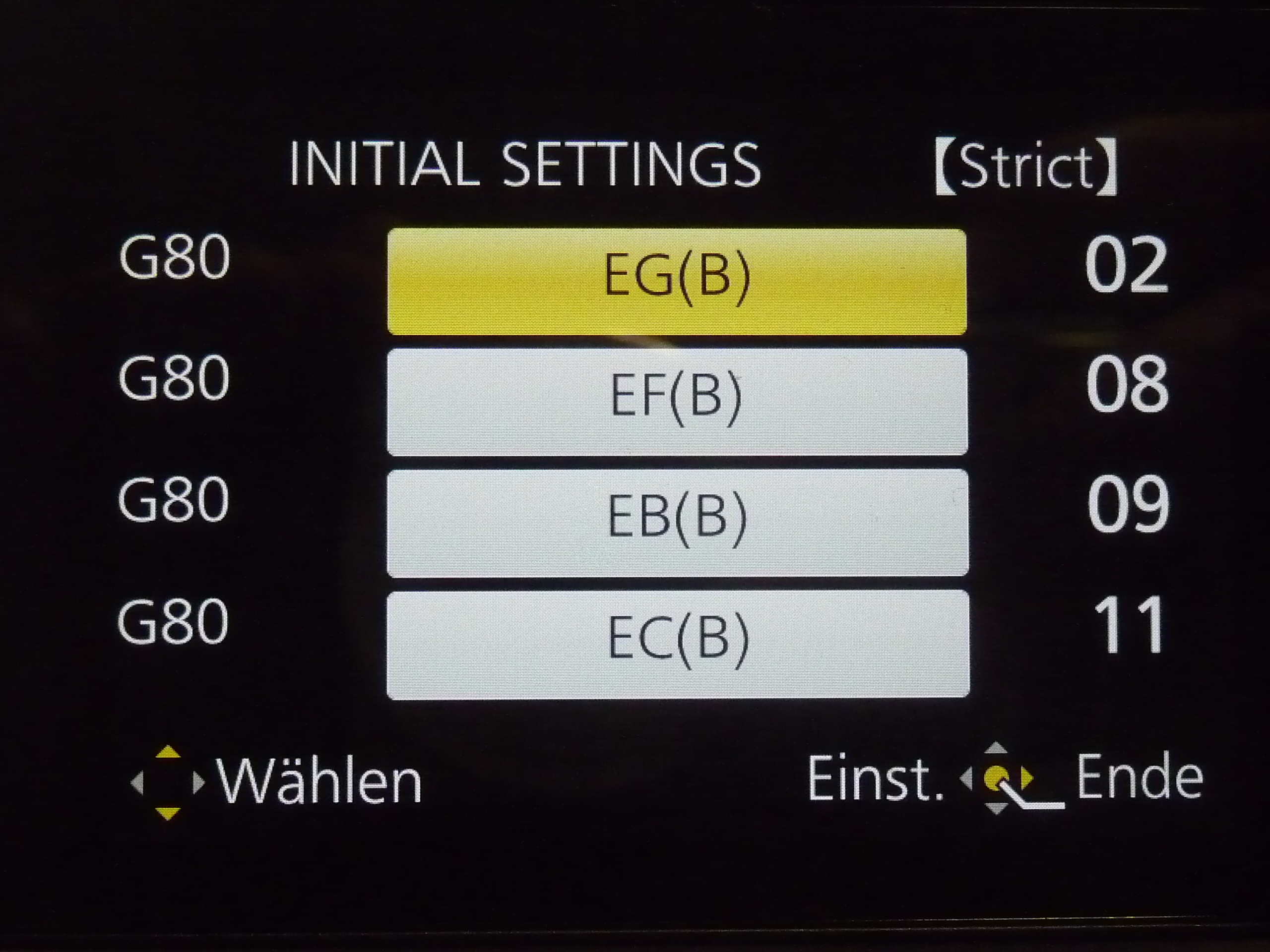

Frank Sonneberg Posted July 22, 2017 Share Posted July 22, 2017 Hi, I tried to get unlimited recording on G80 / G81 as I lost some important scenes by the camera stopping recording at 29:59. According to different sources ther's a way to not only switch from NTSC framerates to PAl and vice versa but also remove the 30 min time limit, tested with G7 and other Panasonic models. Here's teh procedure: 1. Switch OFF camera 2. Put Mode Dial into P 3. Press and hold DISP, AF/AE Lock and Right Cursor buttons while switching On 4. Press Playback button 5. Press and hold AF/AE Lock and Up Cursor buttons while switching Off 6. Power ON, then switch OFF. Black exclamation mark in yellow triangle will appear instead of Lumix logo 7. Reboot and camera will be in test mode Reverting back to initial state: 1. Switch On camera 2. Put Mode Dial into P and switch to single shot mode 3. Press and hold MENU/SET and Right Cursor buttons while switching Off. Initial Settings screen will appear On G7 IIRC only one line shows up, "G7 GH 22". That's all. On my G81 4 lines showing up, see attached screenshot. Here I'm stuck. The only things I can do is removing [strict] by pressing DISP and changing G80 into G81 by pressing Fn4. So my guess is, there's no way to remove the 30 min limit? Has someone been more successful? Cheers - Frank. Please note that you are doing anything at your own risk. Link to comment Share on other sites More sharing options...
Grimor Posted July 22, 2017 Share Posted July 22, 2017 In this menu if you have a chance of select a region without limit (AU?) you can get of the time restriction. Link to comment Share on other sites More sharing options...
Frank Sonneberg Posted July 22, 2017 Author Share Posted July 22, 2017 yes, this is what I was hoping for, but didn't manage to get it. I could just change "G80" into "G81", but this doesn't change the time limit, of cause not, because both models are European models. Additionally I could navigate the yellow field to the other 3 regions (EF, EB and EC, guess this ist für France, Britain and Spain?), but this doesn't change the time limit either. So maybe there's a hidden button combination to get to G85 model or Hongkong or Australian models, but I have yet to find Link to comment Share on other sites More sharing options...
Grimor Posted July 22, 2017 Share Posted July 22, 2017 4 hours ago, Frank Sonneberg said: (EF, EB and EC, guess this ist für France, Britain and Spain?), but this doesn't change the time limit either. I can confirm that EC is the Spanish G80. Probably @BTM_Pix is the one who can explain what the "service mode" does. Frank Sonneberg 1 Link to comment Share on other sites More sharing options...

Super Members BTM_Pix Posted July 23, 2017 Super Members Share Posted July 23, 2017 20 hours ago, Grimor said: Probably @BTM_Pix is the one who can explain what the "service mode" does. It is basically some additional setup that can be done when the camera is sent in for repair. The primary useful function for end users is for PAL users to get the additional frame rates by changing the region code. As far as I understood, the Australian version of the GX80 did not have the record time limit but there doesn't seem to be a way to get to setting up a European GX80 for example to be Australian from the region change so the best you can achieve from using the service mode (and its not a bad trick) is to get the extra frame rates. There are also some additional diagnostic functions for errors which may be useful if you're suffering from card errors and want to determine yourself if its the cards or the camera before you send it in for repair. It also lets you save and load ROM stuff but that is for saving and restoring user settings prior to and post repair as far as I can tell. Here is the GX80 service manual if you want to explore it yourself. All the Lumix cameras have the same service mode so its applicable for everyone https://www.apotelyt.com/doc-pdf/panasonic-gx85-service-manual.pdf Frank Sonneberg and Grimor 2 Link to comment Share on other sites More sharing options...

Frank Sonneberg Posted July 24, 2017 Author Share Posted July 24, 2017 14 hours ago, BTM_Pix said: It is basically some additional setup that can be done when the camera is sent in for repair. The primary useful function for end users is for PAL users to get the additional frame rates by changing the region code. As far as I understood, the Australian version of the GX80 did not have the record time limit but there doesn't seem to be a way to get to setting up a European GX80 for example to be Australian from the region change so the best you can achieve from using the service mode (and its not a bad trick) is to get the extra frame rates. There are also some additional diagnostic functions for errors which may be useful if you're suffering from card errors and want to determine yourself if its the cards or the camera before you send it in for repair. It also lets you save and load ROM stuff but that is for saving and restoring user settings prior to and post repair as far as I can tell. Here is the GX80 service manual if you want to explore it yourself. All the Lumix cameras have the same service mode so its applicable for everyone https://www.apotelyt.com/doc-pdf/panasonic-gx85-service-manual.pdf Thanks for the info. I looked at the service manual and as far as I understand, an european model can only be changed to the different european countries, whereas e.g. an US model G85 could be changed into model of other regions exept european model. So far, so bad (for owners of european models). Link to comment Share on other sites More sharing options...

Super Members BTM_Pix Posted July 24, 2017 Super Members Share Posted July 24, 2017 3 hours ago, Frank Sonneberg said: Thanks for the info. I looked at the service manual and as far as I understand, an european model can only be changed to the different european countries, whereas e.g. an US model G85 could be changed into model of other regions exept european model. So far, so bad (for owners of european models). You were able to change to NTSC mode to get the 30p and 60p though? Link to comment Share on other sites More sharing options...
Frank Sonneberg Posted July 24, 2017 Author Share Posted July 24, 2017 1 hour ago, BTM_Pix said: You were able to change to NTSC mode to get the 30p and 60p though? Good question On my "UNhacked" G81 the following frame rate options appear in the menu: 4K 30p 4K 25p 4K 24p FHD 60p FHD 50p FHD 30p FHD 25p HD 30p HD25p "Hacking" my 2nd G81 body doesn't change anything ref. frame rates, the same options as above show up. BUT: If I change the INITIAL SETTINGS to "G80" instead of "G81" the following frame rate options appear in the menu: 4K 30p 4K 24p FHD 60p FHD 30p HD 30p Hope this helps to clarify, else please ask again. Link to comment Share on other sites More sharing options...
