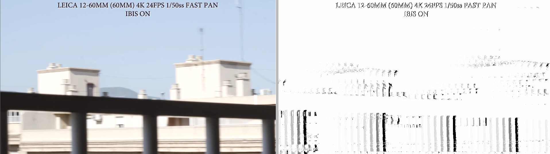

Grimor Posted August 15, 2017 Share Posted August 15, 2017 On 7/8/2017 at 11:49 PM, PannySVHS said: Wow, this is awesome! EOSHD community supporting one another! Slow pan and quick one, one on fore,-middle- and one on background! Now I am getting greedy. With IBIS, with DualIS, one without. Hot darn, Grimor, you must be very brave to offer this!:) Anyhow, would be great as you like. Awesome. Thanks! Dirty and not very scientific test. 4k 24fps and 1/50ss. Lens is Leica 12-60mm. With and without Dual Ibis 2.(e-stabilization not used in this test) Sandisk Extreme Pro 95MB/s. Almost repeating same movement with the Bescor Pan/tilt head. Jitter is very noticeable at longer focals lenght. Now i think IBIS is really awesome with erractic movements, and little shakes (like handheld walking shoot) but not for slow and linear moves like pans. Probably jitter when panning is due sensor moving in the same direction to the camera pan, trying to compensate, then can´t go further and came to the center, and then to the same direction again and back to the center again. several times per second, and making a worse image. Hope it help. PannySVHS 1 Link to comment Share on other sites More sharing options...

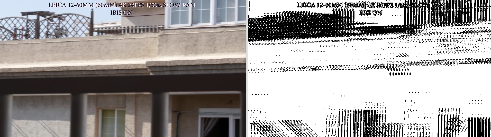

no_connection Posted August 20, 2017 Share Posted August 20, 2017 On 2017-08-16 at 0:33 AM, Grimor said: Dirty and not very scientific test. 4k 24fps and 1/50ss. Lens is Leica 12-60mm. With and without Dual Ibis 2.(e-stabilization not used in this test) Sandisk Extreme Pro 95MB/s. Almost repeating same movement with the Bescor Pan/tilt head. Jitter is very noticeable at longer focals lenght. Now i think IBIS is really awesome with erractic movements, and little shakes (like handheld walking shoot) but not for slow and linear moves like pans. Probably jitter when panning is due sensor moving in the same direction to the camera pan, trying to compensate, then can´t go further and came to the center, and then to the same direction again and back to the center again. several times per second, and making a worse image. Hope it help. I am not sure what you are referring to as jitter. I analyzed parts in the video where you see the shadow of several frames (think frame based motion blur) and found no evidence of any difference in frame timing/position. You can even see some parts where every frame lands exactly one half a fence rib apart making the pins "stand still". If ibis was indeed moving the ribs would not land in the same place every frame. Or if the frame timing was wrong. Here is a quick and dirty "test" of the footage, so please excuse me if I got the problem in question wrong. I attaches a screenshot of one part of it where you can see the edge of the ribs compared to previous frames and they show pretty much the same distance traveled between each frame. All I can see is a strobing effect from having high contrast objects jumping from one place to another. And that is a real problem too, but it's not jitter. Playing back low framerate content and having it look smooth is a whole chapter in itself. And so is capturing it. 180* shutter isn't a be all end all solution, it depends on the scene. Link to comment Share on other sites More sharing options...
no_connection Posted August 20, 2017 Share Posted August 20, 2017 Here is maybe a better view. You can see that over 8 frames there is little to no difference in distance between frames. You can also see that the blur on the knob on the fence thingie is very charp, way less than 180* of movement you would expect from 1/50ss. Grimor 1 Link to comment Share on other sites More sharing options...

Grimor Posted August 20, 2017 Share Posted August 20, 2017 1 hour ago, no_connection said: Here is maybe a better view. You can see that over 8 frames there is little to no difference in distance between frames. You can also see that the blur on the knob on the fence thingie is very charp, way less than 180* of movement you would expect from 1/50ss. Well, don't know if it's jitter or it's other thing like strobbig like you said. When i set the test, i thinked that 1/50ss was the proper for the motion blur with 24 fps. And used a motorized pan/tilt head at his fast/slow speed to always repeat same movements. I can repeat the test outside and with different configuration if needed. Link to comment Share on other sites More sharing options...
no_connection Posted August 20, 2017 Share Posted August 20, 2017 You could test down to 1/30 or so and see if it makes a difference. I'm not entirely sure that is really 1/50. Ill try and measure it. *edit* it does indeed look like 1/50ss but due to the high contrast a lot of it is washed out leaving maybe a 1/100 edge or even less. And it is in high contrast areas where it's worse to begin with. So it might need more motion blur to help. I noticed that my video I made with the first settings you see in my first screenshot looked smoother than the original video, so it might need some blur to look ok at fast pans, which make sense if you think about it. At slower pans it might be too buttery instead. Link to comment Share on other sites More sharing options...
kidzrevil Posted August 21, 2017 Share Posted August 21, 2017 On 8/20/2017 at 0:35 PM, no_connection said: Here is maybe a better view. You can see that over 8 frames there is little to no difference in distance between frames. You can also see that the blur on the knob on the fence thingie is very charp, way less than 180* of movement you would expect from 1/50ss. hmm this could very well be the noise reduction algorithm repeating frames and then the sharpening algorithm going crazy on the high contrast edges causing a jitter effect when panning. The gh2 had a similar problem https://www.personal-view.com/talks/discussion/2848/gh2-in-24p-noticeable-strobe-effect-with-any-motion-in-frame/p1 Link to comment Share on other sites More sharing options...
