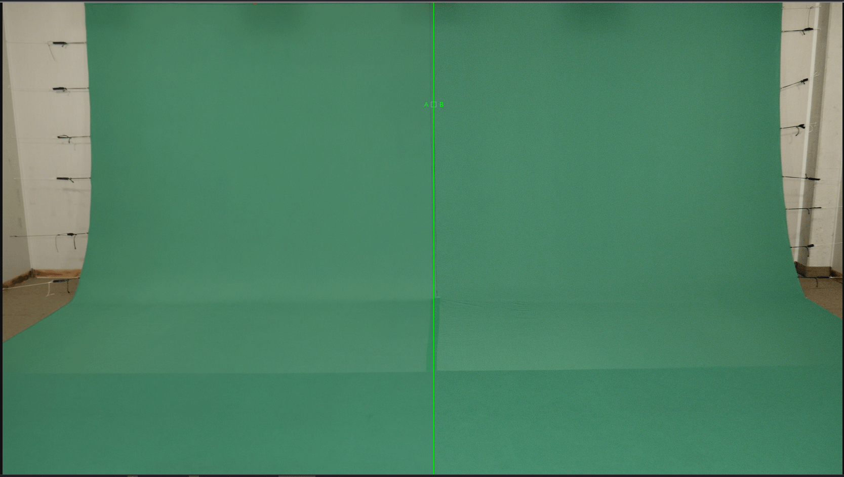

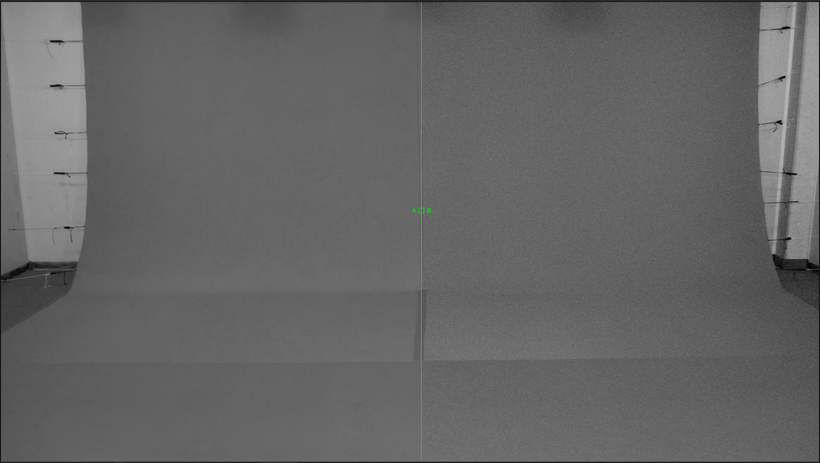

I have done some testing: comparing the internal mp4 footage with the external atomos Prores 422 footage
I got screenshots from the comparence from the Blue channel and from the color channel:
Cold camera is: when i made the shot with the camera 1 second after i had put all the lights on.
Warm camera is: when the camera was on for an hour, warmed up, cause of the influence from one of my lights, which was very close to the camera.
left.mp4-cold-camera-right-prores-warm-camera-blue-channel.thumb.PNG.91e6c5a7e0033771dd33409649501a63.PNG
left-mp4-cold-camera-right-prores-warm-camera-color-channel.thumb.gif.489a572a3f2aab576123270b6a61885c.gif
MP4Internal / Prores 422 Atomos
In the left you see the cold camera MP4 Internal. In the right you see the warm camera Prores 422 recorded with the Atomos.

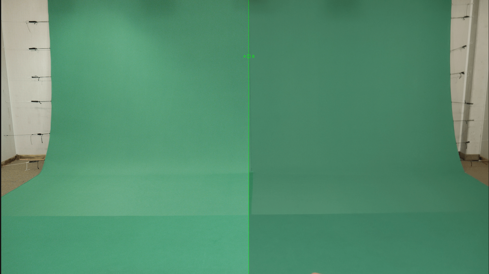

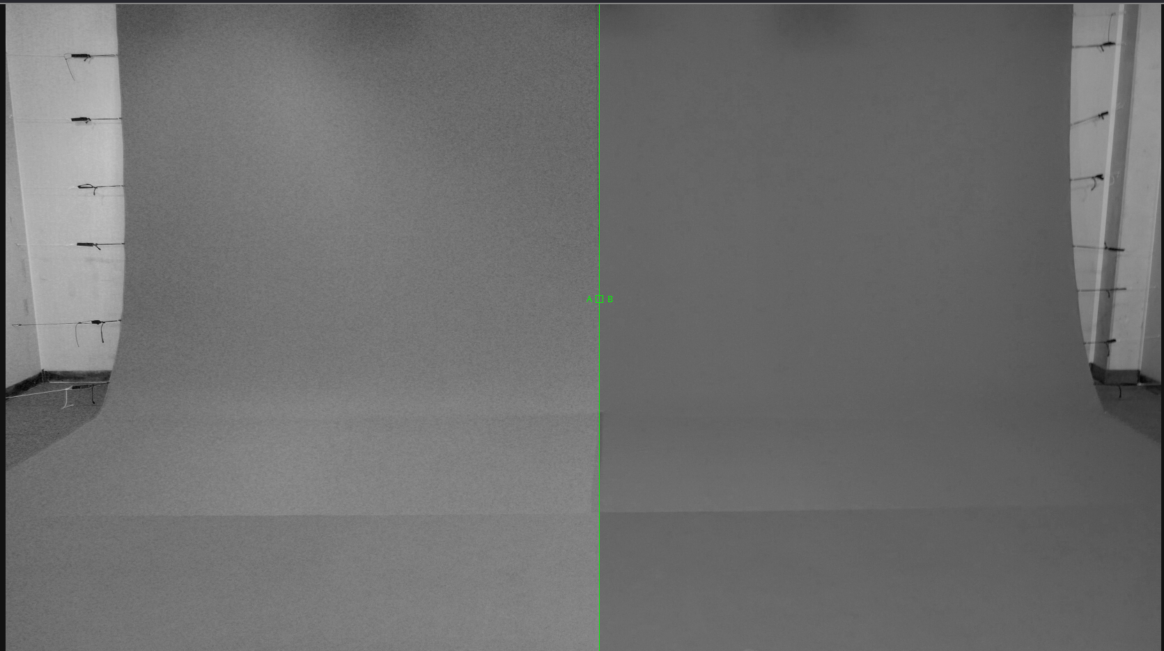

Left-cold-camera-prores-right-cold-camera-mp4-blue-channel.thumb.gif.4f34b51752e09725f41344e2f40a00b5.gif
left-cold-camera-prores-right-cold-camera-mp4-color-channel.thumb.gif.50a2bfd6b5d165240dbabb8ed5a7698d.gif
Prores 422 Atomos / MP4Internal
In the left you see the cold camera Prores 422 recorded with the Atomos. In the right the cold camera MP4 internal.
I forgot to put the main lights out in my DIY green screen room, when i filmed the cold-camera shot with the prores 422.
Which is not so bad after all, cause you can see, that although it has more light coming in then the internal mp4 shot. The prores 422
still has loads more noise.

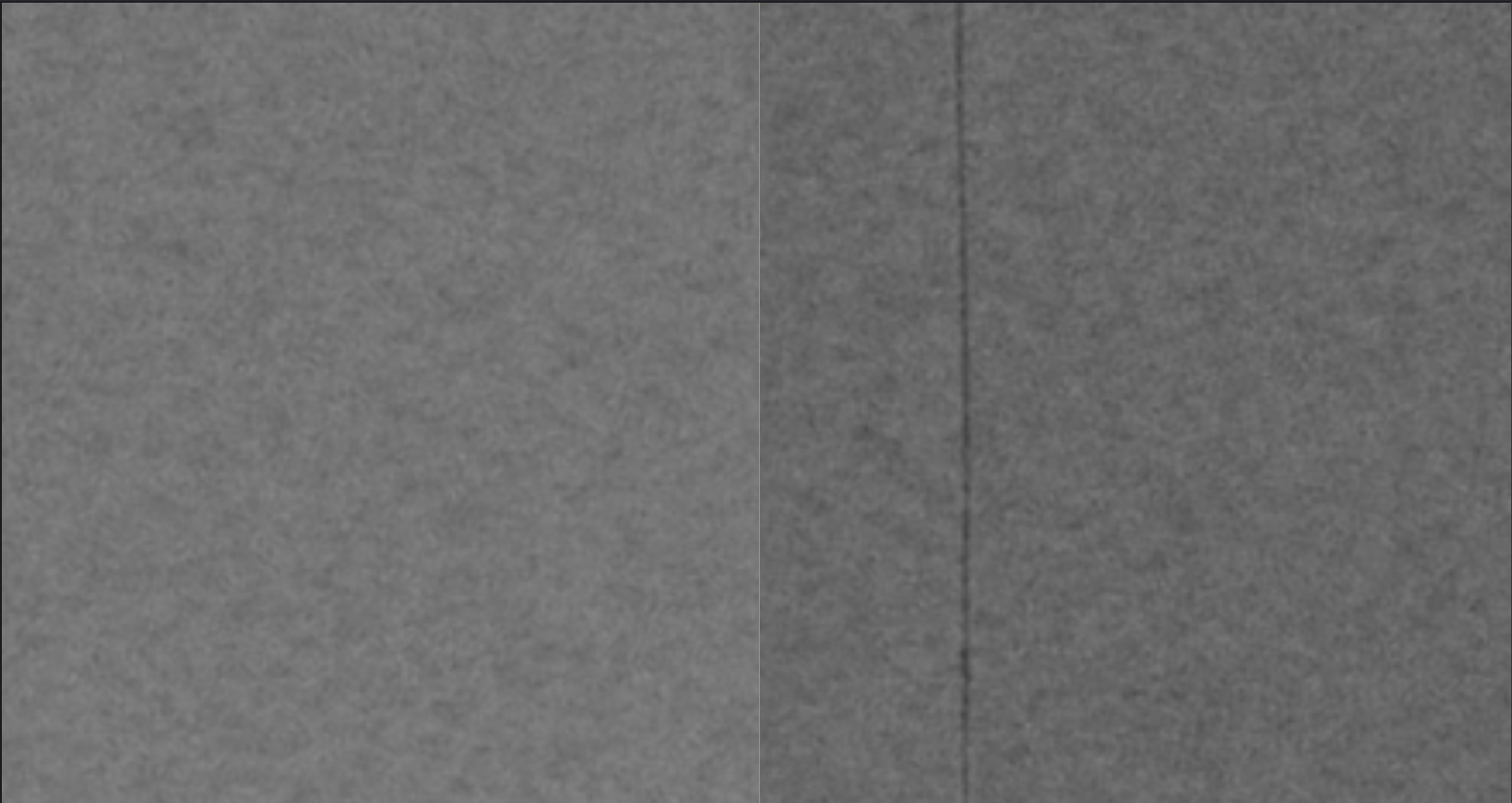

598b20c3ad687_left-cold-prores-right-warm-prores-400-blue-channel.thumb.gif.dc954d1629e57ed9b88d0aea0397825d.gif
Cold-camera-prores 422 / warm camera prores 422 they are both scaled up to 400%
In the left you see the cold camera Prores 422 recorded with the Atomos. In the right you see the warm prores 422 recorded with the Atomos.
Here i also forgot to put the main lights out in my DIY green screen room, when i filmed the cold-camera shot with the prores 422.
You can see that although the lighting is differently the noise is not. As far as i can tell?!
