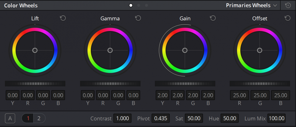

EthanAlexander Posted August 15, 2017 Share Posted August 15, 2017 8 hours ago, jcs said: Set Gain in the first node to 2.0, that will fix the black subtract issue. Ok, I know this is asking a lot of your time, but can you give me a screenshot or two of the process. I've tried every combination of nodes being set to 2 gain and the image is still black. I'd really like to figure this out because I don't use Premiere (and would love for this to be GPU accelerated since I've got so much footage to go through). Link to comment Share on other sites More sharing options...
jcs Posted August 16, 2017 Author Share Posted August 16, 2017 On 8/15/2017 at 7:37 AM, EthanAlexander said: Ok, I know this is asking a lot of your time, but can you give me a screenshot or two of the process. I've tried every combination of nodes being set to 2 gain and the image is still black. I'd really like to figure this out because I don't use Premiere (and would love for this to be GPU accelerated since I've got so much footage to go through). Node 2 is a duplicate (can ignore). Node 3 is Serial, and Node 5 appears after adding the Layer Node to Node 3 (set to Subtract): Set Gain for Node 3 to 2.0: Add Box Blur for Node 5: This is for the LCE step, you can use Gaussian blur for the mid-frequency sharpen step, and standard Resolve sharpen for the highest frequencies. EthanAlexander 1 Link to comment Share on other sites More sharing options...
EthanAlexander Posted August 16, 2017 Share Posted August 16, 2017 Thank you so much! I was setting the key gain to 2 not the LGG gain... whoops. Thanks for taking the time. I'm going to use this a lot on interviews on the punch-ins from 4K. Just a little boost in perceived detail to help it match the wide. jcs 1 Link to comment Share on other sites More sharing options...
