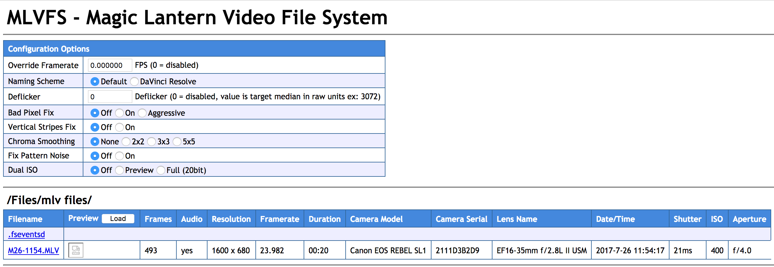

dreamplayhouse Posted August 17, 2017 Author Share Posted August 17, 2017 13 minutes ago, Justin Bacle said: You have to update MLVFS to the latest version for it to be able to remove the pink dots I'm using an old version myself on windows since I only use my 50D. But you have to upgrade if you want to use newer models. See : http://www.magiclantern.fm/forum/index.php?topic=13152.0 and https://bitbucket.org/dmilligan/mlvfs Hmm I thought I'm running latest but maybe not? This is the attached what I used. Below shows in tiny text Version: 24ebdf5 May 5 201718:56:15 Link to comment Share on other sites More sharing options...
Justin Bacle Posted August 17, 2017 Share Posted August 17, 2017 That's weird as the pink dot issue has been resolved since April 2016 in MLVFS :s You should have better luck on magic lantern's forum Link to comment Share on other sites More sharing options...
