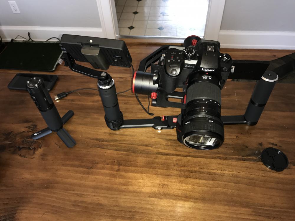

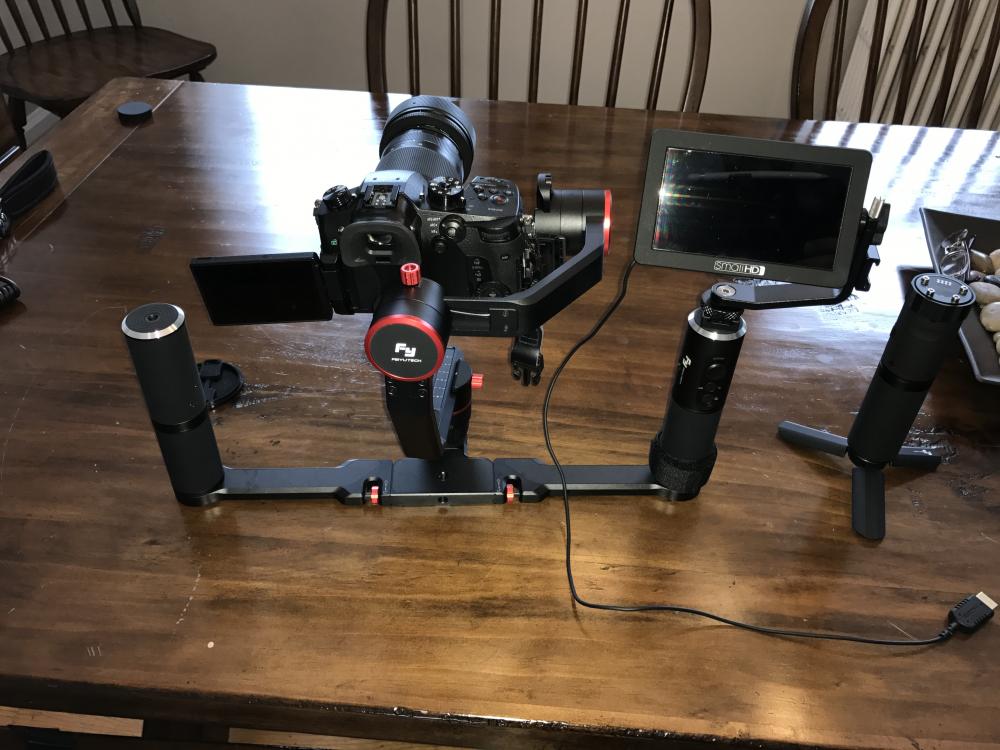

DBounce Posted August 27, 2017 Author Share Posted August 27, 2017 I'm happy to report that my setup is pretty simple. Which is something I never thought possible for anamorphic shooting. Here's a picture: salim and andrgl 2 Link to comment Share on other sites More sharing options...

DBounce Posted August 28, 2017 Author Share Posted August 28, 2017 2 hours ago, Fritz Pierre said: You're really nailing the 1.33 40...how heavy is the setup as you posted...iwhat is comfortable time wise for a take?....looks great!! Thanks, I'm really trying to embrace shooting anamorphic. These takes honestly did not require much prep. No more than 10 minutes. It was adhoc, so pretty quick. I set the GH5 to a max ISO of 1600 to keep things cleaner. The setup is pretty light, particularly if you are using the handlebar kit. Everything in this setup is there for the following reasons: 1. Lightweight: I would guess the setup pictured is about ~7lbs. I have not weighed it, but it is much more manageable than my Letus Helix Jr. It's about as light as you can go if you intend to fly an anamorphic setup. I considered the Atomos Ninja Inferno, but the size and weight, combined with marginal battery life, were all things I felt would hinder the usability of the rig. 2. High quality: The Panasonic 35-100mm offers nice quality and is fast enough within the usable aperture range ( >f4 ) to be a great taking lens when combined with the SLR Magic 40 Compact and a gimbal. A big plus is that all movement is internal. Also the practical zoom range when combined with the 40 Compact is 35-70mm. Beyond that and the image breaks down, while going below yields vignetting. 3. Flexible use: The Feiyutech a2000 can be purchased with both single and dual handle setup. This makes it easy to go ultra compact when required. The handles have a remote built in, so no more fussing with bluetooth. The thing just works... which is what I require when time is short. While the zoom means I can quickly dial in whatever focal lengths I require. And should I need some ultra closeup shots, I can quickly throw on a diopter, without upsetting the whole setup as the motors are powerful enough to make up a minor weight difference and the gimbal automatically calculates the weight change and adapts. 4. To decrease time between takes: All of these things combine to make this setup quick to get into action. It's very none fussy. I just doesn't get in the way of getting the shot. Link to comment Share on other sites More sharing options...
