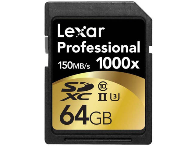

Diego Marqz Posted September 7, 2017 Share Posted September 7, 2017 Wich card to buy? Did you tested different cards with this firmware? I found a Delkin Devices V60 @bhphotovideo for $99 bucks... says 250mb/s read but 100mb/s write... you think this could be enought for the 400mbps safely? Or should i buy a Angel Bird for $200 bucks with 250mb/s Write speed? As you can see. is twice the price... thats why i would like to have ANY advice about the delkin if possible to use with no problems. Link to comment Share on other sites More sharing options...
Diego Marqz Posted September 7, 2017 Share Posted September 7, 2017 On 9/2/2017 at 4:41 PM, Christopher Taylor said: just wondering: I noticed you said that 95 MB/s cards aren't quite good enough, and we should invest in 300MB/s cards... I've seen some lexar 150MB/s cards, has anyone tested those? Is the 300MB/s an absolute necessity to get everything working right? These Lexars have only 45mb/s write speed. 400mbps is 50MB/s so no good at all. Link to comment Share on other sites More sharing options...

Ari Posted September 9, 2017 Share Posted September 9, 2017 On 9/7/2017 at 5:53 AM, Diego Marqz said: These Lexars have only 45mb/s write speed. 400mbps is 50MB/s so no good at all. I bought one of these when I bought GH5 in the summer, and it should be good enough for 1080p all-i. (I'll stick to 1080p for a while.) Link to comment Share on other sites More sharing options...

philipd Posted September 18, 2017 Share Posted September 18, 2017 On 07/09/2017 at 3:53 AM, Diego Marqz said: These Lexars have only 45mb/s write speed. 400mbps is 50MB/s so no good at all. Hi All-Intra at 400Mbits/sec will need a card rated at V60 or better. Ignore all other marketing speeds or bench-marks of a card, they aren't relevant in this context. Unless the card says V60 or V90 it isn't going to work at 400Mbits/sec despite the advertised speeds. The V moniker means the card supports a new specially designed protocol for real-time video recording that allows these 'high' minimum guaranteed write speeds, the number after the V gives the minimum guaranteed write speed that the card will support when used with equipment that also uses the new protocol, which the GH5 does of course. Benchmarks on websites reviewing these cards may also cause confusion, as it is almost a given that benchmarks may show sustained write data-rates to below the V rating, but that will be because they are not bench-marking the card using the new real-time recording protocol and hardware. Regards Phil Link to comment Share on other sites More sharing options...
