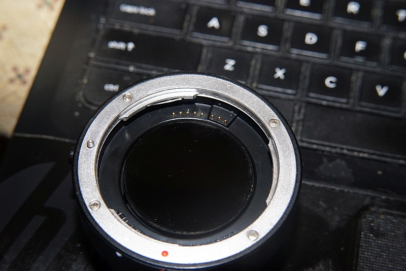

noone Posted September 4, 2017 Share Posted September 4, 2017 I mainly use a Metabones IV (not the latest version) but I also use a couple of others sometimes. The Metabones is designed to take TS lenses with a larger sculpted hole (bigger at the corners so shifting is covered better). I also use a cheap no name as a back up to the MB and an even cheaper Fotga that is very lightweight and I wouldn't use it that often except it has a small ledge in it that almost exactly matches the glass from a 43mm filter which means I can use cheap filter glass (the metal rims filed off) which is a LOT cheaper than using 150mm filters in my filter holder. Only have a IR filter and graduated filter so far (the IR filter works well with it). This Fotga adapter is the one I use for AF with other Canon lenses mainly. Link to comment Share on other sites More sharing options...
