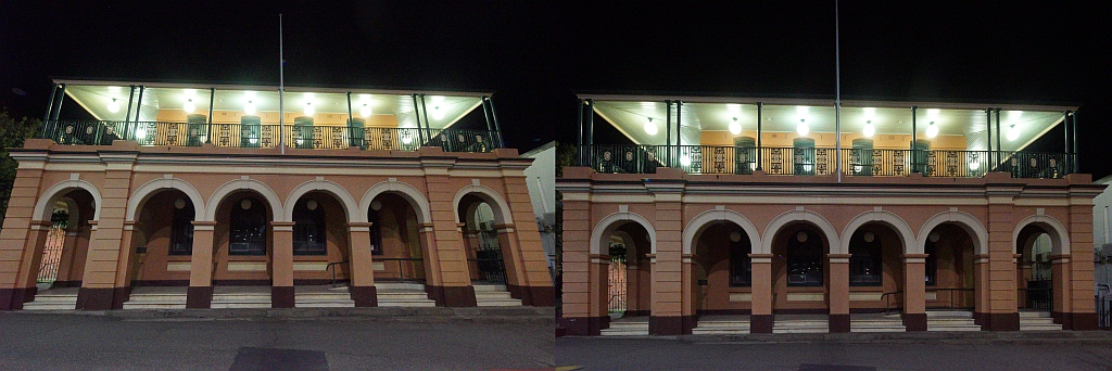

noone Posted September 8, 2017 Share Posted September 8, 2017 I have never shifted while recording before. I just did that because I was being lazy and it was cold and I didn't want to upload two lame temporary videos. I am still deciding if I go to the show (I really want to try and shoot a few things there up close but it isn't all that good a show by most accounts this year). Here are two stills shot from the same spot with the same settings (f8 1/60) except shift being used in one of them ISOs (auto ISO) 40,000 unshifted and 32,000 shifted. Just hand held jpeg snaps (I took the 17 and A7s for a early morning walk). Video would be very similar. Link to comment Share on other sites More sharing options...
