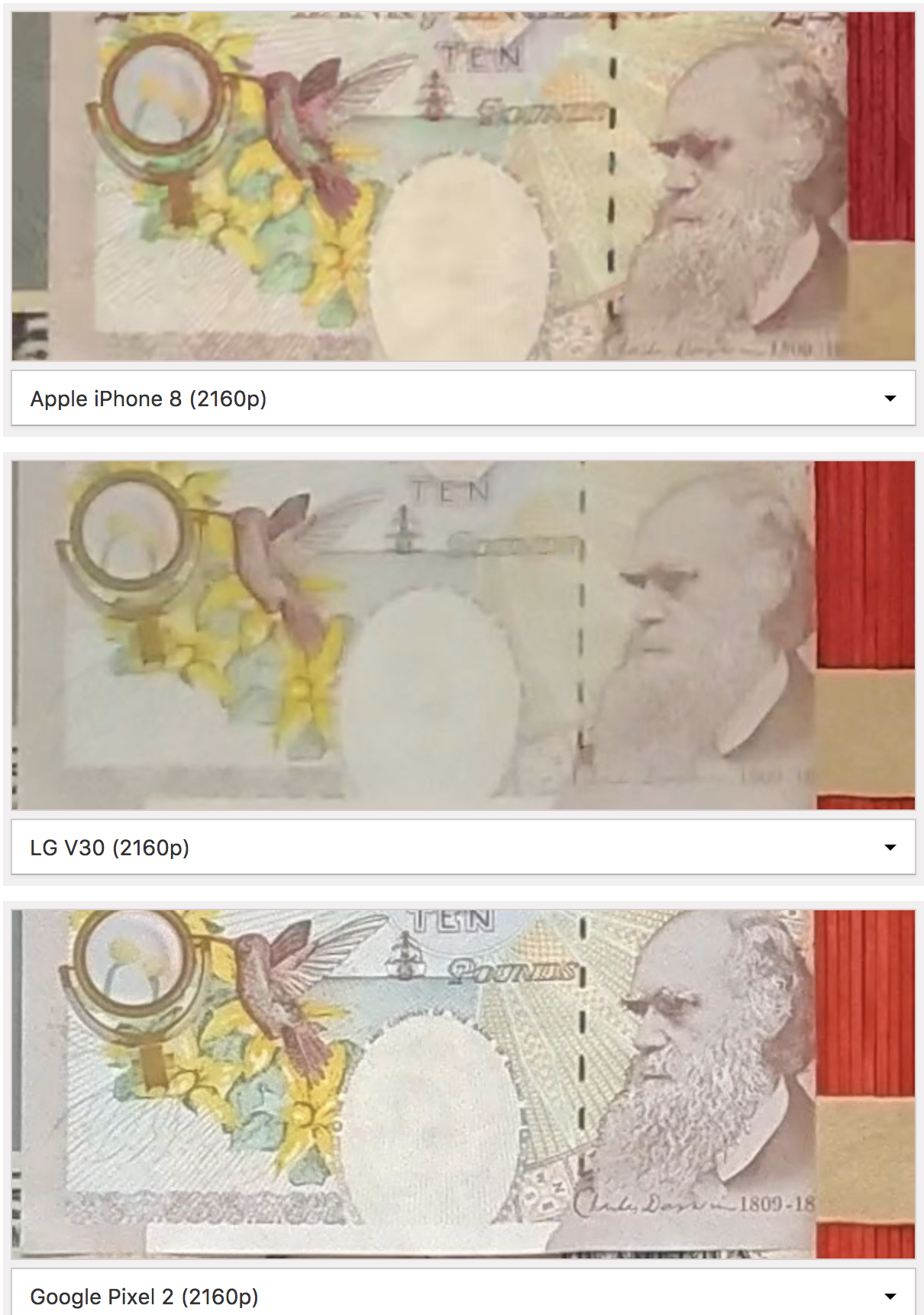

Emanuel Posted November 16, 2017 Share Posted November 16, 2017 With competitors: https://www.gsmarena.com/vidcmp.php3?idType=3&idPhone1=8854&idPhone2=8712&idPhone3=8505 Link to comment Share on other sites More sharing options...
Don Kotlos Posted November 16, 2017 Share Posted November 16, 2017 Link to comment Share on other sites More sharing options...
sanveer Posted November 16, 2017 Share Posted November 16, 2017 On 14/10/2017 at 8:10 PM, DBounce said: https://***URL not allowed***/lgs-v30-smartphone-10-bit-color-lg-cine-log-video-in-a-phone/ Incorrectly Researched Article. Seems shoddy heresay at best. I read an article, much after this somewhere, where LG Specifically CONFIRMED that the Log, like all other video is limited to 8-bit 4-2-0. 6 hours ago, Don Kotlos said: I wonder why it appears so soft. Is sharpness fialled down to 0 or -5 (Log)? Link to comment Share on other sites More sharing options...

Don Kotlos Posted November 16, 2017 Share Posted November 16, 2017 4 hours ago, sanveer said: I wonder why it appears so soft. Is sharpness fialled down to 0 or -5 (Log)? Noise + excessive noise reduction my guess. That was the low light shot from here: https://www.gsmarena.com/vidcmp.php3?idType=5&idPhone1=8573&idPhone2=8712&idPhone3=8733 But the good light image does not look much better, V30 is full of compression artifacts, so even if it is recording 10bit it is worse than many 8bit phones. Link to comment Share on other sites More sharing options...
sanveer Posted November 16, 2017 Share Posted November 16, 2017 4 hours ago, DBounce said: And where is the link to that article? Sorry, my bad: https://www.androidpit.com/in-depth-lg-v30-perfect-video-smartphone Read the portion that says, "LG’s Korean camera specialists confirmed with us that the LG V30 takes log videos specifically in 8-bit 4:2:0. Am I just about to lose you?". 4 hours ago, Don Kotlos said: Noise + excessive noise reduction my guess. That was the low light shot from here: https://www.gsmarena.com/vidcmp.php3?idType=5&idPhone1=8573&idPhone2=8712&idPhone3=8733 But the good light image does not look much better, V30 is full of compression artifacts, so even if it is recording 10bit it is worse than many 8bit phones. Yes, I noticed in many test videos online that the Dynamic Range is noticeably lesser than other flagship, and that the stabilization is also disappointing. Very disappointing indeed. Link to comment Share on other sites More sharing options...
