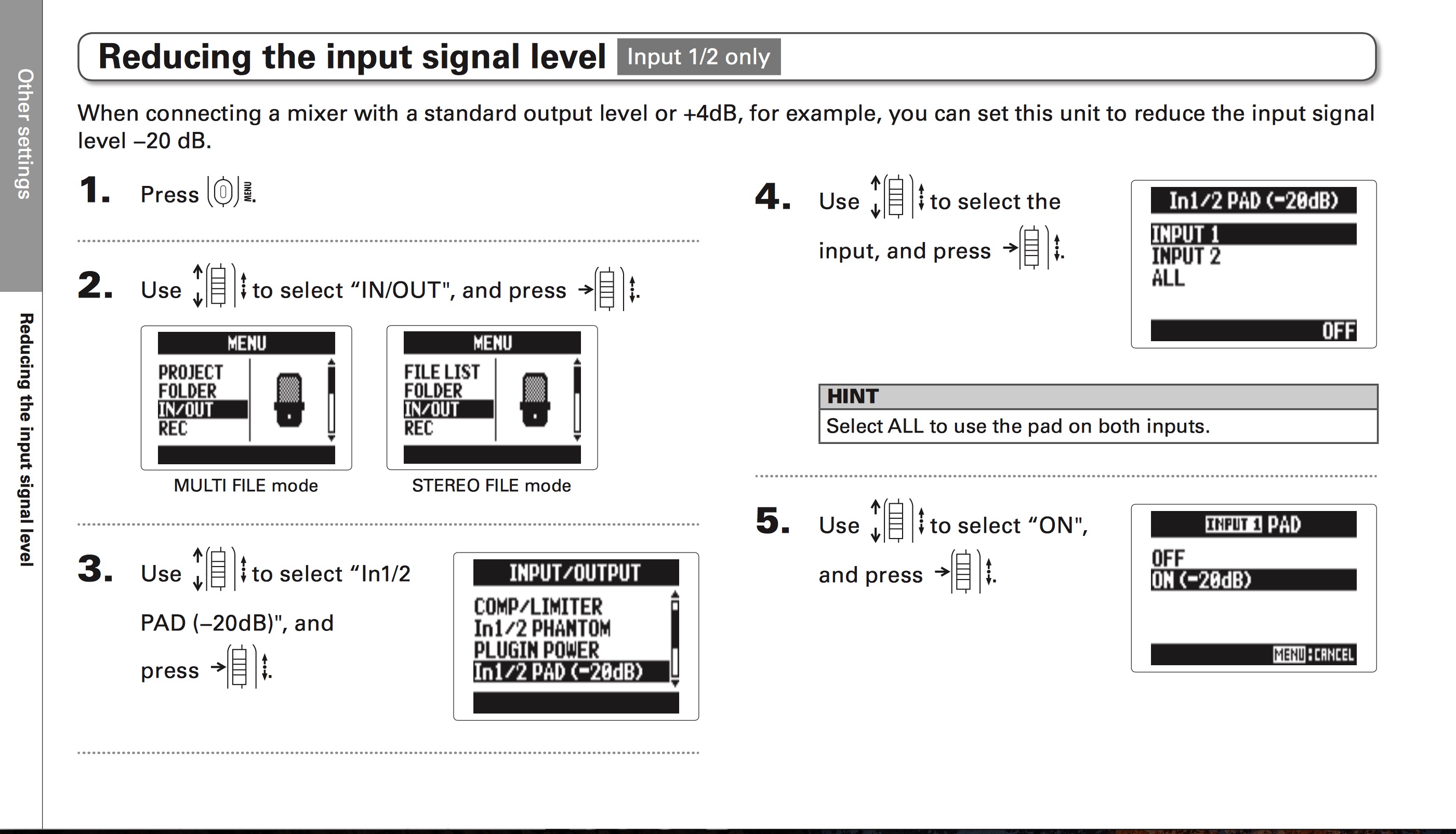

Super Members BTM_Pix Posted September 8, 2017 Super Members Share Posted September 8, 2017 There is a menu controlled -20dB pad function for the Input 1/2 ports (the XLR/TRS ones) that might be causing this? Link to comment Share on other sites More sharing options...
mojo43 Posted September 8, 2017 Author Share Posted September 8, 2017 Thanks. Ya I saw this and set them to off. I wish that was the problem! Link to comment Share on other sites More sharing options...
