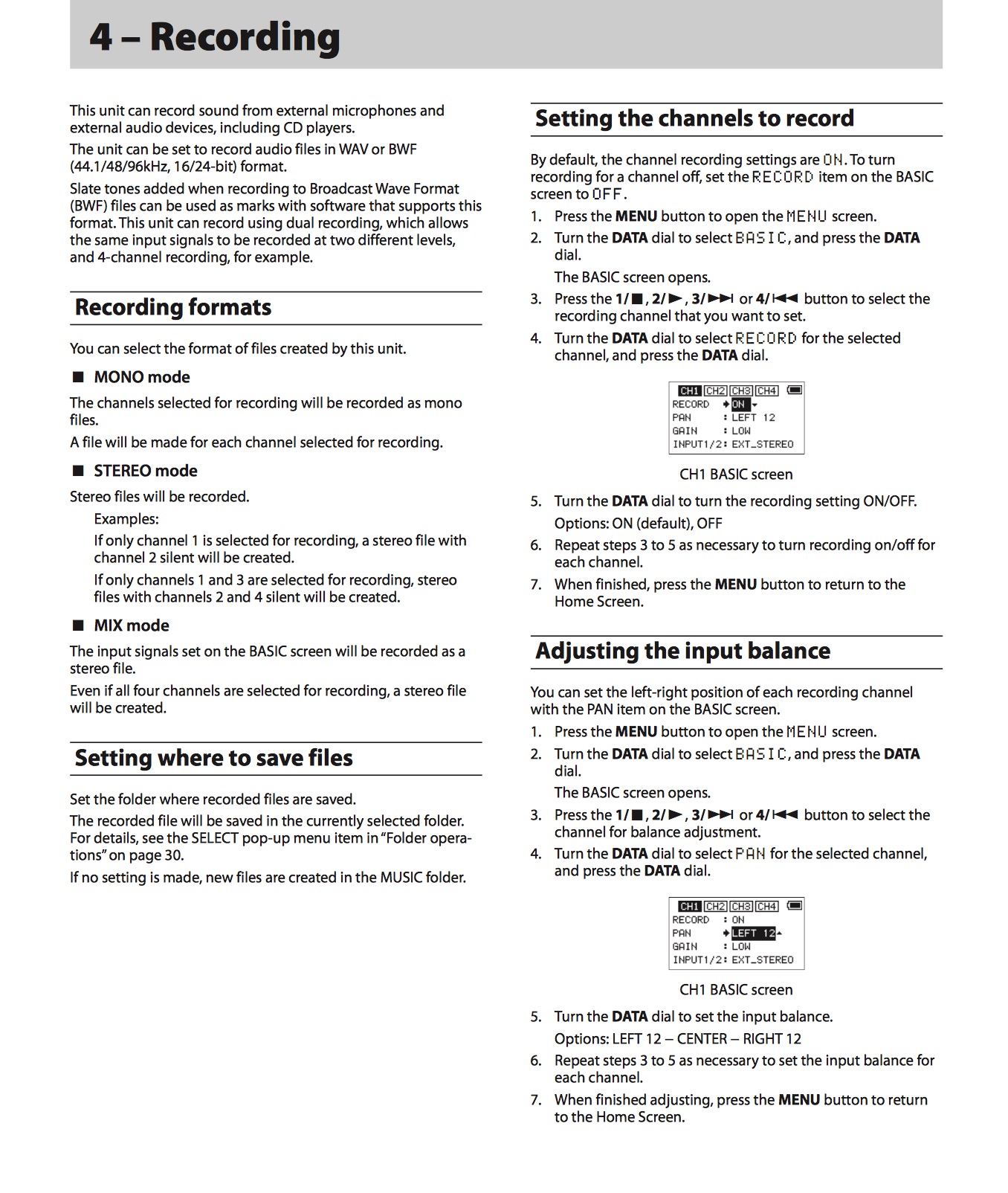

Arikhan Posted September 10, 2017 Author Share Posted September 10, 2017 Thanks @scotchtape and @Orangenz ! To clarify: I need TWO devices. One for mobile DSLR shooting (used to capture quality sound, mainly for bypassing internal (mostly poor) DSLR preamp, but sound will be recorded internally...So, it seems, the DR70D should be a good and affordable choice for this purpose. The second device should capture a quality sound feed, eg. on press conferences or concerts, as they are mixer devices with XLR output there, so I could capture the best possible sound directly in a H5 / H4N Pro directly and synchronize in post (sound will be captured in camera too, but only for check and sync purposes). As @scotchtape says, it seems, a Tascam DR-40 V2 would be an option too. So, what about the choice between Tascam DR-40 V2 and a Zoom H5 / H4N Pro? What's the recommendation of sound experts, based on own experience? Link to comment Share on other sites More sharing options...

Arikhan Posted September 10, 2017 Author Share Posted September 10, 2017 1 hour ago, Orangenz said: What audio are you after with the mobile DSLR shooting? Ambient, interior, exterior, shotgun? It's mainly needed, when doing interviews (therefore the Saramonic wireless lav mics) but I want to use it for ambient and exterior (eg. wildlife / nature footage) with a shotgun too... BTW (as I am not a sound expert): Could a DR-70D be use a recording device for sound feed capturing on concerts/press conferences - attached to the XLR of the central sound mixer of the presenter/music band - too? If so, I would not ncessarly need to buy a second device like a Tascam DR-40 V2 and a Zoom H5 / H4N Pro? For DSLR-usage I could attach it under my DSLR/DSLM cage... Link to comment Share on other sites More sharing options...
Orangenz Posted September 10, 2017 Share Posted September 10, 2017 21 minutes ago, Arikhan said: It's mainly needed, when doing interviews (therefore the Saramonic wireless lav mics) but I want to use it for ambient and exterior (eg. wildlife / nature footage) with a shotgun too... BTW (as I am not a sound expert): Could a DR-70D be use a recording device for sound feed capturing on concerts/press conferences - attached to the XLR of the central sound mixer of the presenter/music band - too? If so, I would not ncessarly need to buy a second device like a Tascam DR-40 V2 and a Zoom H5 / H4N Pro? For DSLR-usage I could attach it under my DSLR/DSLM cage... Very confused - didn't I just say something about that? Link to comment Share on other sites More sharing options...
Arikhan Posted September 10, 2017 Author Share Posted September 10, 2017 2 hours ago, Orangenz said: I'd use the 70D on the front of house desk feed (easier to plug in to a usb battery pack and not come unstuck, and better level controls from the desk signal), the tm2x on top of the camera, and the DR40 in my pocket attached to a shotty (ME66 or 67 in my case) on a handle. The two recorders have dual level record. It seems, I misunderstand this...Could you please explain why do you act like this (with TWO recorders at same time) ? To be more precise for my personal use: I want to use the DR-70D MAINLY to bypass the poor internal preamp of the DSLR...So the sound will be recorded IN THE DSLR with the Tascam as preamp (Mic --> Tascam (feed recording - Feed1) --> DSLR (feed recording - Feed2)), AND - at same time - in the Tascam for sound backup....I want to use this workflow, because recording sound on the DSLR (after bypassing the camera preamp with the Tascam), would speed up my workflow for journalistic use AND at same time I get a sound backup by recording sound feed in the Tascam... Thanks for sharing your experience and explaining! Link to comment Share on other sites More sharing options...

Super Members BTM_Pix Posted September 10, 2017 Super Members Share Posted September 10, 2017 1 hour ago, Arikhan said: It seems, I misunderstand this...Could you please explain why do you act like this (with TWO recorders at same time) ? To be more precise for my personal use: I want to use the DR-70D MAINLY to bypass the poor internal preamp of the DSLR...So the sound will be recorded IN THE DSLR with the Tascam as preamp (Mic --> Tascam (feed recording - Feed1) --> DSLR (feed recording - Feed2)), AND - at same time - in the Tascam for sound backup....I want to use this workflow, because recording sound on the DSLR (after bypassing the camera preamp with the Tascam), would speed up my workflow for journalistic use AND at same time I get a sound backup by recording sound feed in the Tascam... Thanks for sharing your experience and explaining! If you are recording a music gig, for example, the sound that will be coming from the mixing console feed is reinforcing the on stage sound - hence why the formal term for live audio systems being Sound Reinforcement. Depending on the band this will invariably not be providing the full representation of the gig as, for example, the overall guitar sound will be lower as it will be missing the sound of the on stage guitar amplifiers, which can be quite significant. If you are doing a Kraftwerk gig then this is less of an issue as there is nothing naturally occurring on stage (sometimes physically in their case ) that isn't present in the mixing console mix. However, in all instances, you will be missing the room ambience (including the sound of the audience) and the mix from the console will always sound much drier. Hence, having a secondary ambient mic source, allows you to mix both. With regard to the DR-70D, yes this would work in this mode as the mic inputs are switchable to line level to take a signal from the feed box at a press conference. It is actually very useful in this role as with it having four inputs you can attach a receiver from a radio mic to enable you to supplement the provided feed with your own mic. In a press conference situation can be invaluable in the same way as the music gig example as whilst the persons(s) answering the questions always have microphones, it is not always the case that the journalists asking the questions are covered with a mic so you can end up with the audio from the central feed box having barely any level for the questions. Arikhan 1 Link to comment Share on other sites More sharing options...
Arikhan Posted September 10, 2017 Author Share Posted September 10, 2017 @BTM_Pix Does this mean, that when attaching a DR-70D to the XLR of a mixing console (of a band OR within a press room) I could get and mix A. the original sound (of a speaker or band) and B. the ambient sound when recording with a second mic the ambient sound? And if it understood it right, could I record A. Original sound and B. Ambient sound on two different channels, so I could work on it separetely in post and mix it to meet my requirements? 1 hour ago, Kisaha said: Zoom F4 is the best option out of the Zoom range, plenty of power options too. You can do anything with it, you do not need another recorder, not now, not later as a lot of -low budget- production sound engineers have adopted the F4 and F8 Zoom devices. Thanks for input Kisaha. Is that a such big difference between the F4 and a DR-70D concerning sound quality and processing features and possibilities? I just ask because my sound knowledge is rudimental till now, but the price difference between the two mentionned devices is significant.... Thank you guys for help! Link to comment Share on other sites More sharing options...
Super Members BTM_Pix Posted September 10, 2017 Super Members Share Posted September 10, 2017 4 minutes ago, Arikhan said: @BTM_Pix Does this mean, that when attaching a DR-70D to the XLR of a mixing console (of a band OR within a press room) I could get and mix A. the original sound (of a speaker or band) and B. the ambient sound when recording with a second mic the ambient sound? And if it understood it right, could I record A. Original sound and B. Ambient sound on two different channels, so I could work on it separetely in post and mix it to meet my requirements? Yes, it gives you options to record all four channels separately (which will give you the maximum flexibility), as stereo sets or as a mix. Arikhan 1 Link to comment Share on other sites More sharing options...
Arikhan Posted September 10, 2017 Author Share Posted September 10, 2017 Great! Thank you! 50 minutes ago, BTM_Pix said: In a press conference situation can be invaluable in the same way as the music gig example as whilst the persons(s) answering the questions always have microphones, it is not always the case that the journalists asking the questions are covered with a mic so you can end up with the audio from the central feed box having barely any level for the questions. This is one of the most important features needed practicing press conferences. Not only sound quality of the person answering questions (because these ones mostly have mics going to the mixing console), but also usable audio for the person/journalist asking questions...You know what you talk about... Link to comment Share on other sites More sharing options...
Kisaha Posted September 10, 2017 Share Posted September 10, 2017 All multichannel recorders can do that. That is the point of multi track recording. You can connect 2 wireless lavs, 1+1=2 stereo set up, and most of the times another 2 additional sources (just 3-4 are the usual XLR connections though). Another setup is to have a stereo mix from the main console (you ask politely and in advance the soundie there, it is best to have the proper cables and adapters yourself, but usually they are able to help you) and add another stereo mic (another 2 channels) to have the ambience/atmosphere/room tone (if they are usable of course), or whatever. I seriously suggest the F4. Investing in sound is a much better investment than, let's say, image (e.g TV sets, screen monitors, camera bodies etc). Most of my microphones are almost designs of half a century, my Hi Fi of the 90's is still top notch in sound quality (and power, for partying once in a while!). Just save a couple more hundreds and buy something better, money spend on sound are wise spend. There were a lot of issues with 60 and 70 Tascams, so we kept only the DR100mkII for boom, or minimal set ups, and DR680 for more demanding situations (on the cheap). For serious projects we rent out Sound Devices. F4 is much better in powering options (this is a nightmare for soundies all around the world, not to be underestimated, and batteries for sound are nothing like camera ones, in some projects, I use 30-50 rechargeable AA batteries per day), build quality ( I couldn't decide if the cheaper 60 was better build than the 70, or they were equally bad), probably sound quality as well (even though Tascams are pretty decent for the money as well), usability, funcionality etc etc. So yes, I can not recommend the Tascam 70 with a light heart. 701 is a much better option, but then you are reaching F4 territory, and is a no brainer. Link to comment Share on other sites More sharing options...
