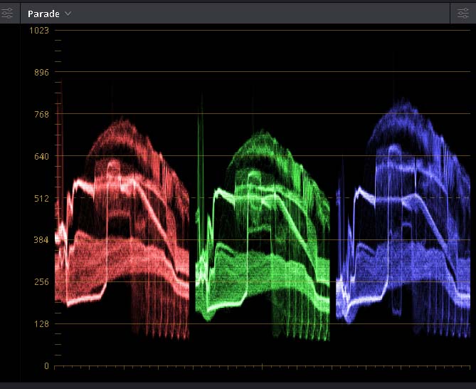

Shirozina Posted September 14, 2017 Share Posted September 14, 2017 Here is the RGB parade in Davinci Resolve after the file is imported properly for Sony internal codecs (clip attributes set to full) - you can see how far the whites in the image are away from their clipping point and how the different channels are uneven which indicates an incorrectly set WB. I played the clip on my 27" workstation monitor and can see the very slightest amount of grain - pretty amazing for an underexposed shot at this ISO! Link to comment Share on other sites More sharing options...
Ben J. Posted September 14, 2017 Author Share Posted September 14, 2017 12 hours ago, Shirozina said: Yes use the Histogram and / or Zebras to set exposure. Your WB is not set correctly as the image has a blue/magenta bias - how are you setting WB? Yes you are right, I think I changed the matrix filter (tint) on it in camera to get rid of some yellow (which would explain the blue spike) Link to comment Share on other sites More sharing options...
