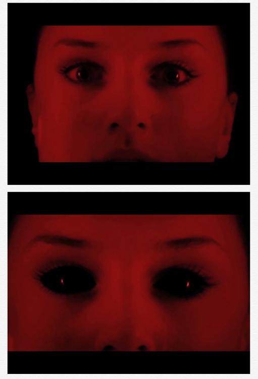

Hans Punk Posted September 17, 2017 Share Posted September 17, 2017 2 hours ago, HockeyFan12 said: Can't argue with that. Just figured something simple might be easier. Was it Dr Who by any chance? Not Dr Who this time...but a 6 part Sci-Fi comedy series that I don't think ever aired. It was totally crap, but the effects were decent ? Here is the shot I was talking about, screen capture is terrible quality though (from good old Digibeta days. The camera tracks into girls face as here body is 'possessed' by evil computer implant, transforming her eyes black by 'bleeding' black goo from the pupil. This was done the way you said, keying real highlights from eyes onto roto black shapes to mask her real eyes. This worked as her eye colour was brown and the scene was dimly lit (enabling an easy key of highlight). A similar shot years later (that I can't seem to find images from) was done with the shiny black ball method - I remember that looked way better, since that scene was lit much brighter, and the camera was much closer...plus the reflections in he real black ball plate had a load of highlight details in there that would have been extreamly difficult to replicate without going down the route of capturing a spherical reflection map - which there was no time for. It is amazing what the human eye can reflect - especially when up close. Depending on the lighting and proximity of camera, I'd say try to capture a real reflection whenever possible. But if that is not practical - tracked roto and keyed real highlights is a good method to try. kaylee 1 Link to comment Share on other sites More sharing options...
HockeyFan12 Posted September 17, 2017 Share Posted September 17, 2017 Looks good. Tbh I think you could get the same effect in 2d just with black solids and screening the speculars back in. But of course for the whites of the eyes that would be trickier–any highlights over those would be harder to extract. Anyhow, no arguing with how that looks, it looks good. kaylee 1 Link to comment Share on other sites More sharing options...
