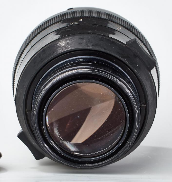

PepperJay Posted October 1, 2017 Share Posted October 1, 2017 Greetings, Anamorphic Community, I've been working on trying to restore an "as is" 36 purchase I made in a foggy haze of ebay madness earlier this year. See original listing pic below: (Those are dead bugs under the front element. Yep, dead bugs. The inner elements have what was believed to be either fungus or deteriorated glue.) After sending it out to a well-known specialist for servicing, it was returned to me with regret that it couldn't be worked on because the front focusing element was not accessible due to tightness in the threads (after the four front screws were removed). Also, the plastic ring w/ label took a little beating in the process, but I'll get to that later. However, it seems that before sending it back to me, lubricating oil was generously applied inside in the hopes of loosening up the parts, and by the time I was able to inspect it again, the lens was able to open up this far without any tools. At this point, I have only to attempt to unscrew the inner element housing (2nd from the left) in order to clean the lenses, although I'm a little nervous about alignment after the work. It's very possible I've already set myself up for some extra trial & error work because I pretty much accidentally opened up before I even realized what I was doing, let alone set some markers (or, yes, even some masking tape to protect the glass--will be rectified immediately, I promise). Anyway, I'm a sort of crossroads here. I could use my spanner wrench to get in there and do the deed myself, or send it back to the service shop to clean, lube and align for several hundred dollars. The other option, however, is to send it to Van Diemen for the $1,100 VI housing (assuming the optics are up to snuff, naturally). What hurts, though, is knowing that the VII exists for more than twice the price. If they ever sold the (what seems to be vastly improved upon) updated version for around $1,500 USD (or even via another batch purchase like Andrew Wonder's in 2014--any takers?) , I'd be in, but right now it'll come in over $2,600--a bit too rich for my blood. Another option is to go with a half-mod, at an appropriately lower price, but given the age of the current plastic housing (and the unsightliness of the damaged ring--a merely cosmetic, but still costly hit in the hypothetical future of selling my stash for recreational drugs), I'd really like to explore a full-metal body design, despite the weight increase. Also, the improved minimum focus and the shorter focus throw are a given if I'm spending anything more. I know I could file the stopper myself, but the anxiety of either worrying about it separating on me by rotating it too far on a shoot or even popping a hole and screw in the lens just seems too stress-inducing and/or ghetto for what I've already paid. BTW, no offense to anyone ghetto-rigging anything--I just have a knee-jerk reaction to this particular op on this particular class of lens. Any suggestions/comments/news on the housing front? I heard Rich was developing something a few years ago, but it seems viable options are fairly limited in this understandably niche market. The perfect scenario would be if someone could just 3-D scan the shit out of the current plastic housing parts and simply recreate it out of a far more durable material. Note: I say "simply" because I probably don't know what hell I'm talking about. :D Best to all, and thanks to everyone for your contributions past, present and future. -Jason Liszon 1 Link to comment Share on other sites More sharing options...

Hans Punk Posted October 5, 2017 Share Posted October 5, 2017 Who was the ‘well-known specialist for servicing’? - applying oil anywhere near the internals of an iscorama does not sound right at all, let alone damaging the retainer ring to gain access. Link to comment Share on other sites More sharing options...

dhessel Posted October 5, 2017 Share Posted October 5, 2017 You could also send it to Bernie ant Super16 Inc if you are in the US. He services these and will look at it for free and let you know how much it costs to fix if it can be fixed. This iscorama is basically like a normal anamorphic projector lens set to infinity focus with a variable strength diopter in front. The rounded front element on the main optical block can be removed without messsing up the alignment, if that gets you far enough in to clean it then you maybe able to to that yourselft depending on what is actually on the lens. I believe the next element back after that one is the front anamorphic element, the alignment of this elment to the rear element is critical and very sensitive. If you remove it it has to go back exectly how it was before otherwise the lens will loose sharpness.Once removed you should be as far in as you would ever need to clean out as much as you can. The focus of the anamorphic block is probably set by the rear element, it is my own policy to never remove or even loosen the rear element of any lens. Without a collimator you will never get it set right again. Having not opened one of these before I cannot say for sure but I have serviced an Iscorama 54 years ago and I suspect they are very similar. Link to comment Share on other sites More sharing options...

Hans Punk Posted October 5, 2017 Share Posted October 5, 2017 @PepperJay If it indeed was the lovable Irish man then it sounds like he tried everything to get that lens open (and technically succeeded) - must have been seized really bad to resort to those methods. He sure knows what he’s doing, probably the best/most experienced lens tech still around for such work. Now you have the lens opened, he will properly be able to do his magic (if the optics are not a total right-off that is). If you unsure about going any further yourself, he’s the guy to call again IMHO. Once optics are cleaned and alignment all ship-shape, you could then invest in the really impressive ‘proxiscope’ front rehousing mod that @redimp has devised...a metal replacement front for your pre-36 with integrated gear that has close focus hard stops built in. It is non-destructive and requires no permanent modification to your lens. Advantage is that is a heck of a lot lighter than the VD full rehousing and since it is an easy DIY kit - it won’t require you to send your lens away and wait hundreds of days for it’s return. Link to comment Share on other sites More sharing options...

PepperJay Posted October 6, 2017 Author Share Posted October 6, 2017 9 hours ago, dhessel said: You could also send it to Bernie ant Super16 Inc if you are in the US. He services these and will look at it for free and let you know how much it costs to fix if it can be fixed. This iscorama is basically like a normal anamorphic projector lens set to infinity focus with a variable strength diopter in front. The rounded front element on the main optical block can be removed without messsing up the alignment, if that gets you far enough in to clean it then you maybe able to to that yourselft depending on what is actually on the lens. I believe the next element back after that one is the front anamorphic element, the alignment of this elment to the rear element is critical and very sensitive. If you remove it it has to go back exectly how it was before otherwise the lens will loose sharpness.Once removed you should be as far in as you would ever need to clean out as much as you can. The focus of the anamorphic block is probably set by the rear element, it is my own policy to never remove or even loosen the rear element of any lens. Without a collimator you will never get it set right again. Having not opened one of these before I cannot say for sure but I have serviced an Iscorama 54 years ago and I suspect they are very similar. Yes, dhessel, based upon all the praise I've read across these forums about Bernie, he was natural first choice to try and save what I hoped was a perfectly salvageable lens in need of a little expertise and/or love. From what I heard, unfortunately, after hours of negotiating with it and even damaging the the ring in the process of unscrewing it, he just wasn't able to get the front focusing element loose, and decided to send it back rather than risk damaging any other parts of the lens. However, before packing it up, he flushed the inner workings (including the main elements in the rear) with liberal amounts of oil. A few days later I received it back, and before I knew it, the lens opened up where the main cylinders overlap. I immediately told him about it and he figured the oil did its job, offering to continue on the work if I wanted to send it back should I be worried about attempting to myself. I told him I might do so, along with a couple of other lenses that could use some help. So that's where I left it with Bernie. From my (albeit limited) experience thus far over email and phone, they are responsive, fair and very nice people. Not at all regretting sending it to them in the first place. Which brings me to... 6 hours ago, Tito Ferradans said: wasn't that what he just implied? Yeah, Tito, I was worried it was a little too on-the-nose, but I also don't want to be coy and just PM inquiries. I feel that as a noob, despite our lack experience in this field, our experiences can still be of use to all. Anyway, regarding Bernie, I certainly don't wish to be the one to tarnish his reputation; God knows how little hope there is left in the world, particularly in people. Since starting this thread, though, I've written to Van Diemen and inquired about what their housing job entails, and I was immediately responded to and told that should my unit pass muster (optics & mechanics), they'd be happy to include any cleaning and aligning in the process. Considering I was expecting to pay about 25% of that just for the cleaning, I'm inclined to pay the full amount and insure that not only does my lens not spontaneously pop apart at the center, but that it'll be well-housed and modded adequately for real-world use (granted, not as well as the VII, but NASA I certainly ain't). And it's mainly because of how easily the two halves are easily disassembled now that... 5 hours ago, Hans Punk said: @PepperJay If it indeed was the lovable Irish man then it sounds like he tried everything to get that lens open (and technically succeeded) - must have been seized really bad to resort to those methods. He sure knows what he’s doing, probably the best/most experienced lens tech still around for such work. Now you have the lens opened, he will properly be able to do his magic (if the optics are not a total right-off that is). If you unsure about going any further yourself, he’s the guy to call again IMHO. Once optics are cleaned and alignment all ship-shape, you could then invest in the really impressive ‘proxiscope’ front rehousing mod that @redimp has devised...a metal replacement front for your pre-36 with integrated gear that has close focus hard stops built in. It is non-destructive and requires no permanent modification to your lens. Advantage is that is a heck of a lot lighter than the VD full rehousing and since it is an easy DIY kit - it won’t require you to send your lens away and wait hundreds of days for it’s return. I hesitate to contact Max again about the Proxiscope at this stage. I like his design and particularly his price point, but that and the cleaning would already run me 2/3rd's of the VD job. Thanks, Hans and Tony, for your votes of confidence in Bernie. As per my phone conversation with him, his main consideration at the time was trying his best to open the lens for repair with as little damage as possible, and I don't hold the ring damage at all against him. If I ever had to sell it, fair or not, cosmetically it's a mess, but for now it's not that big of a deal that I can't give Bernie another go should he still be accepting requests. In fact, the best compromise I've come up with is to ship him my pair of Bolex-Möllers (19 & 32) on the same day I send the Isco to VD. Everyone gets their beak wet and I'd be the proud parent of some very nice glass. Any opinions to the contrary? Tony, I'm honored that you'd reply to my post considering your standing in the community, but I hope you understand that whatever falling out you seem to have had with the Van Diemen company, they only real complaint I've been able to research has to do with working time frames, and not with actual quality of work, despite the high price. Maybe I have to learn this lesson myself (wouldn't be the first--definitely not the last), but with all the considerations (cleaning, functionality, stability) regarding this particular lens, it seems like VD might be the best route to go. Naturally, I'll bitch to high heaven should it prove to be a bad choice, at which point you are more than welcome to rub it in ;). And as I said above, I'd still love to give Bernie my business, but if any vintage anamorphic deserves the silver tuna treatment, I think something like this Isco is right there. You and a handful of other members are an awesome wealth of experience, ingenuity, and inspiration, and maybe it's none of my business, but I can only hope that one day I'll see the fruits of whatever work you've already put in towards a working optic in the marketplace. The clamps are awesome, but it sounds like you've got some old scores to settle. I'd just love to be there when you do! I greatly appreciate all the input so far, and any other opinions are still most welcome. For any future developers out there, there's still a big hole to be filled in terms of an update to the Iscorama design, and considering the patent doesn't sound like an issue any more, I wouldn't be surprised to one day see a Kickstarter campaign with an oddly familiar profile... -Jason Link to comment Share on other sites More sharing options...
redimp Posted October 6, 2017 Share Posted October 6, 2017 11 hours ago, Hans Punk said: Once optics are cleaned and alignment all ship-shape, you could then invest in the really impressive ‘proxiscope’ front rehousing mod that @redimp has devised...a metal replacement front for your pre-36 with integrated gear that has close focus hard stops built in. It is non-destructive and requires no permanent modification to your lens. Advantage is that is a heck of a lot lighter than the VD full rehousing and since it is an easy DIY kit - it won’t require you to send your lens away and wait hundreds of days for it’s return. Thanks for mentioning me, actually @PepperJay already contacted me about this one. Seeing bugs inside this lens gave me chills, poor 'rama Link to comment Share on other sites More sharing options...
PepperJay Posted October 7, 2017 Author Share Posted October 7, 2017 17 hours ago, redimp said: Thanks for mentioning me, actually @PepperJay already contacted me about this one. Seeing bugs inside this lens gave me chills, poor 'rama Hey, @redimp, I'm sorry for not getting back to you directly. When my lens came back and just twisted open, I figured it probably needed a complete housing to keep it together. As it is, I still wouldn't be surprised if Christopher at VD sends it back due to hopeless optics (that chalky looking fungus between the inner elements). But the good news is I was able to wipe the bugs off of the back of the focusing glass. Yay. While I have you on the horn, I hope you've given some serious consideration towards a custom rear half that attaches to the front you've already developed. The weight and price point you're offering thus far has tantalizing potential and would serve as a great alternative to the limited housing choices out there. Speaking purely out of ignorance for the task, I guess the reverse engineering part wouldn't be nearly as complicated as designing anything from a functioning outer housing to full replacement of all the plastic parts. But one can dream. Anyway, thanks again for your help and encouragement earlier! Link to comment Share on other sites More sharing options...
redimp Posted October 7, 2017 Share Posted October 7, 2017 5 hours ago, PepperJay said: Hey, @redimp, I'm sorry for not getting back to you directly. When my lens came back and just twisted open, I figured it probably needed a complete housing to keep it together. As it is, I still wouldn't be surprised if Christopher at VD sends it back due to hopeless optics (that chalky looking fungus between the inner elements). But the good news is I was able to wipe the bugs off of the back of the focusing glass. Yay. While I have you on the horn, I hope you've given some serious consideration towards a custom rear half that attaches to the front you've already developed. The weight and price point you're offering thus far has tantalizing potential and would serve as a great alternative to the limited housing choices out there. Speaking purely out of ignorance for the task, I guess the reverse engineering part wouldn't be nearly as complicated as designing anything from a functioning outer housing to full replacement of all the plastic parts. But one can dream. Anyway, thanks again for your help and encouragement earlier! The full body prototype is in production already, but it's far down in the queue, not a top priority. Also the price is yet unknown, though it will definitely less then VD. PepperJay 1 Link to comment Share on other sites More sharing options...

Romano_Soprano Posted March 28, 2019 Share Posted March 28, 2019 @PepperJay What is the ending of your story? Where you able to restore the lens? I got an iscorama 36 with pretty bad separation. Is it possible to fix it? Link to comment Share on other sites More sharing options...
jaquet Posted March 30, 2019 Share Posted March 30, 2019 @Romano. The last glass elements are cemented for eternity inside the metal housing. I asked VD for polishing them but they can't … There are even lens elements glued together with organic glue which lets fungus grow. The separation in the picture looks like this glue … Link to comment Share on other sites More sharing options...
Romano_Soprano Posted April 1, 2019 Share Posted April 1, 2019 On 3/30/2019 at 2:51 PM, jaquet said: @Romano. The last glass elements are cemented for eternity inside the metal housing. I asked VD for polishing them but they can't … There are even lens elements glued together with organic glue which lets fungus grow. The separation in the picture looks like this glue … Will try to expose to direct sun and UV light. Will use the lens as-is. Thanks for info Link to comment Share on other sites More sharing options...
mirekti Posted April 5, 2019 Share Posted April 5, 2019 On 4/1/2019 at 11:04 AM, Romano_Soprano said: Will try to expose to direct sun and UV light. Will use the lens as-is. Thanks for info While it looks bad if it doesn’t spread towards the center you should be fine. I was surprised how small the circle is used, I think it was less than 10mm radius from centre point. Link to comment Share on other sites More sharing options...
