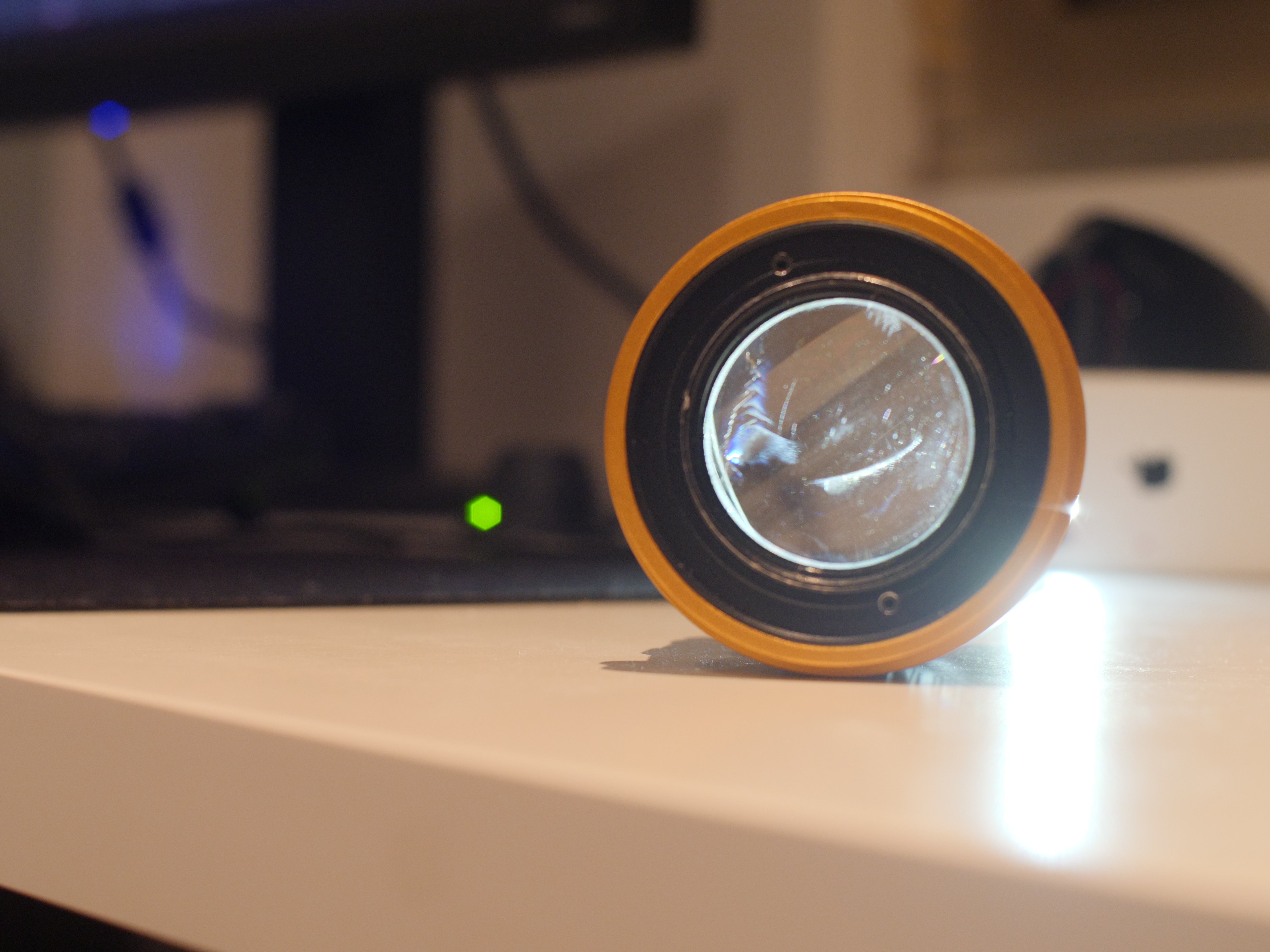

Exo7 Posted October 26, 2017 Author Share Posted October 26, 2017 Ok, here is a quick photo, it makes some kind of rainbow when the light pass through it. I think it's balsam separation.. Do you think it will be worse in daylight? I've notice that the smear is only visible on the footage when I'm focusing to infinity. Link to comment Share on other sites More sharing options...

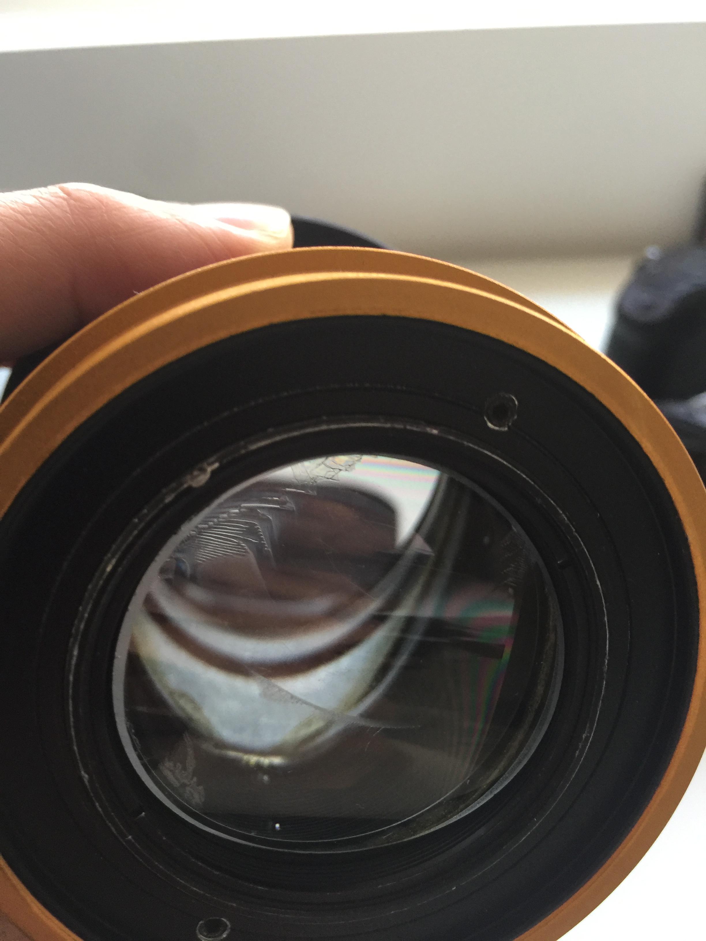

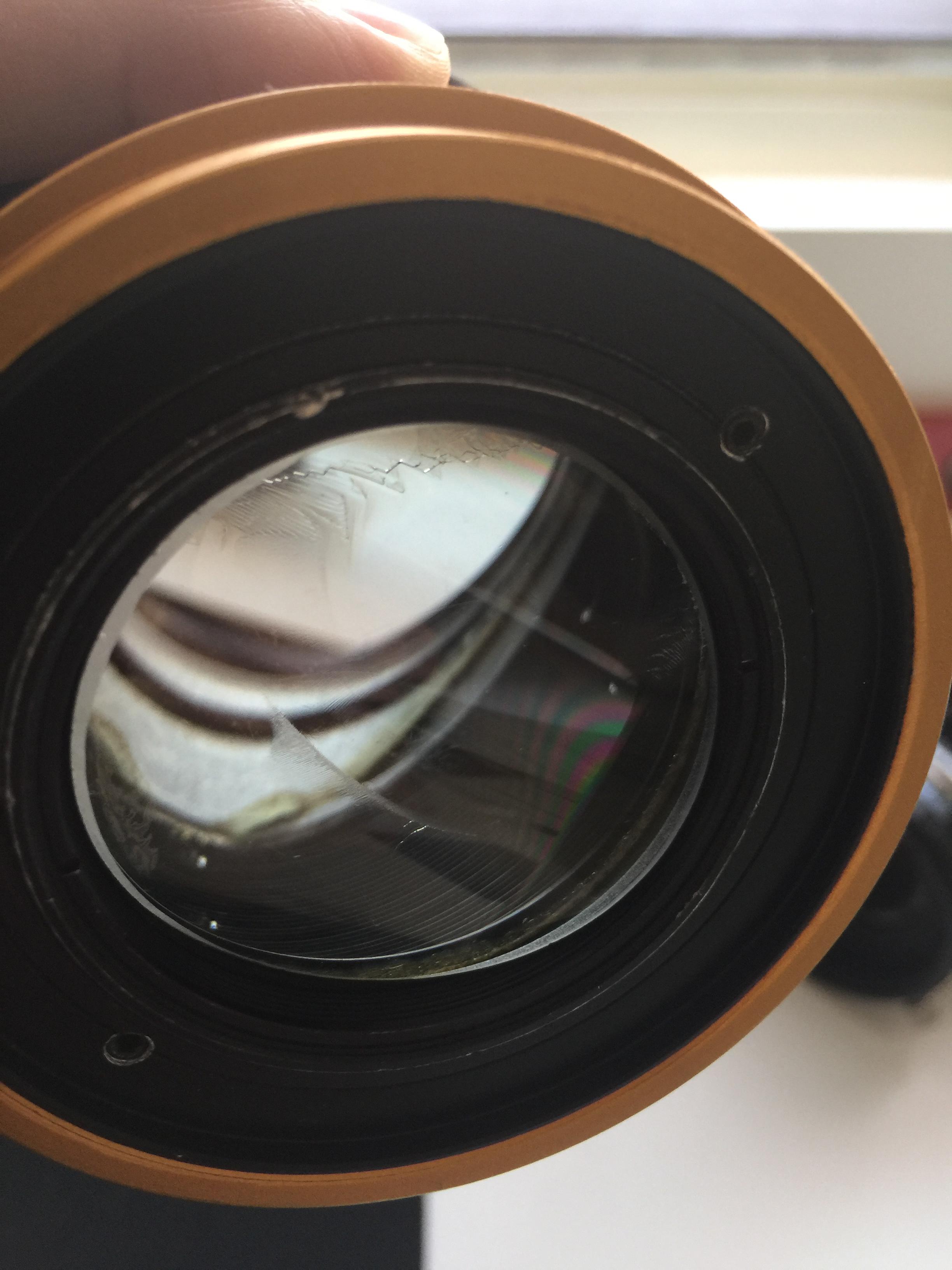

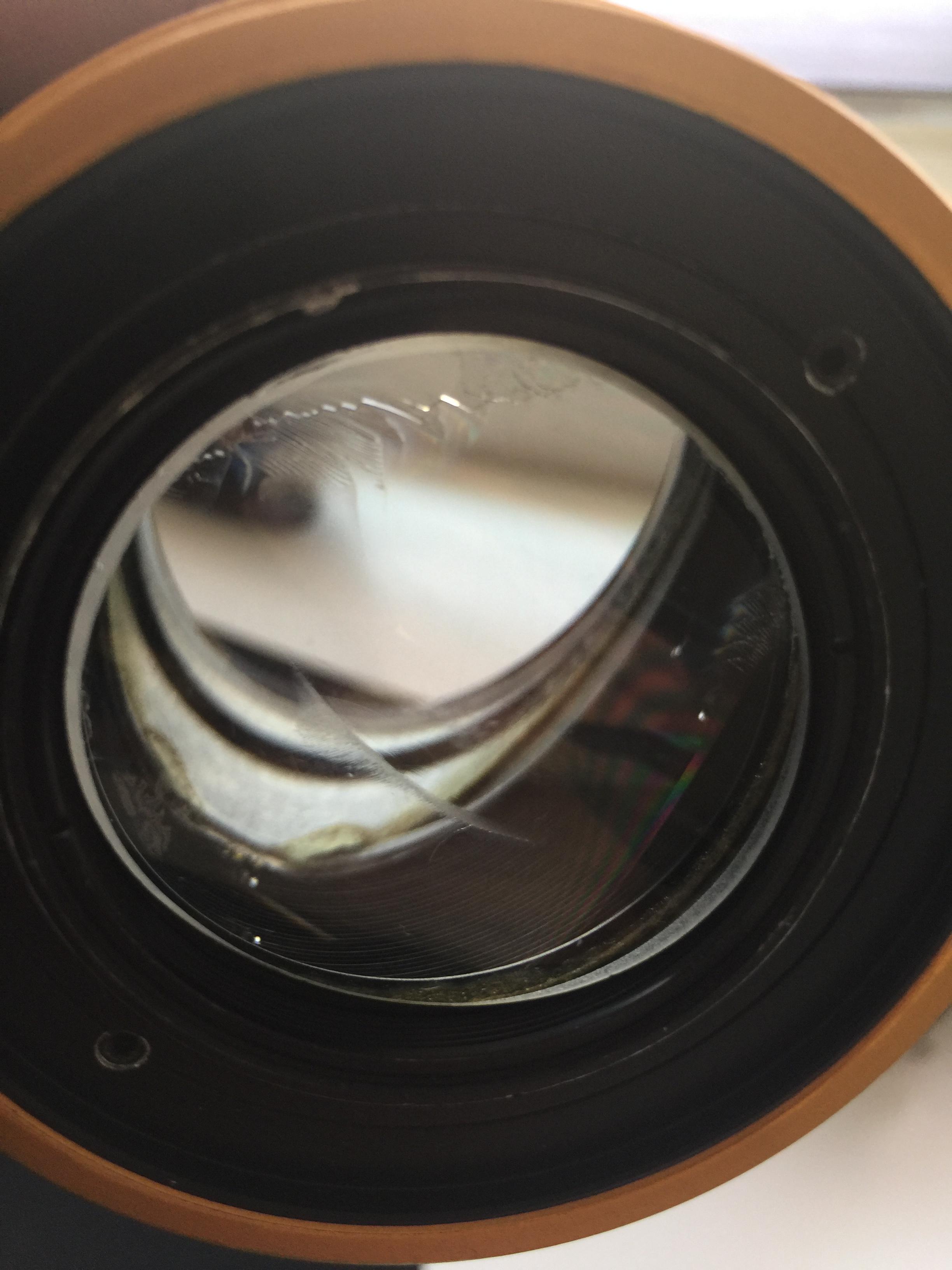

Exo7 Posted October 30, 2017 Author Share Posted October 30, 2017 Maybe it s more obvious here : Link to comment Share on other sites More sharing options...
dhessel Posted October 31, 2017 Share Posted October 31, 2017 I can't imagine how it might happen but it looks like micro cracks inside the lens. I have had a lens that I dropped in the past and it got a circular chip in the glass. It was a large chip that didn't separate but left the same rainbow like pattern you are seeing when viewed at the correct angle. If has large chips in the glass that have moved a tiny bit those areas can be softer which looks to me like what you are seeing in your footage. If the lens came arrived that way and was not listed as being damaged in the discription I would return it, if those are chips there is nothing you can do to fix it. Link to comment Share on other sites More sharing options...
tony wilson Posted October 31, 2017 Share Posted October 31, 2017 itsa whatta yer calling delaminations innit itsa what yer happenin when you droppa der ananorfink lens when yer usin a cheaps campa clampa it drops or knocks der metal reverbs true der tubei housing init it sens shocka wave inder glasses matrix a delaminating occurins in der complex cemented doublets init it impact seperation damages from poor owner abusings slapping banging opticals violent likes init like harvey weistein knockin on yer hotel doors at night creatin waves of tesla ocillations vibrations it looks bad doctor bones maybe terminulls ask for a refunds quick likes Grimor 1 Link to comment Share on other sites More sharing options...
PepperJay Posted October 31, 2017 Share Posted October 31, 2017 I agree with sending it back if the option is still there. If you got a deal too good to abandon (namely free), mark the positions and open it up yourself, but given the prior opening signs to the rear, my amateur opinion is that it is indeed a separation between elements and in need of a new cementing (and probably not worth the price). Link to comment Share on other sites More sharing options...
