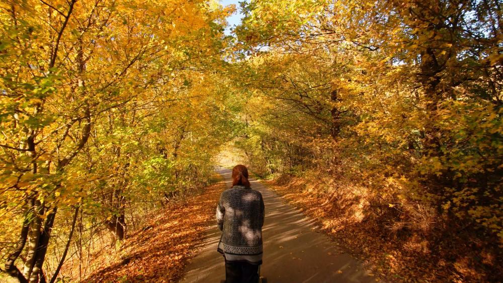

Pavel Mašek Posted November 12, 2017 Share Posted November 12, 2017 In static scenes you will not see much difference - maybe only in shadows details. But I always shoot 4k/30p in 160Mbit: I remember one situation in past when I have recorded video with my NX1 (withou any hack that time) was poiting on building against sun (so building was in shadows), there were trees, waving branches in the wind, moving grass, chaning brightness ... that image was full of macroblocking and absolutely awful to me. However I saw also macroblocking on the sky in static landscape shots too so I will never return back to 80Mbit. Below are frame grabs from 160Mbit footage - all done from gimbal in movement (so there is also some motion blur), no grading - just "converted" from 0-255 to 16-235 in Premiere (I am Ok with 8bit colors ;-)), Vivid settings with some tweaks, MBL 0. I have not tried 80Mbit but details would not be so detailed and there would be much more macroblocking - I think image would fall apart completely without hack. You will see macroblocking even here (face, road ) if you will take closer look (I should push it at least to 180Mbit but I was worried about frame drops). If you plan share footage on YT then it is completely different story kidzrevil 1 Link to comment Share on other sites More sharing options...
